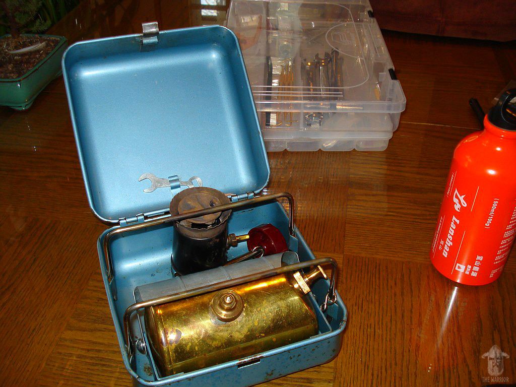

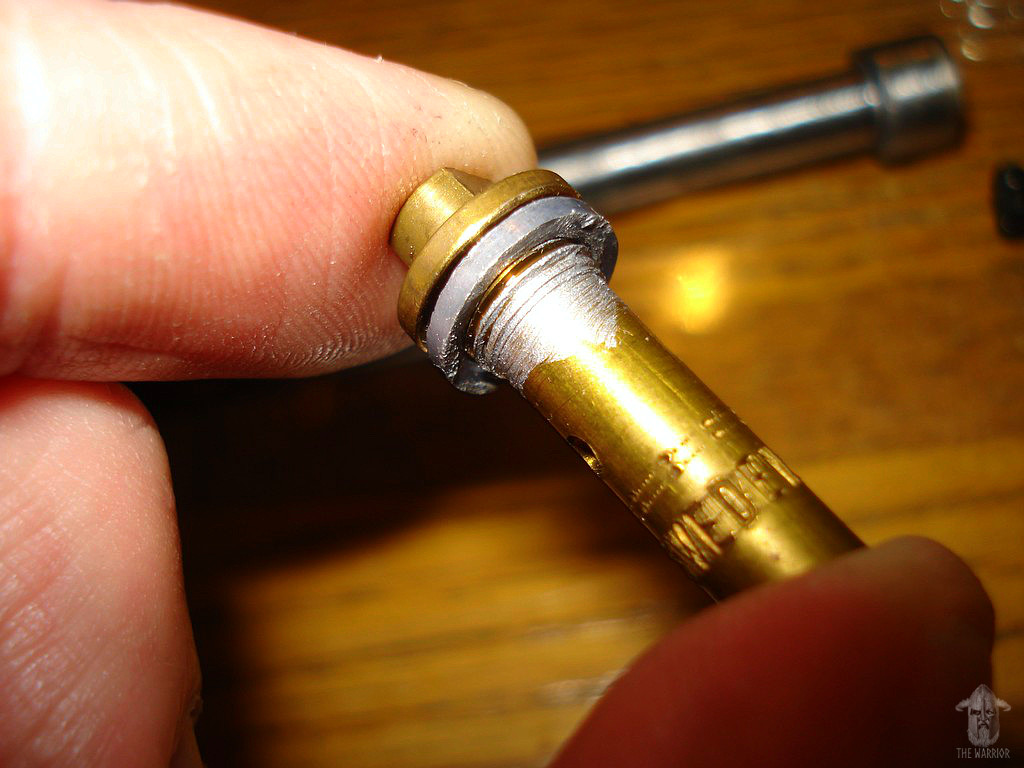

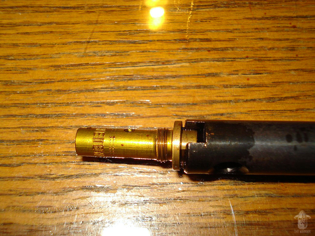

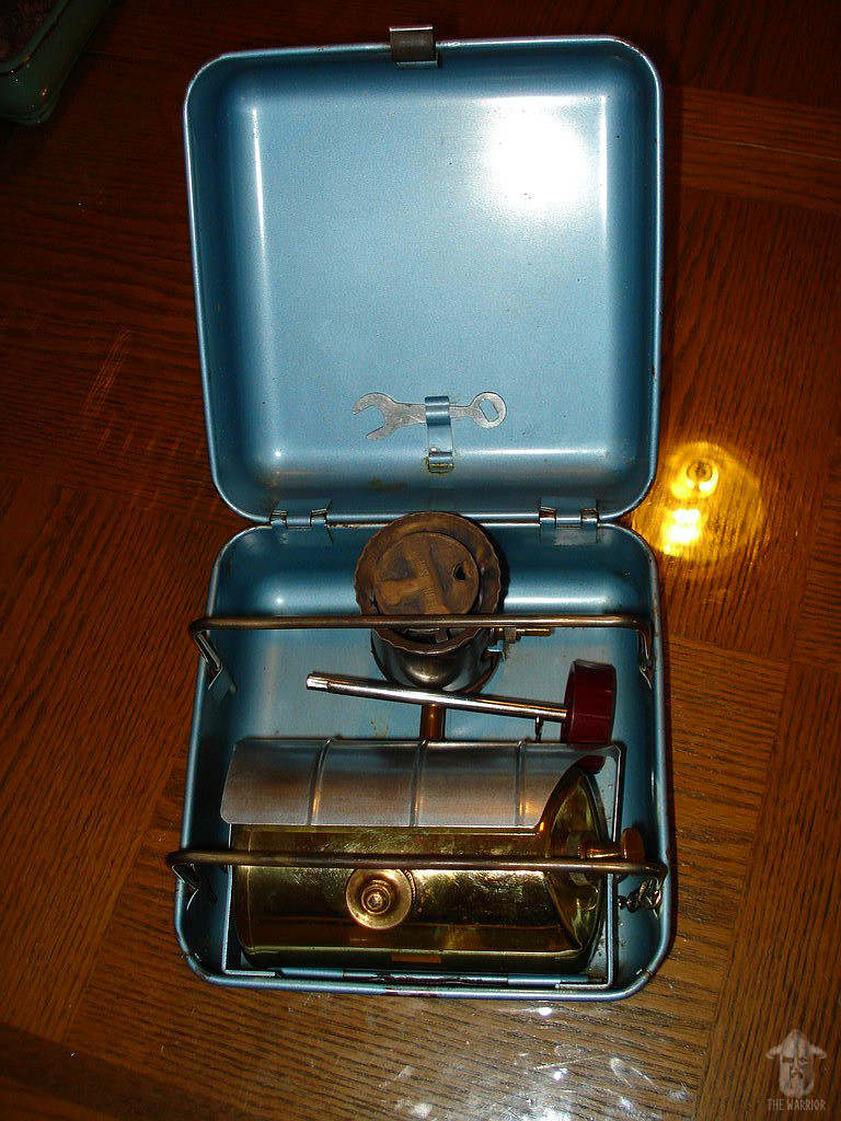

It’s sure nice you’re able the find the parts you need for those stovesFettled my Optimus 111B tonight. Cleaned it up a bit, but it was already in decent shape:

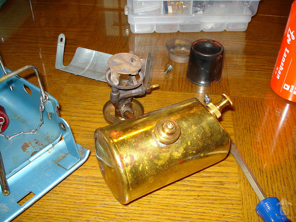

Removed the tank/burner:

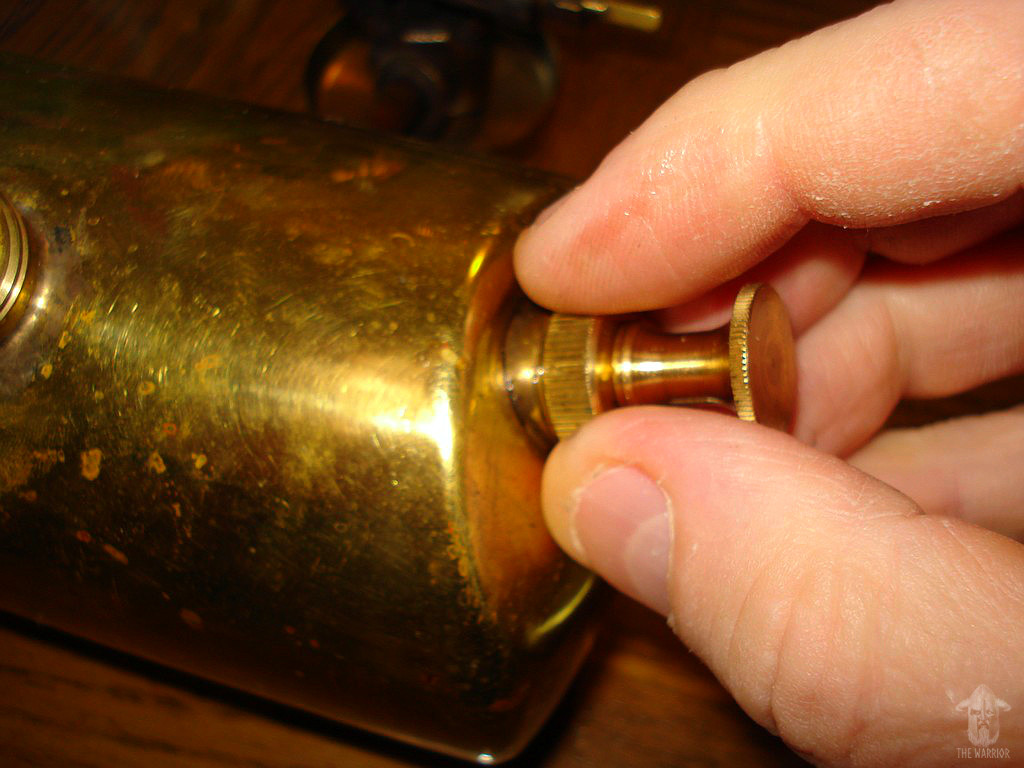

Remove the pump:

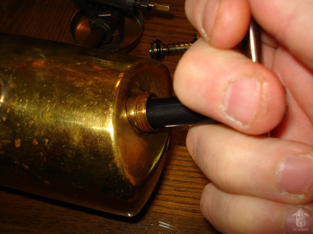

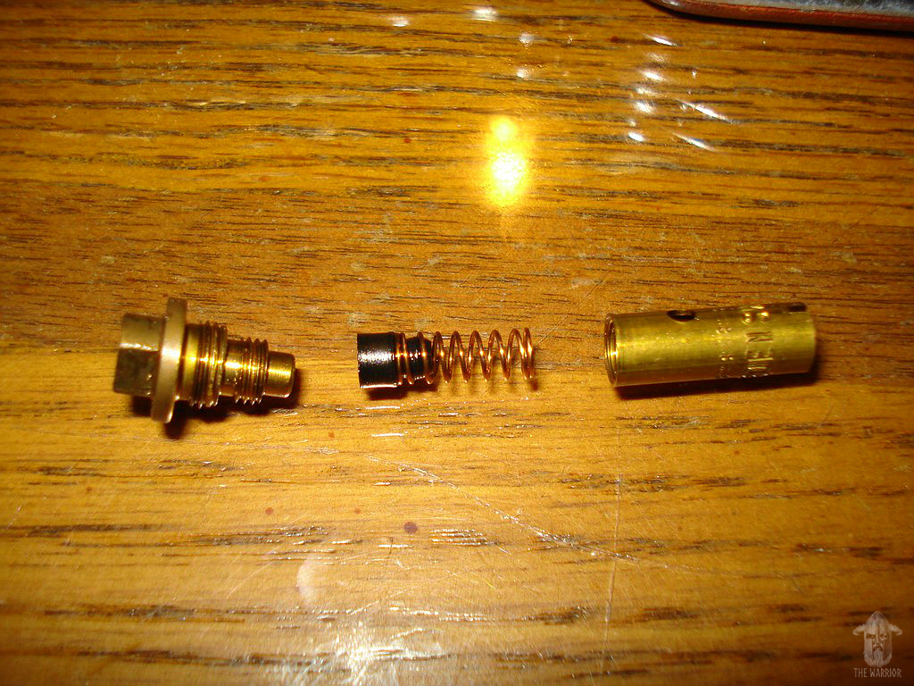

Use the NRV tool to remove the NRV:

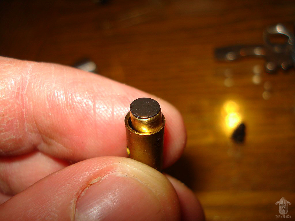

The NRV:
Apart. The little black piece, called a pip, gets brittle, and lets fuel in the pump tube, which will ignite, and create a blazing inferno:
New installed:
Back together with new lead washer, and anti-seize grease applied:

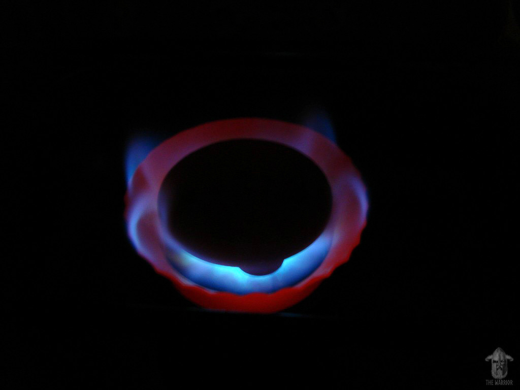

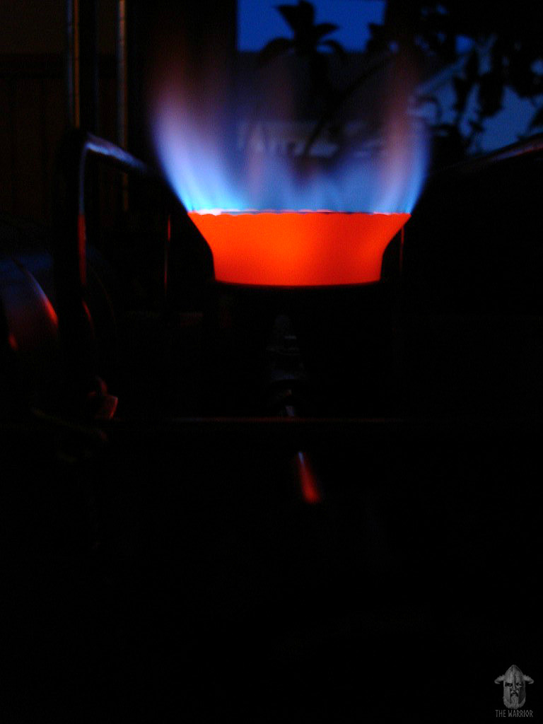

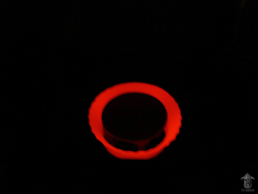

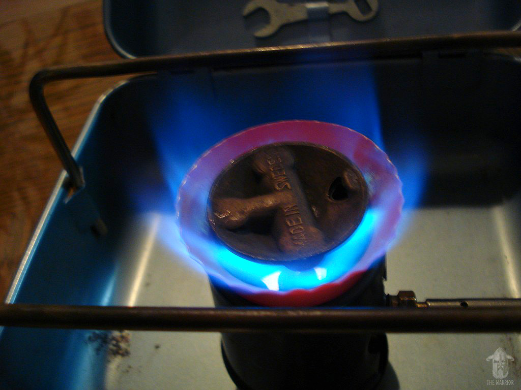

Reinstalled it, changed out the fuel cap seal, polished it very slightly, put it back together, and primed it up:

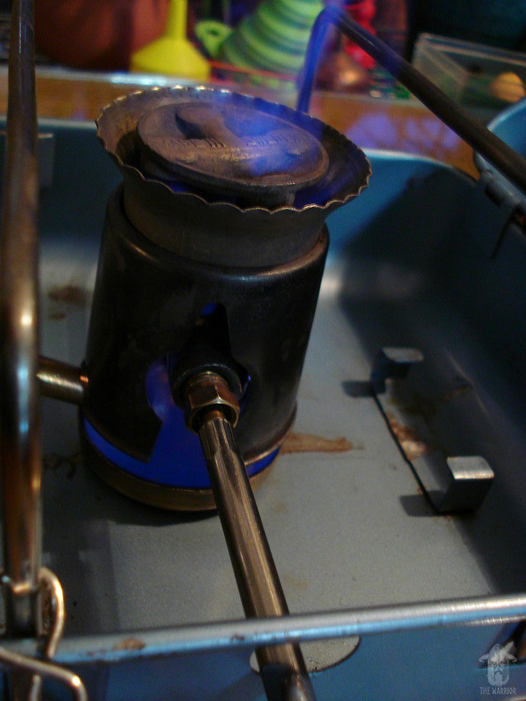

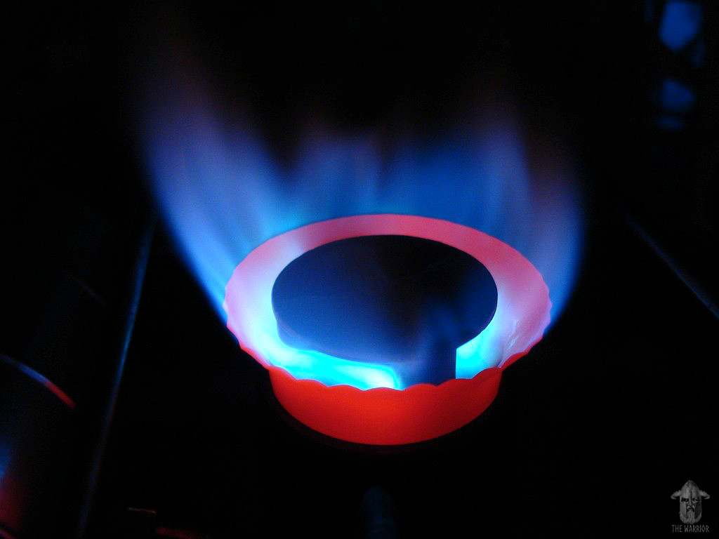

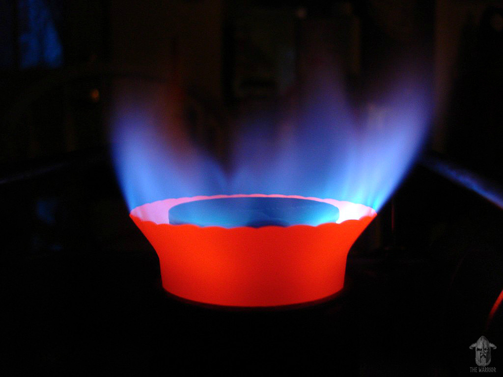

Success:
About as low a flame you can get, without it going out:
Took a shot immediately after extinguishing. Slightly blurry, but still a decent photo:

I could watch video of stoves being rebuilt, without voice, just watching the work being done. There's a guy I watch camping in storms, he doesn't talk, he just sets up his gear and builds fire with the sound of rain from the storm. Very relaxing.Fettled my Optimus 111B tonight. Cleaned it up a bit, but it was already in decent shape:
Remove the pump:
The NRV:

Success:
