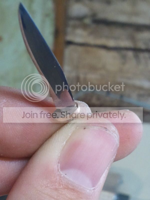

I was looking at some old photos and ran across these. The first is a close-up of a knife. I would say that you could not tell the size from the photo. The second shows how small the knife actually is.

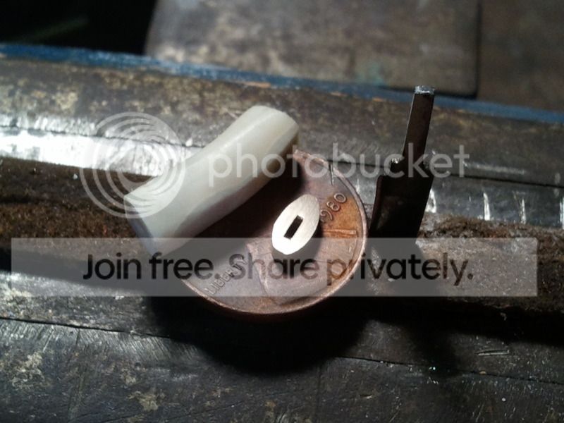

Well I decided to shelf the fine silver guard until I get better at working with it. I started one in bronze today, but it is only single sided, I don't know yet if I like it or not. Feel free to comment on it, I still have some bronze in the same thickness so I can make another one real quick. Started fitting the handle as well, its walrus ivory, still oversize.

Got the guard sanded for final fitment, brought the handle down a more workable size for finishing.

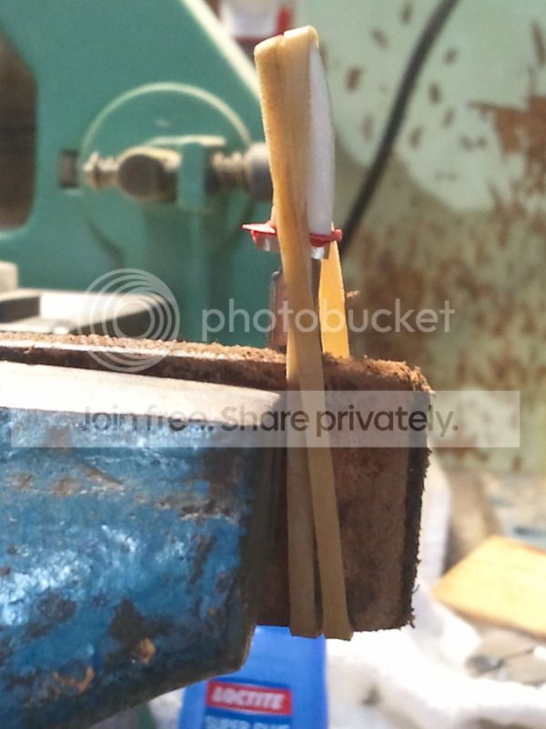

Fitted the guard, it is friction fit very tight, I had to hammer it on and the tang hole was tapered to allow room for super glue.

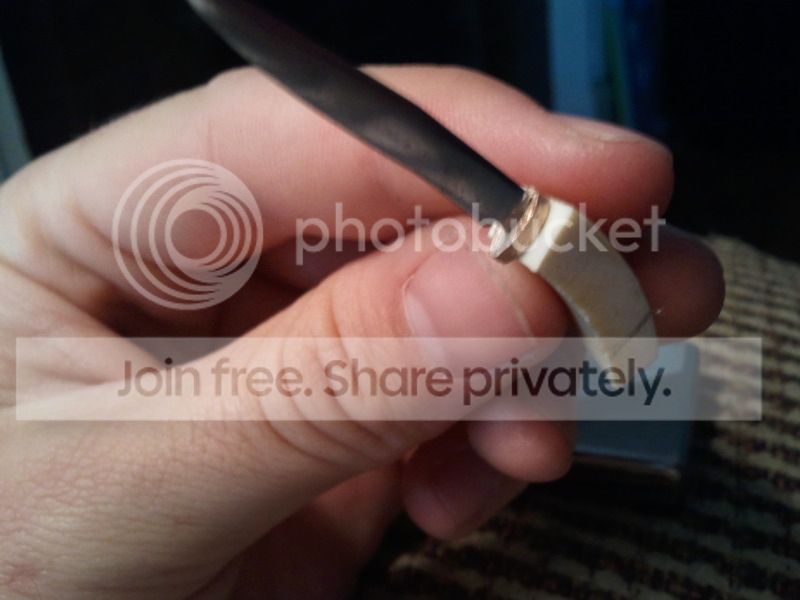

Got the handl assembly glued up. I decided to add a bit of spacer between the guard and ivory for just a little bit of color and because the superglue can leave a small gap. Still debating if I want to do a pommel or butt cap on this one.
