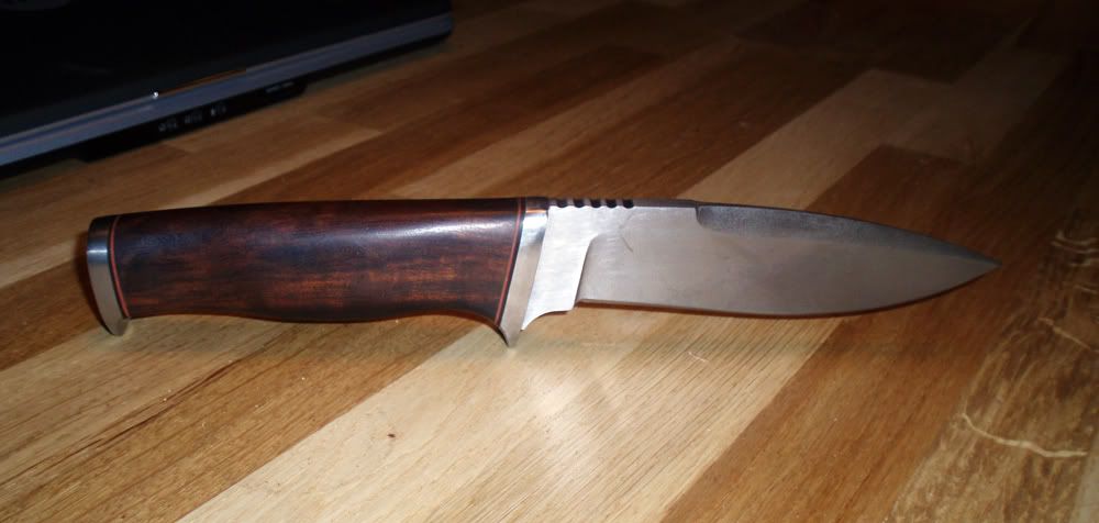

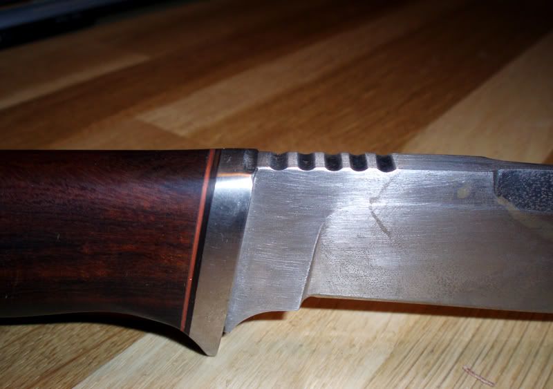

Right now they look almost like the jimping on my Strider AR, but the holes ar closer together. For that kind of jimping I think that the width of the cutouts should be the same as the spaces inbetween them. Right now the holes seem too big and too close together which will be not so nice for the thumb..
I also think that making the holes as small as possible would add in comfort..
my 0.02 eurocts
It would be nice if the jimping worked with a firesteel (or only the part between jimping and scales), and the rest of the spine rounded to go easy on the thumb and the baton..
edit:
Made some quick pics of a Toni Oostendorp (Eastvillage knives) custom which has some very effective jimpings.
They are not as deep, but very effective..

I can have the jimping go less deep...I do like that idea.
