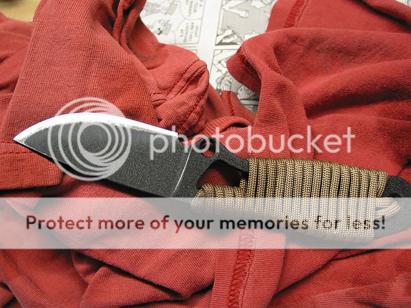

On-line class Edge re-profile/convex your Busse.
was going to use a scrapper LE but after I started, I discovered that the tip was bent. . .

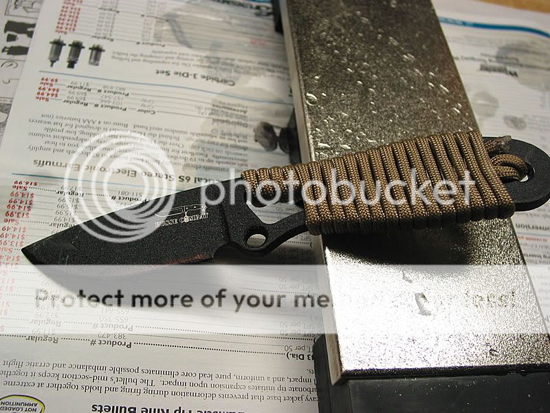

So I inked up my Skeleton Warden.
After a little while:

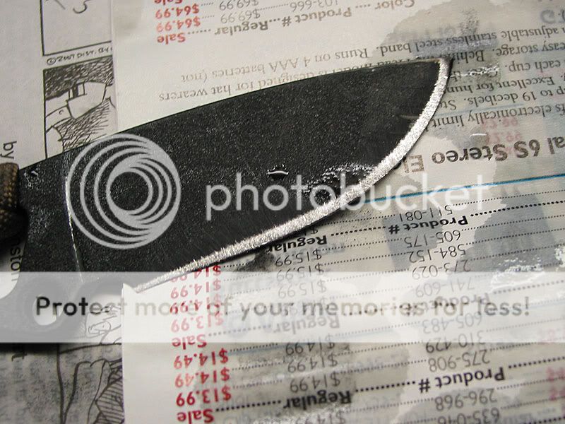

And finally:
Looks kind of uneven, and I am not sure about raising any burr. My technique sucks I think.
Nope thats look better than anyones so far. Its ok that it looks like hell right now. I am telling yeah the sandpaper is gonna smooth away a multitude of sins.
I notice that you may have rounded the tip a little. Not good But DON"T worry that is easy to fix. Lay the spine of the knife down on the stone and pull it towards you. This will grind the spine down into the edge and sharpen tip back up.
RF your knife is gonna be fine and you are really getting the swing of this. Look how closely your picture matchs what you should see from my first diagram.
Now keep going and move to a finer stone to begin to clean up the big gouges. Resist the desire to begin to elevate the knife angle to get the stone on the edge faster! That always happens when you get bored or tired.
This is going great guys and are going to get some GREAT results!
I think the tip is fine, it is just stuck in the t-shirt :thumbup:

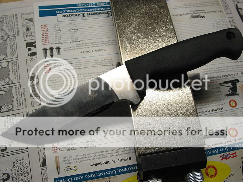

Ok, I got my supplies on Friday. I got a stone holder and 3 diasharps. I didn't get the corian block so instead I glued some 8-10oz. leather to a 2x4 and I'll just wrap the sandpaper around it:
I decided to use one of my new blender wardens for two reasons--it didn't come very sharp from the shop, and I want to thin the edge to make it a nice weighty slicer. I put the extra extra coarse stone in the holder:
Note the light reflecting off the edge bevel here. Say bye-bye!
I put some water on the stone (and while working I would occasionally spread more water on the stone to wipe off the swarf and keep it wet) and started grinding on the logo side.
I stopped after a few passes to take a look:
I was pleased with what I saw - the shoulder of the primary/secondary bevel is coming down nicely.
After what seemed like hours, but was probably more like 20-30 minutes, I finished the first side as evidenced by a tiny wire edge on the opposite side of the edge. Here's the first side done:
The second side went a lot faster, or at least it seemed to! Here it is done:
I tried to show the wire edge I ended up with on the side I ground first; you can see the light reflecting off it by the tip and on the belly:

Holy Crap MileyMoto! Way to go!! You dug deep man. That is almost flat to the blade. That thing is gonna SLICE Baby!! After you knock some of the big scratches out with a less course stone, on yours gets some sandpaper like 320 grit or so and work the entire blade flats for a while. It will be worth the extra effort. Yours is gonna come out great!!
Also..I have to mention..... that is a GREAT Leather block.... Having it up off the table is going to make it real easy to use.
