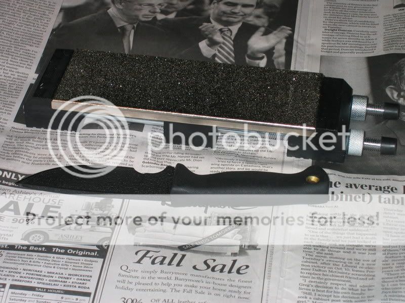

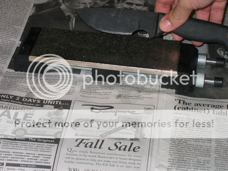

A look at my set up

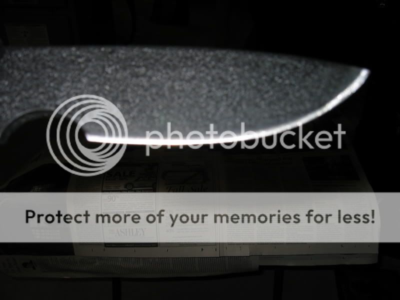

And the blade before with a sharpie on it.

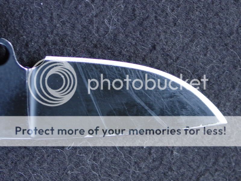

After some use with the XX diamond stone

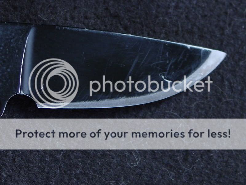

And what my Howling rat looks like now.
Well The xx course stone removes metal pretty fast. It did not take me to long to get to the last picture, I would say about 5-8 min per side. I found the hardest part was trying to thin down the edge toward the tip. Also this was the first time that I have used bench stones to sharpen a blade and over all I think it went fairly well.

A little hard to tell from the focus but it looks good like you have a nice bevel formed all along the edge and those things do get thick out at the front don't they? Did you notice you had to lift the handle a LOT to get the bevel to look even out by the tip? This means that you have a blunter bevel out by the tip. This is OK if that is the result you want. Good job man.
The next step is just to refine that course edge on a smoother stone. Keep going until there are no scratches left from the course stone and anew finer burr has formed from both sides... You did feel for a burr all along the edge right?
yep by the tip i had to lift the hand "alot". I still think i want to try and thin it down more by the tip.
I did feel the bur along the edge but toward the tip it became harder to feel.
