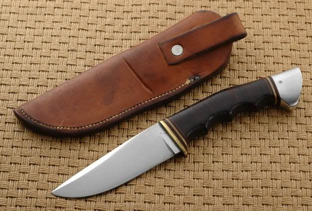

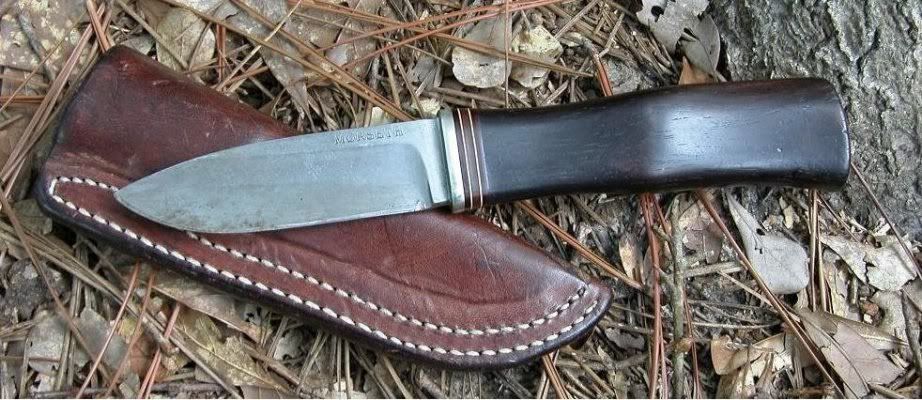

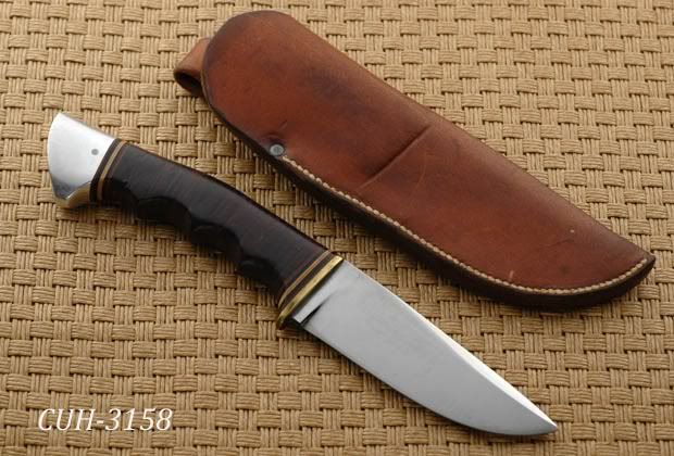

I'm glad to see this thread has brought a good discussion. Thanks to all. A few examples of related things, and ricasso types. Some variations...
Ed Fowler photos (Knife Talk)
Adventure knife
From Harry Matthews (Morseth)
Bob Loveless

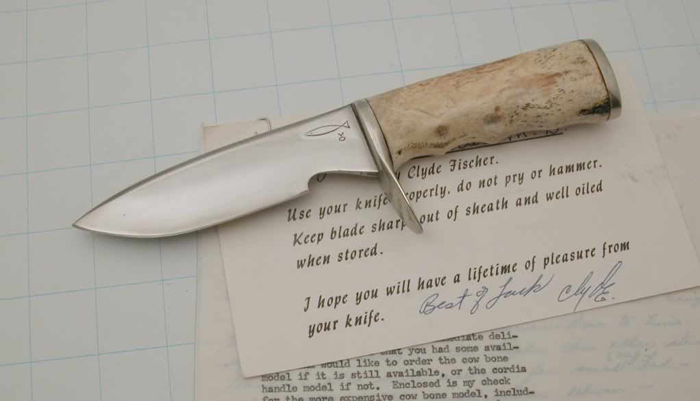

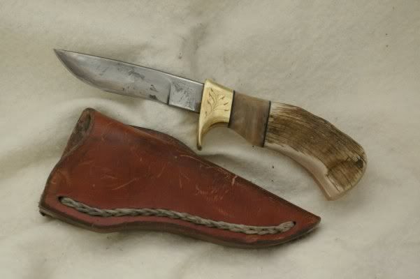

To me, the ricasso on this old Clyde Fischer knife has a nice stylistic appeal, but i wonder if it would act as a "hook" in some uses? It does look a little scary for finger on the choil holds.
I was told that it was supposed to act as hook for coffee pots and dutch oven lids on campfires, as Clyde built his knives for cowboys.
