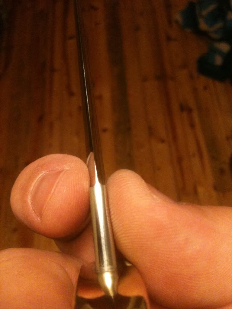

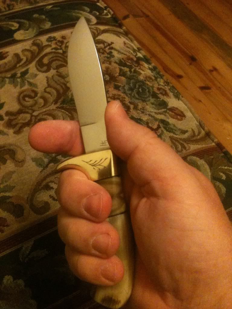

Here are a few photos of a small knife. Ricasso isnt as long, still works comfortably. Knife is drawfed by my hand. Even gripping down at ricasso, and moving my finger around i have no danger to cut myself. i have to work for the slightest pinch.
David
That's impressive David, considering you are a whisker away from cutting yourself without moving the knife or applying any force to the blade whatsoever. You are a skilled cutter indeed!
It's hard to say from the photo, but that unsharpened portion of the blade doesn't look to be any more than about 1/8" in length - is that close? Am I also correct in guessing that your finger is already using up most or all of this safety / warning area as shown in the photo?

Roger,
here is a gripping photo.
As you'll note, yes my finger is near the sharpened area, and might look a whisker away from being cut, but since the focus of pressure of my finger rests against the bulk of the guard there is still not sufficient area that would cause the edge to dig in and cut. As i said, really bearing down.. This is just an extreme example-
With that said, i would always attempt common sense.. I
