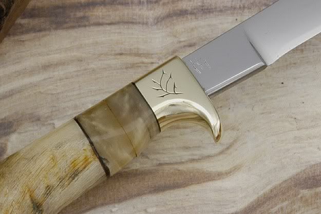

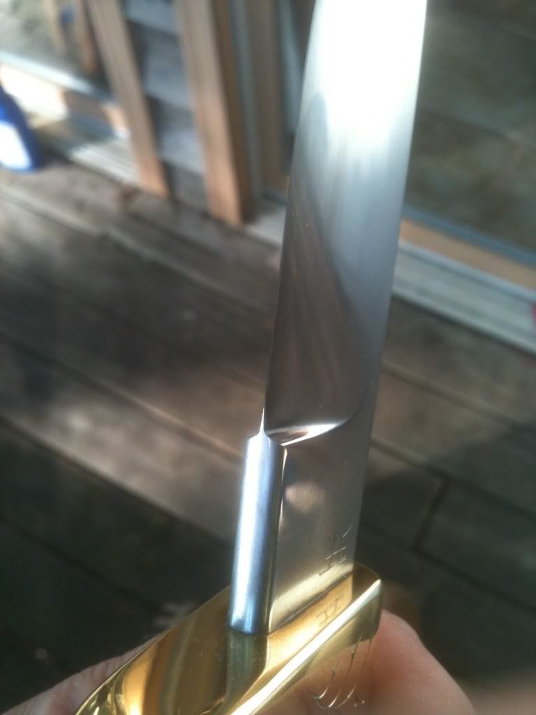

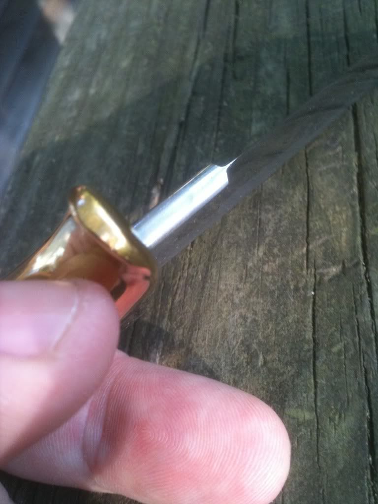

From one of Ed Fowler's yearlings, the edge profile from ricasso forward. Note a
small area left unsharpened.

These two photos should follow the initial ones i posted from Stuart. This is a more recent knife, with more room at ricasso. He says it's #14, in
total. A tremendously gifted guy! My thanks to him, using his knife photos as the "guinnea pig" for this thread. ;)

Thanks David. I as mentioned I sent you those as I thought the photo in the original post wasn't really the best example of this style properly executed. It seemed to lead to the perception that this style is more dangerous than it is.
I think these pics of a later and better iteration of Ed's style are a better representation from me.:o:)
Just wanted to say that as the knife in the first photo was feeling more and more like a mistake. :p
