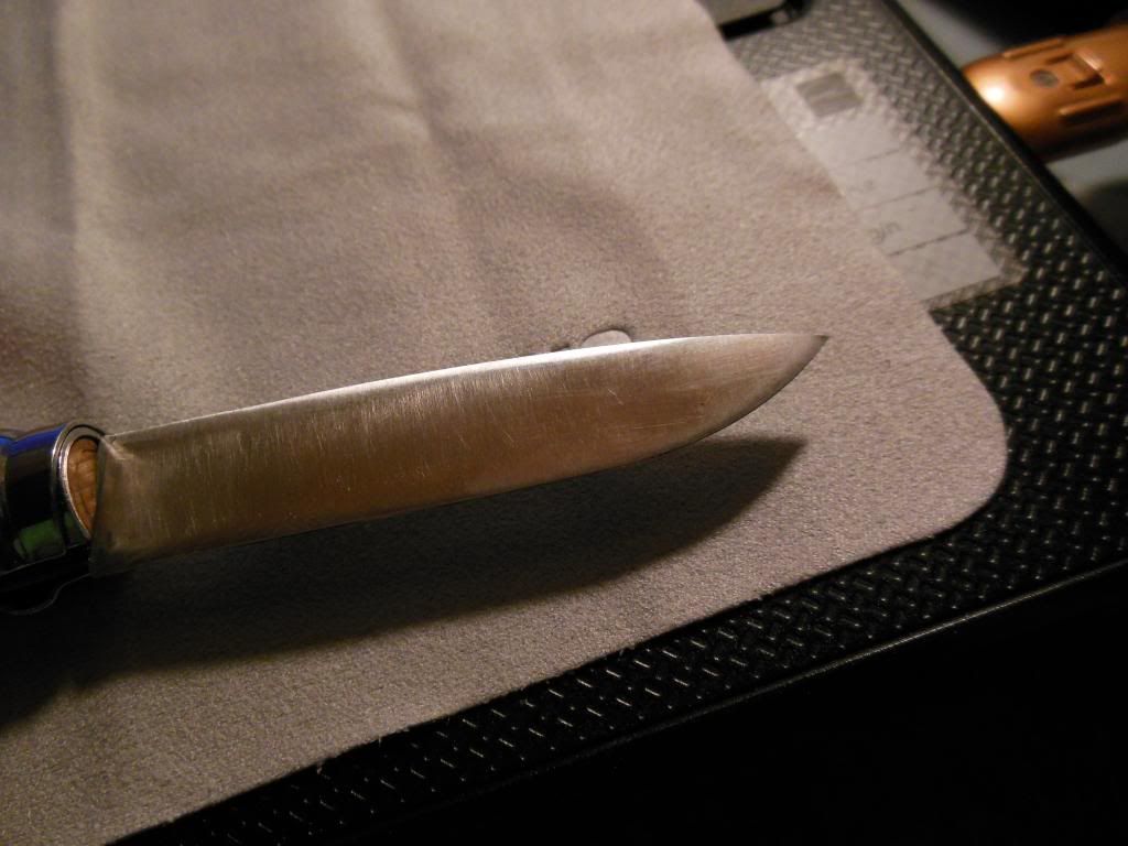

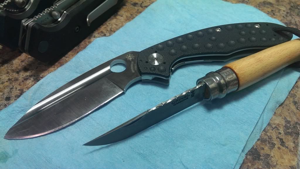

Just got a belt sander today, I dropped down the point and it looks much much better now. I plan on putting some kind of lanyard on it and doing that little notch to make it easier to open as well. Maybe attempt a polish blade too.

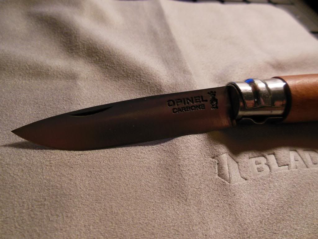

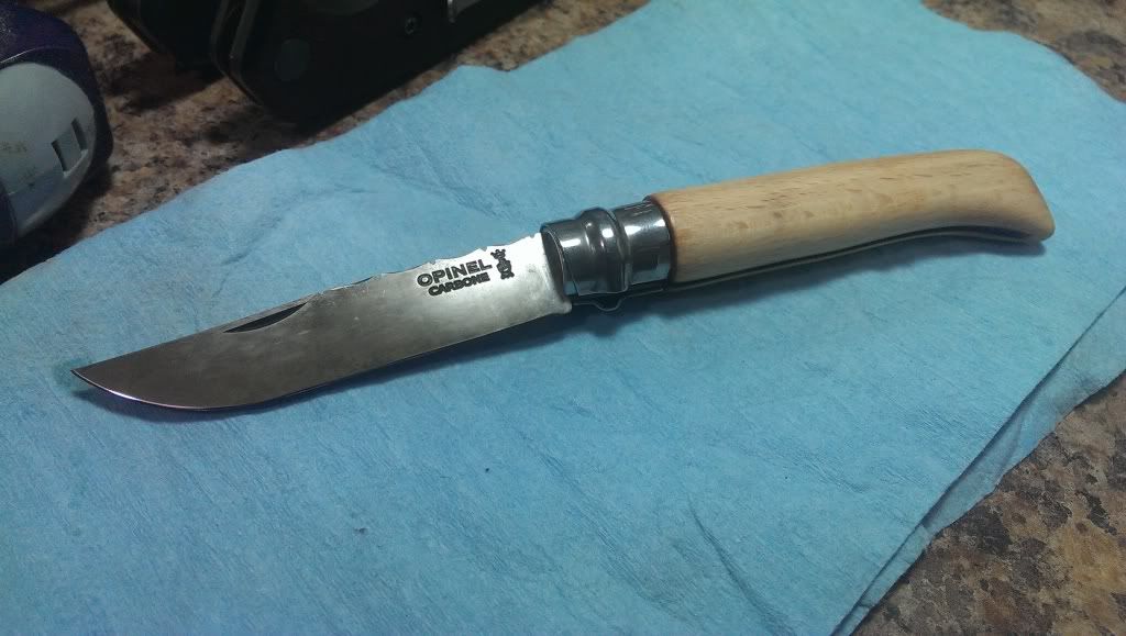

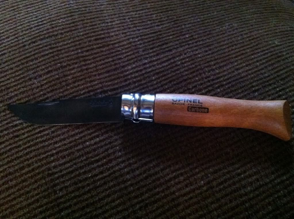

I like that drop point! I got my No. 9 in today and sharpened it up. Then I used the birchwood Casey gun blue. I think I may work the handle down some then dye it with black rit dye.

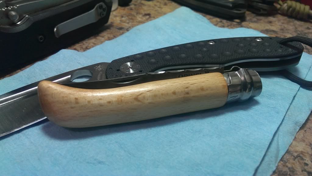

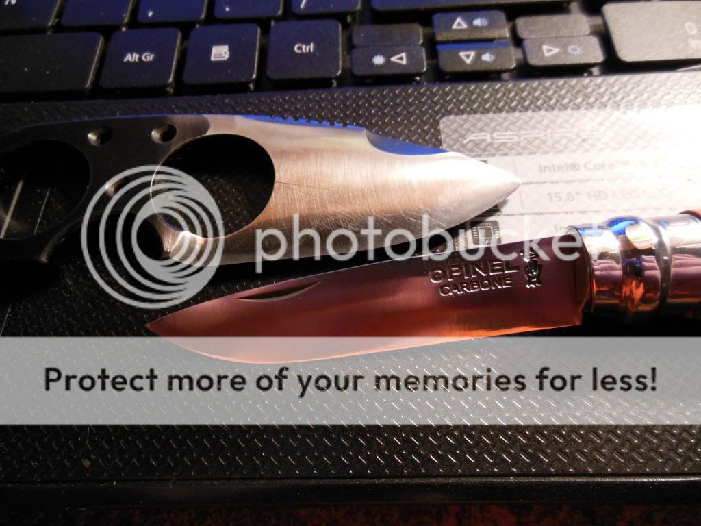

Here is a better pic of the drop point mod I did and just ignore the Silent Soldier there, it just happend to photobomb the picture I guess.

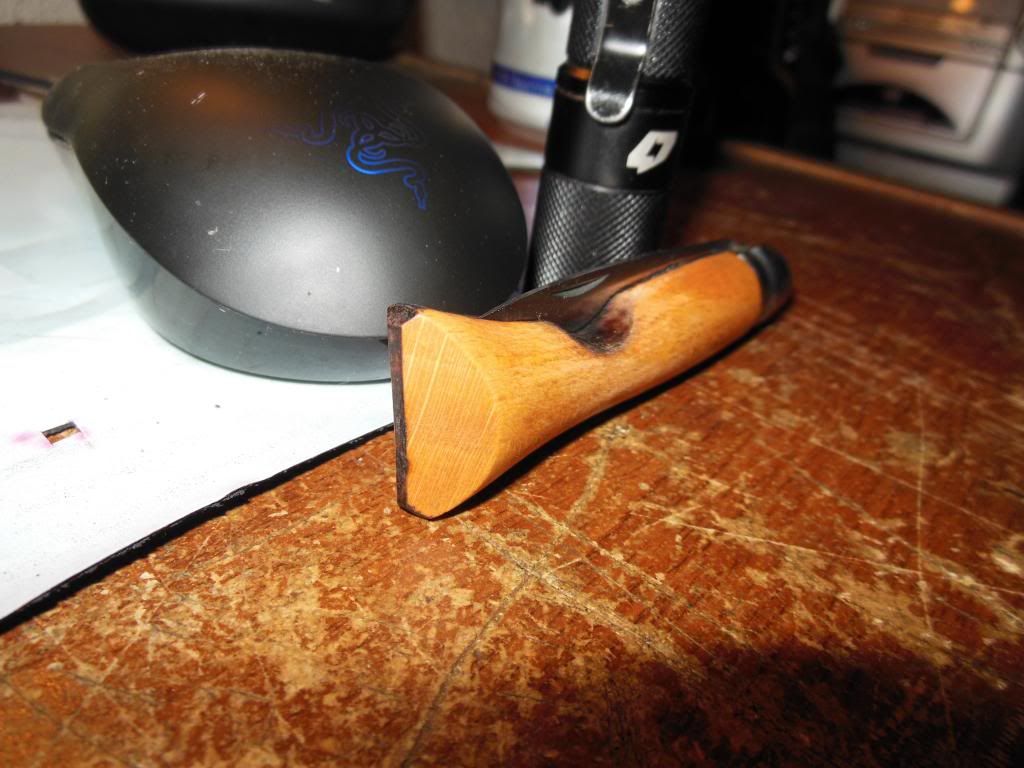

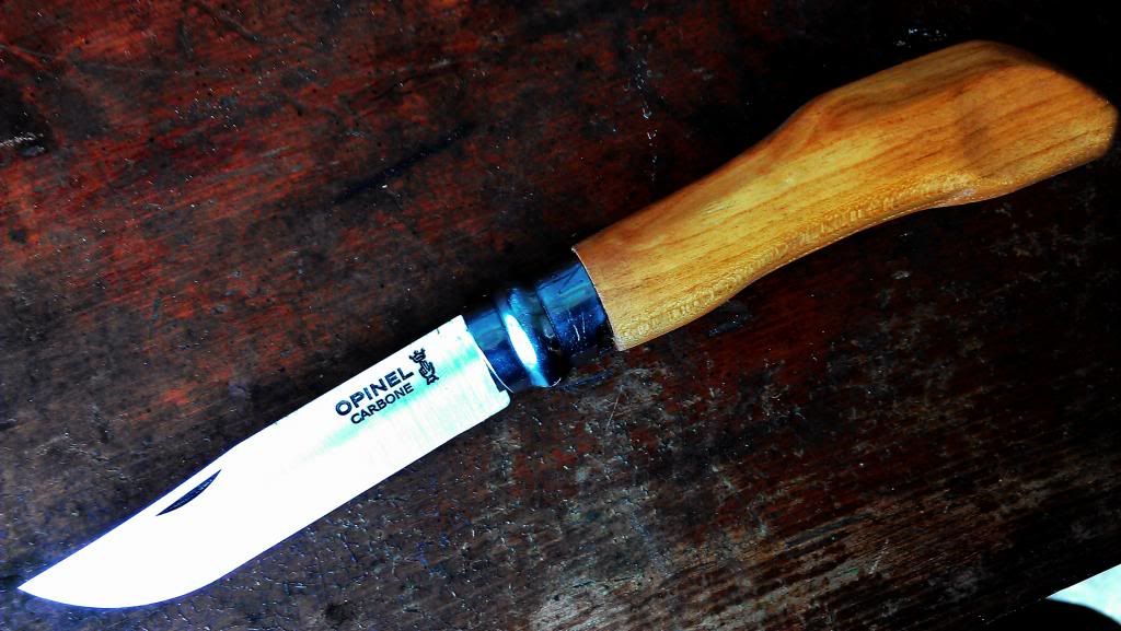

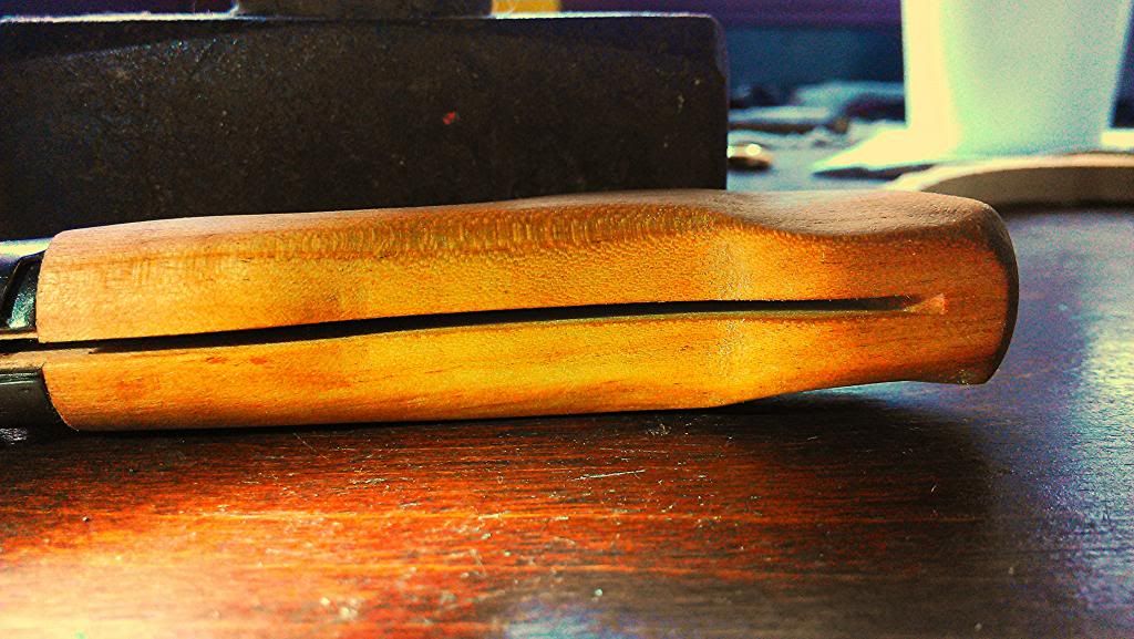

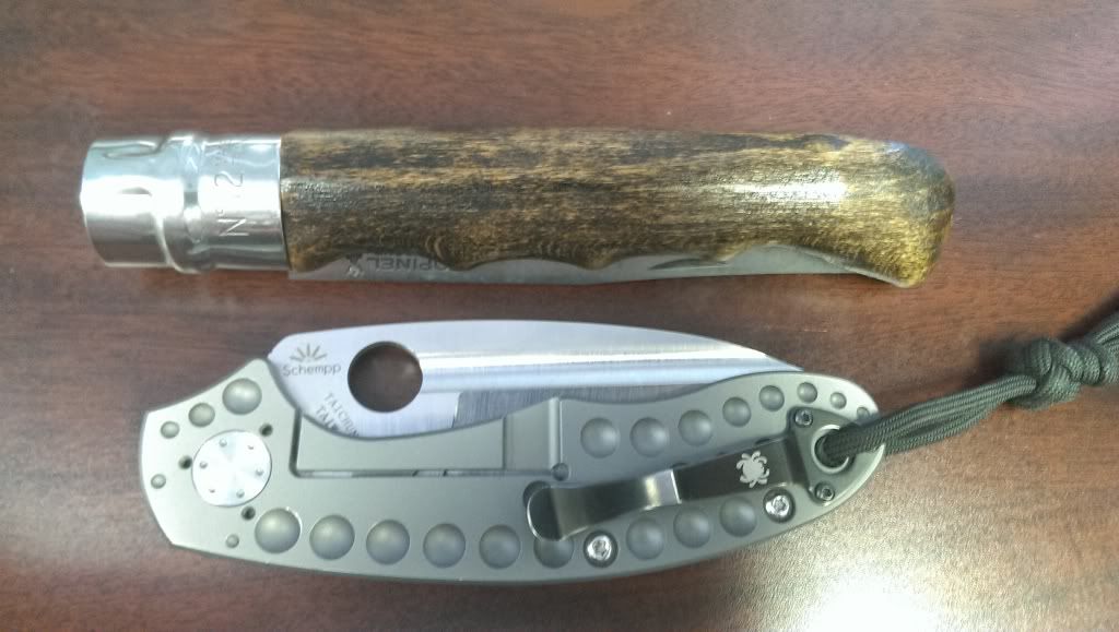

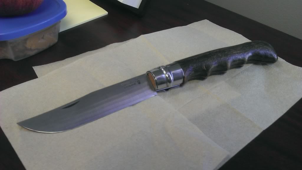

Here I did a trial by fire and darkened the flat on the end and I also filed in a finger groove finally and darkened that with my wood burner as well. It's not quite as dark as i want it but It's late and I need some sleep so I'll get back to it sometime. My camera's stupid auto focus made this angle hard to get both dark spots in focus too I had to put my quark pro and razer mouse there for some extra background to focus on.

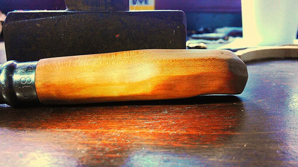

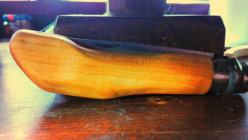

I rounded off the handles on mine and did some other things but I haven't taken pics that i remember lol. I've removed it from my edc and it has a permanent residence in my lunch box, I use it at work for food prep. I can't keep my edc knives clean enough to use on food. So I now have a lunch knife lol.

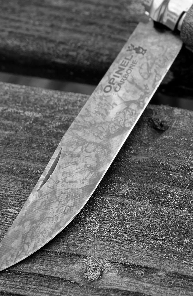

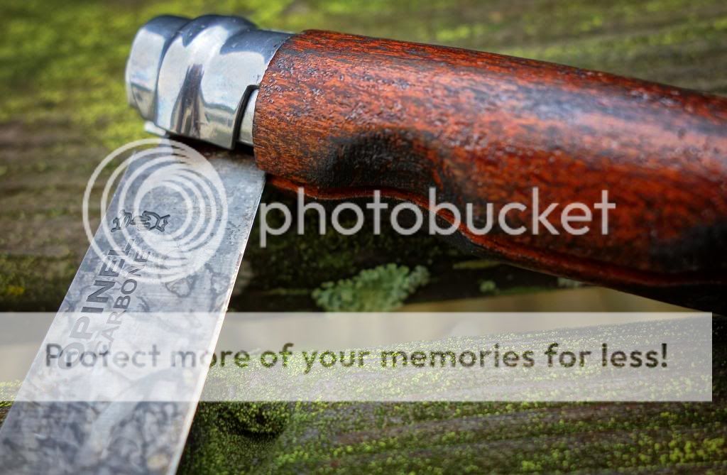

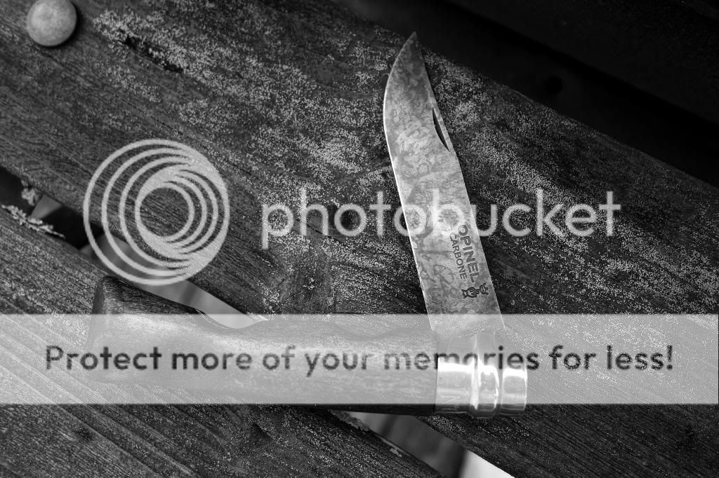

Hey Y'all,
This is my second Opinel (first was unmodified and gifted to a friend). I like the Opinel much more after customizing one of my own. I've begun to enjoy the feeling of taking my time while pulling out my knife for a cutting task; pulling out my Opinel makes me slow down and reminds me to take my time and do things properly.
Sanded the handle to get rid of the harsh edge between the handle and bolster. Sanded the butt down to a rounded shape.
Brushed the stainless locking bolster. Forced a patina on the blade with vinegar. Painted the handle red, let it dry, and then sanded it down in patches.
Going to do another No 7 soon. Probably a Carbone. Planning on sanding off the finish, rounding off the angular butt (leaving the top point), and using a file to put a deep checker pattern on the handle. I may also play with the blade shape while I have access to a grinder.
I wish I had the skill to carve an intricate fish-scale gunstock pattern on the handle. I would try to make the end look like a tailfin. I'll just have to practice.

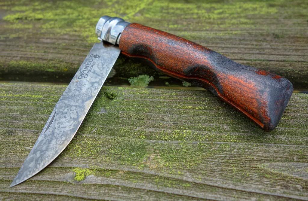

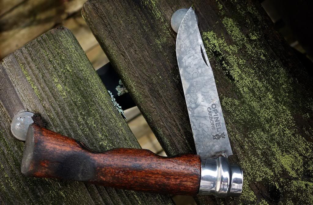

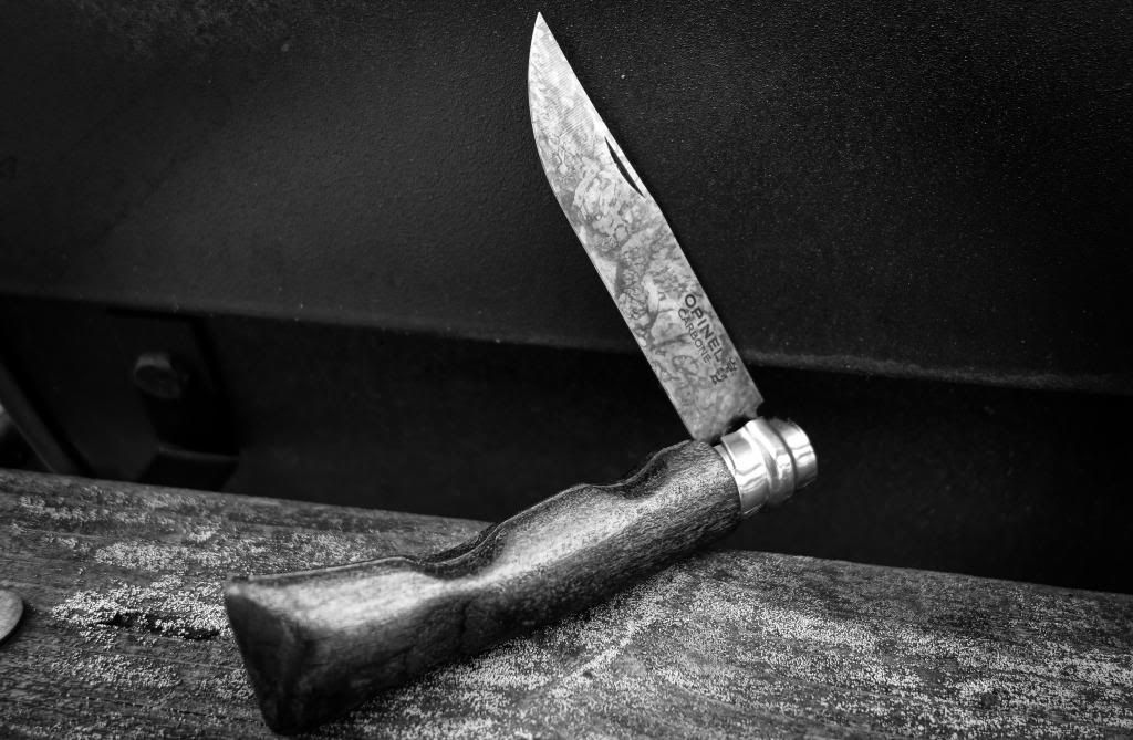

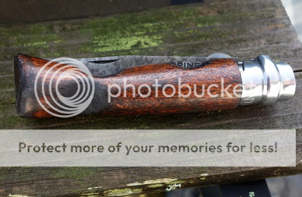

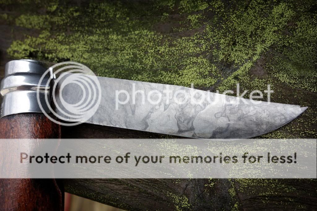

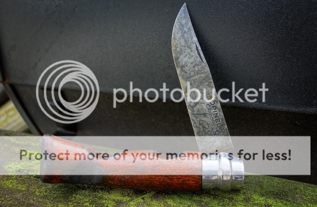

mrphotoman, that looks pretty darn good.^^
I like the 'charcoal' character (this is what it reminds me of) seen in the photos. Looks as if the whole knife just came out of a forge (handle and all). :)
Very nice! :thumbup:
David

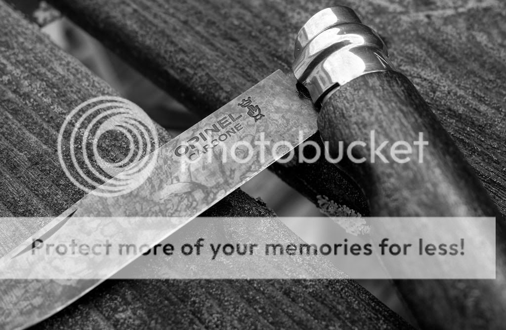

Thanks I appreciate it! I used an orange on the blade and a old round file I had from harbor freight and some sandpaper on the handle then I dyed it 3 times using dark brown Rit Dye. I want to get another one and use an onion on the blade.

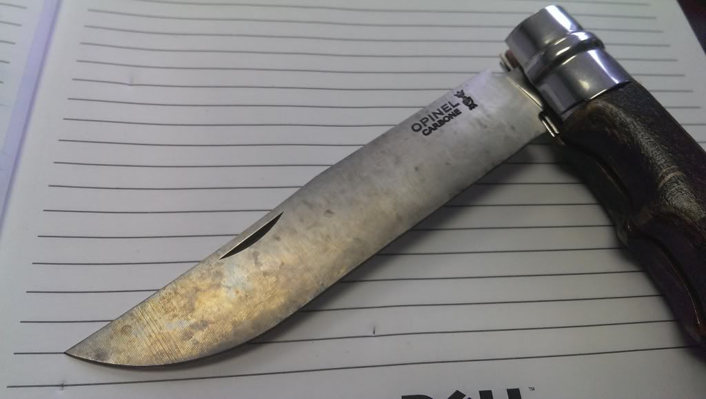

Aside from the lock collar that thing looks very well aged. That reminds me I haven't used mine in quite some time. I've been using my edc just to use it and it's been in my lunch box. I put my whole box in the freezer as I have a freezer pack in the bottom that i left melt and i refreezed it to custom fit my box. I don't bother taking my opie out...all that freezing, condensation, moist and hot and humid environment at work then back to the freezer to start another day...i'm sure it's pretty looking by now...Hopefully I still have a blade haha.

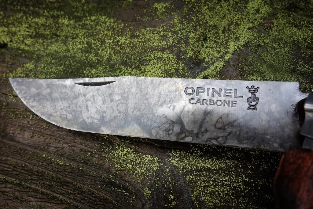

Just pulled it out to look at it...I didn't snap a pic before i sharpened it, i couldn't stand seeing a rusted chipped edge so i broke out my new pocket double stuff ceramic by spyderco to try it out. That rust isn't surface rust either, she ain't wiping off, its there to stay and I'm gonna keep it. Something about a natural patina just kinda excites me. One of those simple things in life that only a few will understand. The other side is just as bad and the spine is bad at the tip but fades out to clean metal about a third the way down.

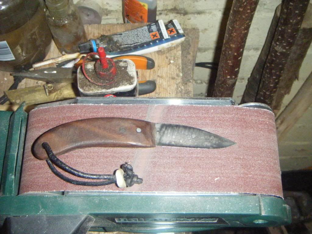

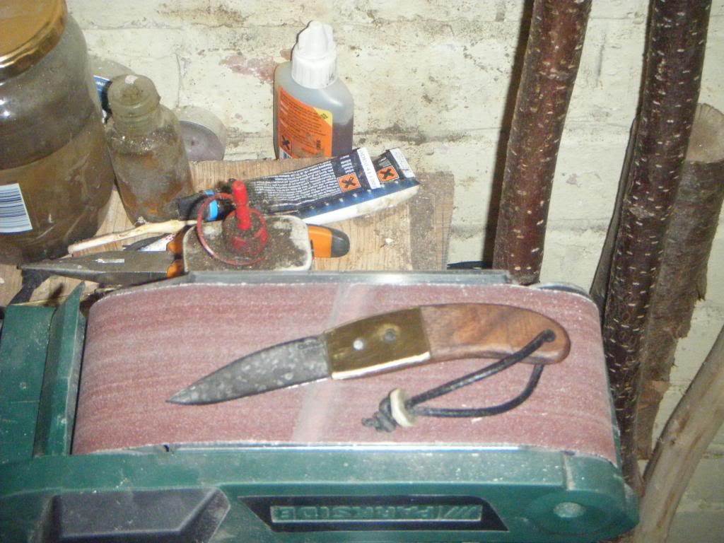

I made this for my father in law the other day.
He needed a carving knife for pipe making and stuff like that so I opted to do him a favour!
This opinel started life as a #9 carbon beech, l but I quickly changed it into a mountain man-esque pocket knife.
But after a failed attempted at an antler re-handle job I was left with an unused blade..
Thankfully I had some turkish walnut and brass laying around so it could be transfromed into something useful. :)

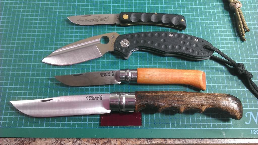

My #8 and tacti-opi #12; shaping/sanding followed by stain on the 12 and polyurethane, just shaping/sanding and poly on the 8. Patina on both is au natural...
