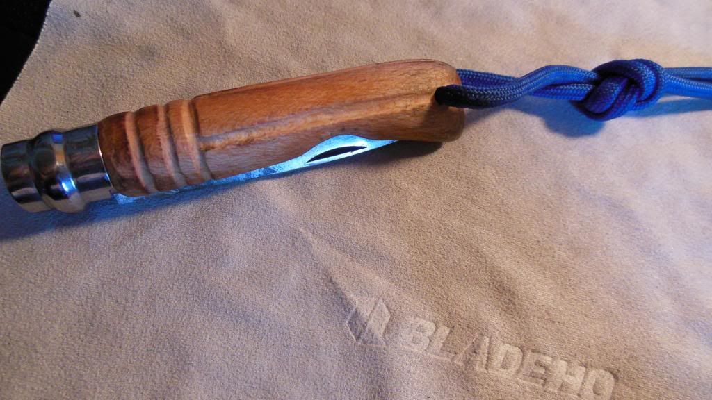

Need some help. I received my first Opinel a couple weeks ago (No 8) and really want to make an easy open notch like pictured here. What tools do you use to make a notch like this?
You can carve the notch out with another knife, file it out with a small rasp/file or even rub it on a brick! it's very simple :)
Finish the surface with sand paper and a little food safe oil and you'll be sorted dude!

Sounds like soft wood for sure - thanks for the info. I have a variety of rasps, files, etc. So I should be set - I've always liked using older hand tools. I am waiting for my second Opinel to be delivered this week (No 9) and want to be sure I don't bugger up the only one I have now.
I think modding these knives will make me some nice winter projects - now to gather some more!

The standard ones have beech handles and are soft so you'll have no issuses when going slow. :)
Keep us updated on your mod's mate.
