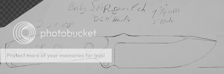

I voted #1 because it fits well with my uncompromising, hard-core mall ninja persona, but #2 is growing on me. Jaxx's idea looks pretty good, too.:thumbup:
Jaxx, I like your treatment on that. I would take the underside of the handle out the the end of the micarta and then a sharper radius (drop) for the guard/talon hole, then your subtle choil (maybe slightly tighter radius) and call it good. That gets me close enough to my working edge :thumbup:
I like it, Jaxx - but you do realize I hope that since you came up with it and posted an image of it he can't use the design now. Dang it all!!
Huh??? :confused: Why not? ...He can mod it, as I would figure that he'd want to do anyway. :)
# 2 for me ! Totally useful blade! Although if the number one didn't have this "almost choil" I would have to buy both :D
If I keep screwing around with Jerry's designs, he may decide to 'disown' me. :o ...But I took another shot at it. :) Went to sleep thinkin' about choils vs. no choils and such. in this photochopped copy, I chopped in a much smaller choil, one that the owner could round the corner on & sharpen. I'm thinking that it would drastically reduce catching, but still serve its purpose. The Talon hole area is still there as a finger guard... Besides INFI steel, what says "Busse" more? ;) ...I also dropped the handle another half degree to a full 2 degree angle lower than the original drawing of #1...
Take a peek... I do believe, from reading posts here, that the ultimate solution lays between the two design sketches... But since I have zero SAR experience, and zero knife design/mechanical engineering experience...Maybe I'm full of it! :o :D:D
Great idea Jaxx!!! I really like that concept! :thumbup: Although in my opinion there should be no choil on a SAR type of knife. SAR people often have to use their knives in harsh conditions - many times when their hands are cold. Using choil it that situations can be risky. Also choils do not help when cutting ropes and that kind of stuff especially when the knife is a bit dulled and cutting is done with a movement resembling using a sow.

Jerry I have to change my vote, kind of. I am feeling the handle and thumb ramp (although moved forward a bit) of #1 and the blade of #2. Either that or keep #1, move the thumb ramp up, ditch the choil and raise the sabre grind line, oh and don't forget to make convex all the way to the edge. :D I have to agree with the train of thought that going choil less on #1 is the way to go, people who have to have one could have the mod done pretty easily. I have to wonder if you favor a specific size of choil based on the curves and their relation to stress points.
Loks good. I like the much smaller choil. As much as a know it is part of the Busse look the very large choil is one of the things about my BATAC I would change if I could.
Either one but please do not eliminate the guard:grumpy:
I would be happy with a finger choil, a small choil, or no choil, but for cryin' out loud, don't remove the guard.
