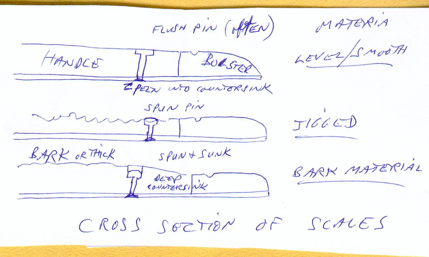

What is wrong with recessed pins?
Is it historically off? Is it not as strong? Purely aesthetic preference?
I'm a peened pin kinda guy so aesthetcics has a lot to do with it. I have to wonder if a pin that sits half way through the handle is 1/2 as strong as one that fills the hole. There is no head so I worry about a scale that warps and slides up the pin. Basically it looks like a mistake to me.

On recessed pins; there is still a "shoulder" for the pin to "pinch" against because the holes are usually countersunk, so material sliding up is not an issue, IMO. Here are crude cross sections of various handle types:
The type of material usually determines how deep the countersink winds up to be.
If the cutler is trying to preserve the "bark" sometimes the countersink needs to be much deeper than the surface.

Makes perfect sense to me, thanks.

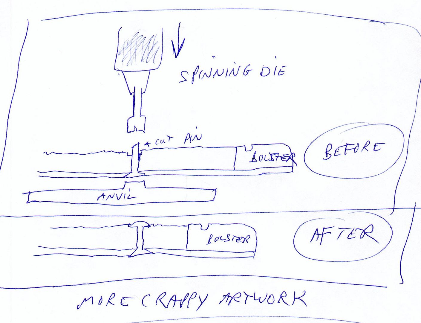

Neal, basically, a spinning die is brought down on the cut-off end of a pin. The die is shaped to form the pin into a cap with a smooth surface. It sort of "smears" the metal down snug against handle material, tightening the handle to the liner.
Hope this pic helps.
Thanks, Charlie.
I'm loving your illustrations-- straight from your hand, and explaining the information clearly.

So you're saying my picture is worth a thousand words? :rolleyes:
Saves a lot of two-finger typing I'll tell you! ;)
