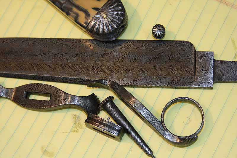

Here you can see how I forged the bars so they will follow the blade edge.

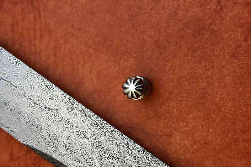

We decided to go with the 18K domed gold pin and let me just say that I am glad we did. I think it adds to the knife and is small enough that it doesn't take away from the Ivory.
I'll have some pictures on here in a few minutes for you all to see.
Thanks for keeping with this thread.

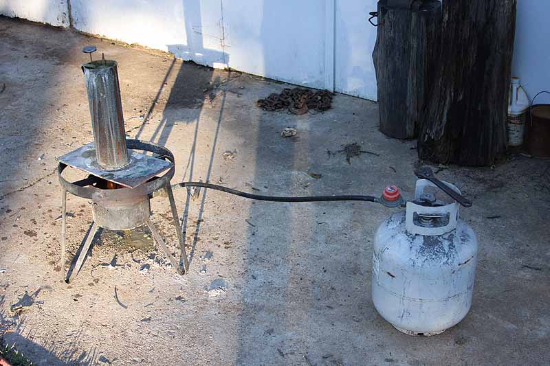

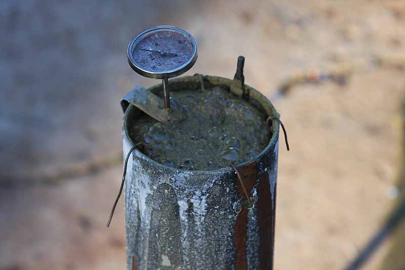

This is my caustic salt bluing heating up.
It's hard to imagine that this yucky greenish goo can make the knife a lot prettier.

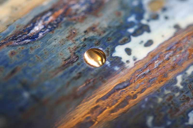

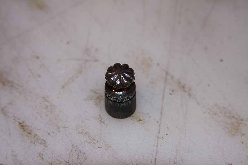

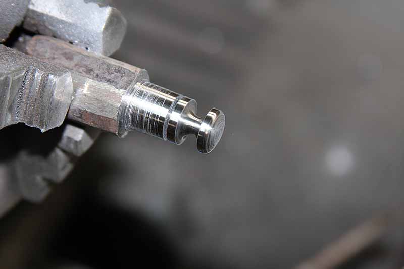

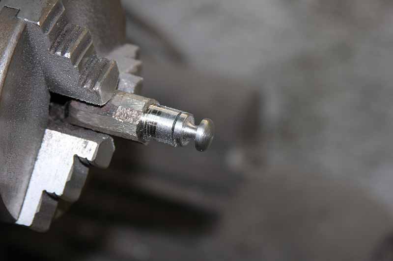

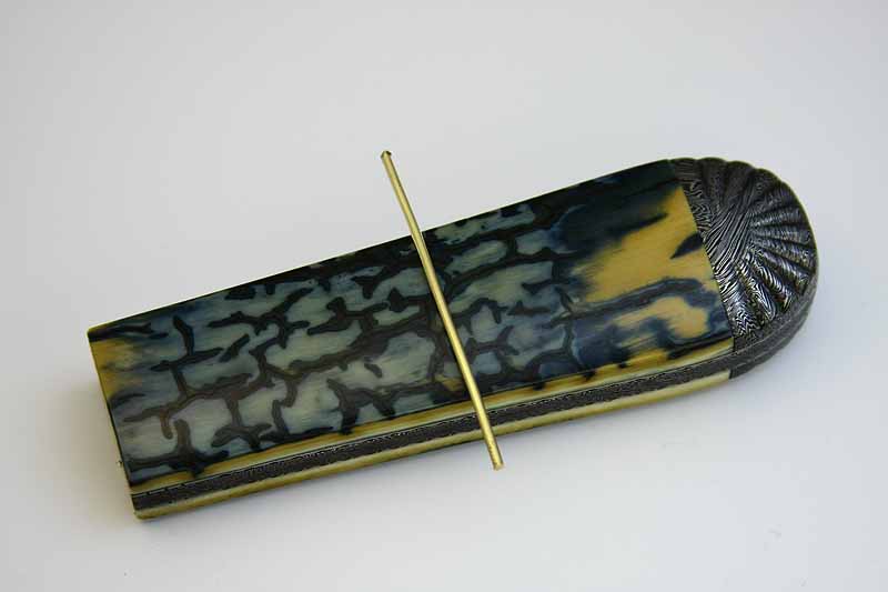

Here is the 18K gold I'll use for the pin.
I've cleaned the damascus off with 2000 grit paper and you can see how the 1080 is nice and dark.

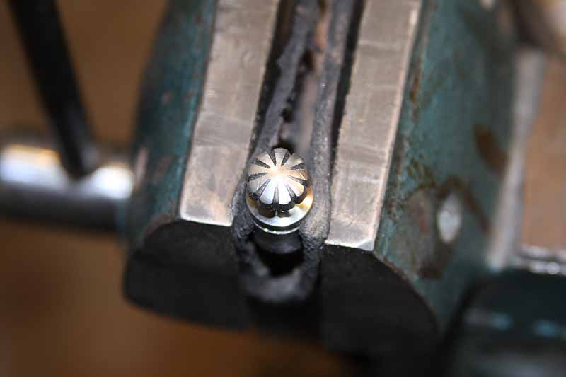

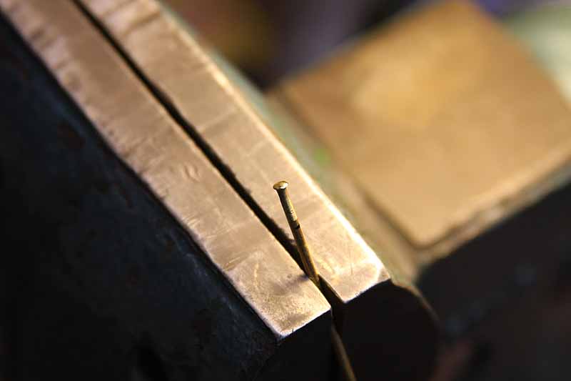

The pin will not go all the way through the handle because of the take down feature so I'll dome the pin before I put it in the handle. Next I'll peen over the pin on the backside of the handle, then I'll do the same to the other ivory scale.

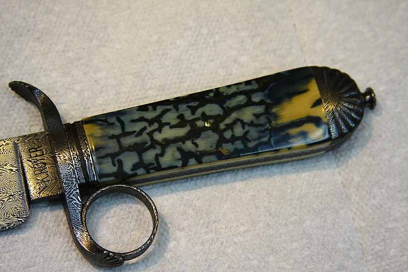

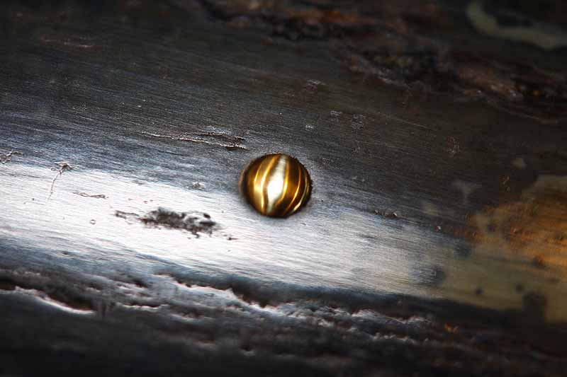

I have cleaned up the pin and buffed the ivory a little more in this picture.
Here's how the pin looks.

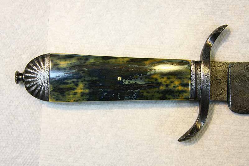

And a shot of the other side of the knife with the classic clam shell guard.(the lighting is a little dark in this picture)
This is a close up of the pin on this side.
I changed the camera lens in this picture and got a super close up shot of the pin with my brothers Macro lens.
Here's another close shot.

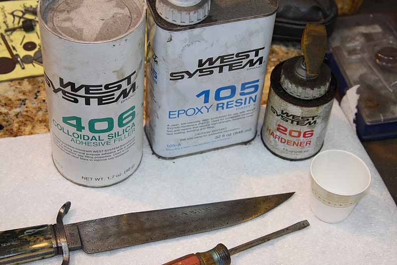

Now I'll epoxy the handle together. I will not epoxy the spacer or guards because it is a take down and you couldn't change the guards out if I did.

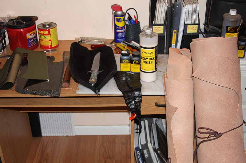

Here is my little leather working area.
I love it Kyle.
The gold pin provides a nice and subtle touch yet acts as a finger index for the center of the handle if grabbed in a hurry.
I'm crazy about the ring guard, however the bowie certainly doesn't suffer with the classic clamshell guard.
You out-did yourself my friend.

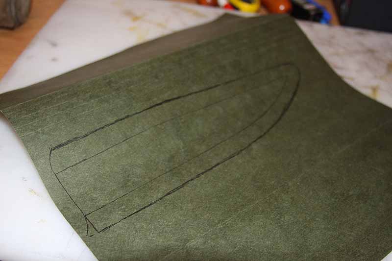

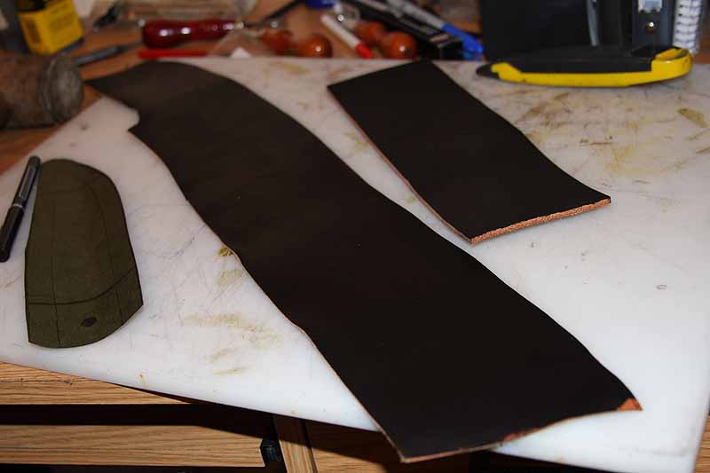

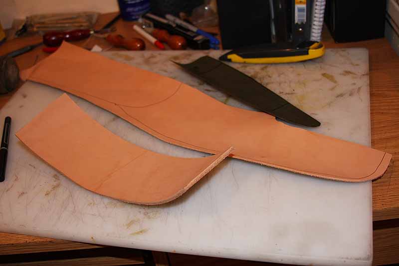

This will be a pattern I'll follow when cutting the leather.
Now I've cut out over-sized pieces of leather and will stain them next.
I stained the leather black and can start cutting everything closer to shape.

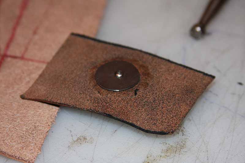

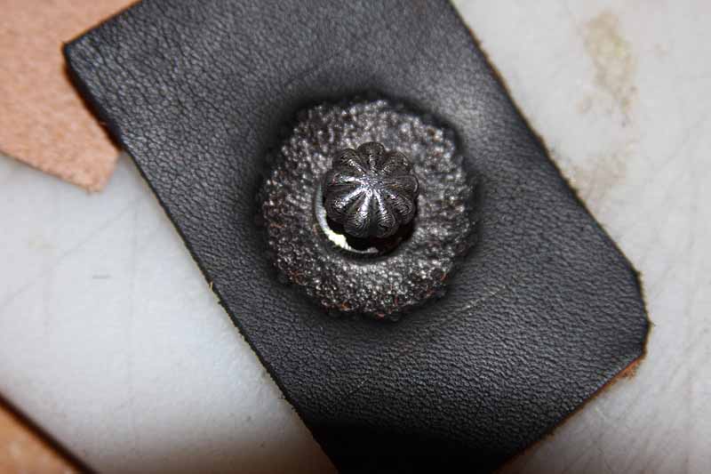

I made a 20 thousandths thick washer for the screw that holds the damascus frog on and assembled it in this picture.
Here's a top view of the frog. As you can see I have also pebbled the area around the guard.

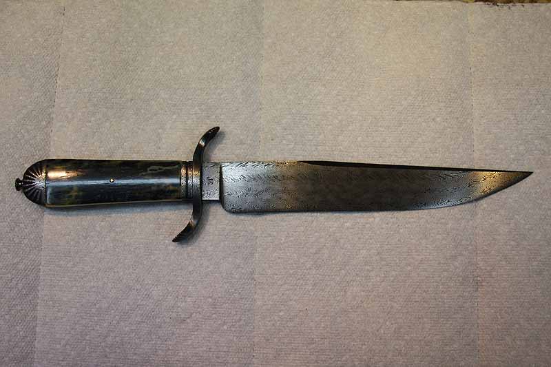

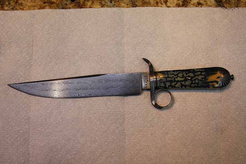

Here is a picture of the finished knife I had my brother Caleb take. I will also have Mr. Cooper (SharpByCoop) work his magic with this knife.
I would like to thank Caleb for this picture. I think he did a great job.
It's great to see them side by side...makes the comparison real easy.
Both versions of the knife are great and I like what you did with the ring guard but to be honest I like the classic clamshell guard even better. That is it just fits my taste better.

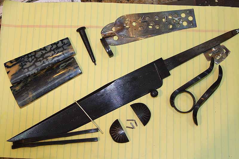

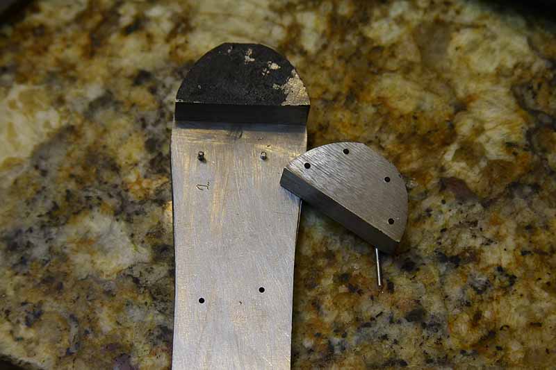

Really fantastic work. But I have a question - are those clam shells on the end of handle only glued with epoxy to the liners?
No, they have four internal pins that have been swedged ever so slightly. When I epoxied the bolsters together I pressed them on tight with the vice.
EDITED TO ADD PICTURE: Here is a picture of when I made the holes on the inside of the rear bolsters for the internal pins.
