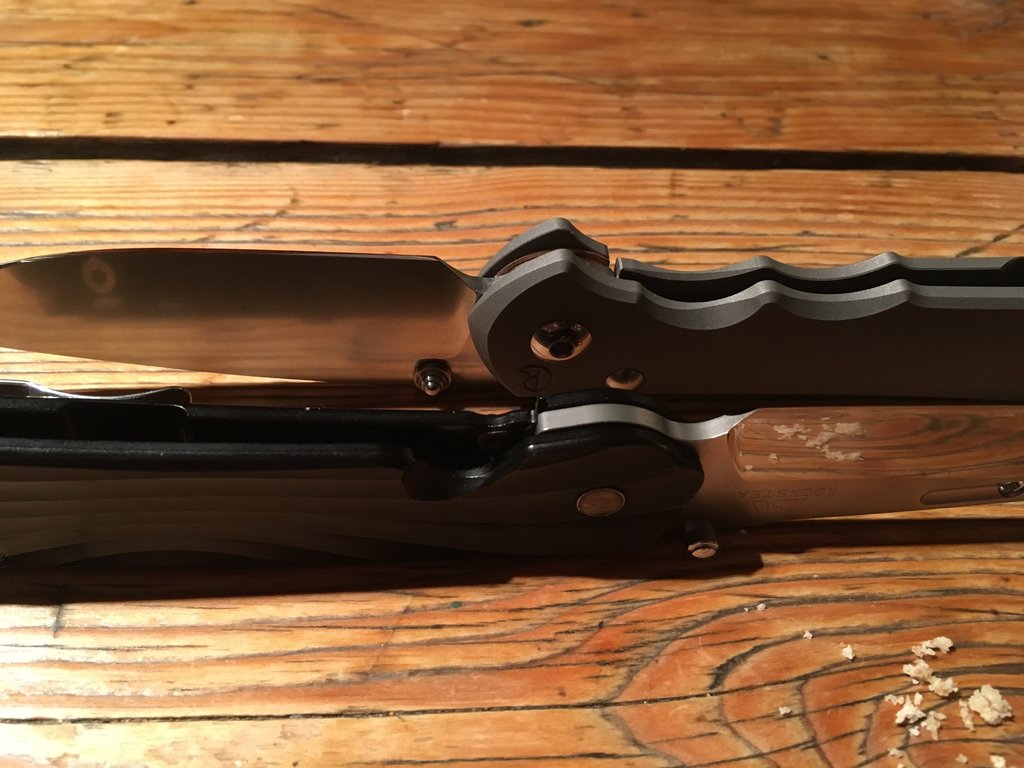

Did you ever come to a conclusion on this? I will mention that removing the stingray inlay will not allow access to the pivot. Under the stingray is just more aluminum that the inlays are adhered to.
On the Kou, at least, the pivot bolt is just under the stingray. As you mentioned, it may be possible to tighten the round nut on the other side, but you'd have to use Lok-Tite and hope the bolt doesn't spin.
Here's a photo of the pivot bolt just under the stingray inset.
image-proxy
image-proxy
You are right, I'm not sure why I was thinking that:confused:
It's been a long time since I've taken my Rockys apart!
