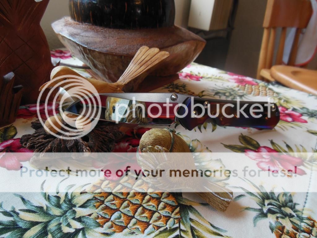

Saga To Highlight The "Razor" Look in the Insingo.
Great work! But how the hell do you shave when the mirrors on the Razor! LOL

How did you do it?
It had a rather fine base finish, I got away doing everything by hand.
Simply use decreasing emery grit, make sure no previous scratch remains before progressing into next. On my Insingo, tested finish under original stone wash appeared to be a dirty 600'ish grit finish. I started with 400 to remove all remnants of stone wash, moved up to 2000 enough for a dirty mirror finish. After, hand buff with various compound to further refine the imperfections and the result is posted.

Thanks. It is nice victor. Did you polish with the blade in the handle, a jig...? Did you go up in 200grit increments? Finally, what types of polishing compound did you use? Thanks again!
