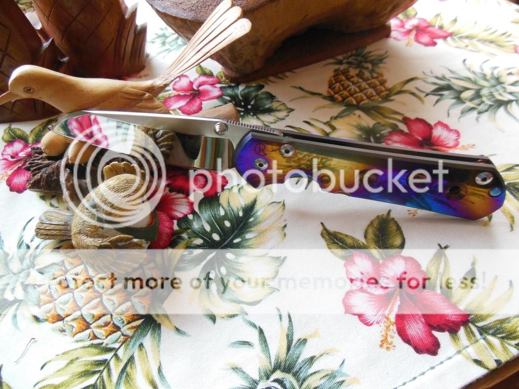

Saga To Highlight The "Razor" Look in the Insingo.
Hawaiian Sun shinning through the mango tree today after a few voggy days:
Lovely pics! I've followed your whole process from the other thread till now and all I can say is you have talent and a unique eye for beauty! Those colors are extremely bright and vivid and the blade! It's a mirror! Do you plan to anodize the screws yet too?

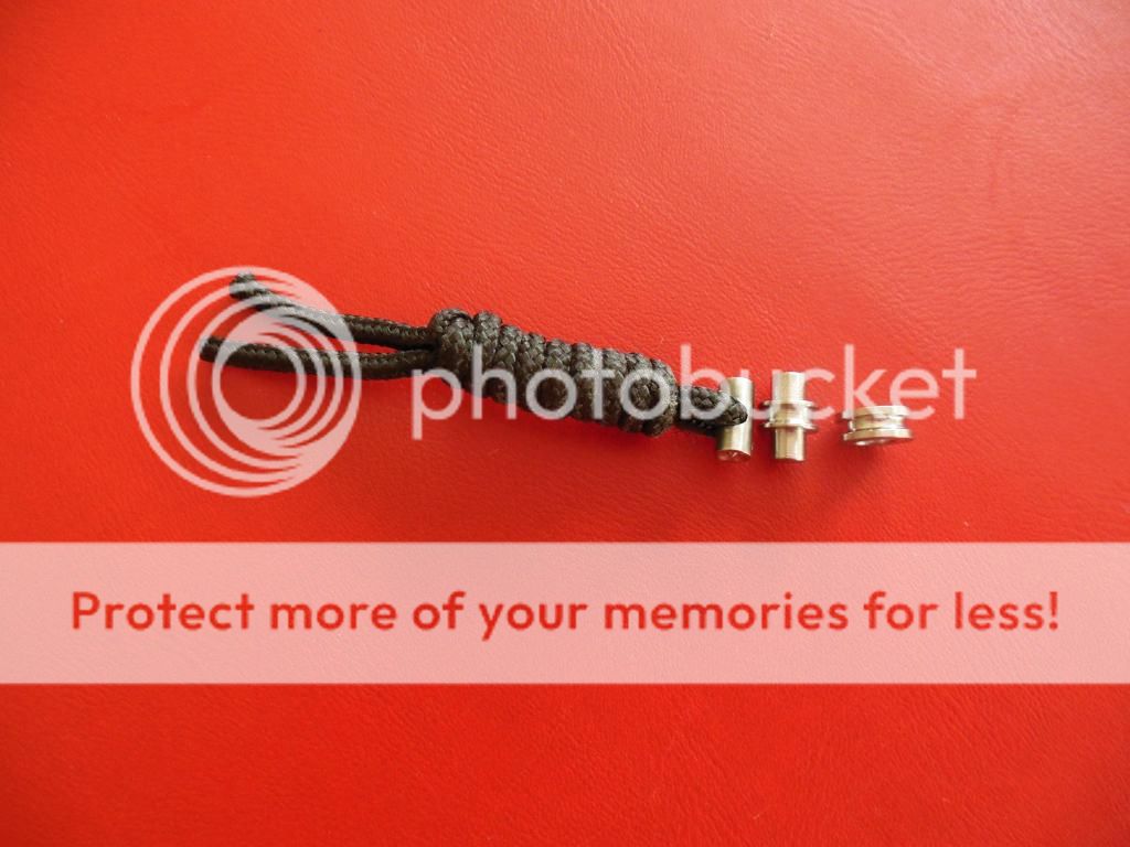

Future evolution on my Insingo will consist of Plan A & B.
The following will be on Plan B:
Actually, heat treat to alter the mating screw finish are within part of the continuing evolution plan. You are right on! Just have not decide on color intensity and for now, letting it play out in my mind!
Stop pin replacement bushing is going to be made with 17-4 PH, heat treated to low 40'sRC, remains as a sacrificial item, just a little better to resist flattening, prolong lock positioning with repeated contact from the blade tang. Possibly, ended up either dark blue or straw brown in color.
Floating titanium shouldered lanyard replacement pin end flat face is beginning to be an itch for me! It will probably ended up with concave divot ends and/or combining with a thru hole, matching effect to the rest of the screw's optically hollow center, the flat face lanyard replacement titanium pin is not pleasing visually and magnetic to my eyes:

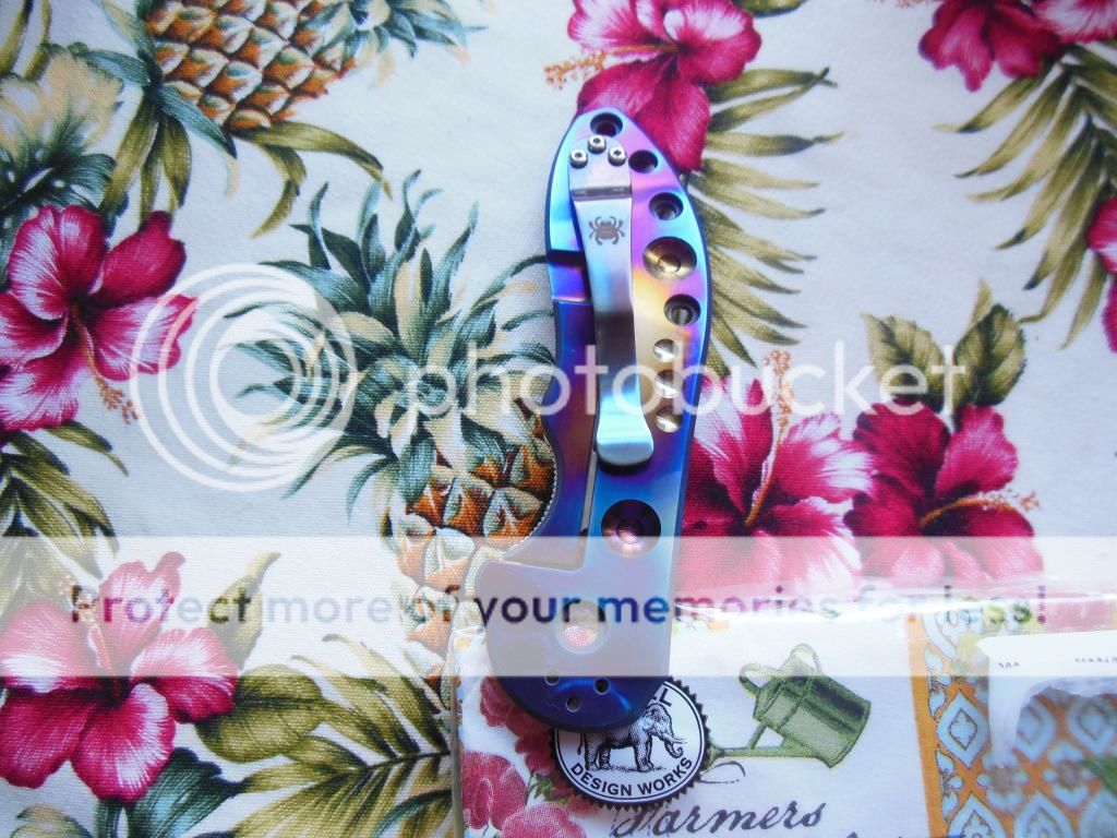

Yes, several projects going on at the same time, so I can digress, switch one to the other for a change of pace! :)

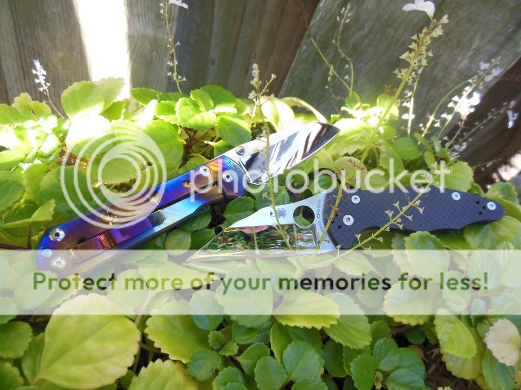

This was done in comparison with an unmolested:

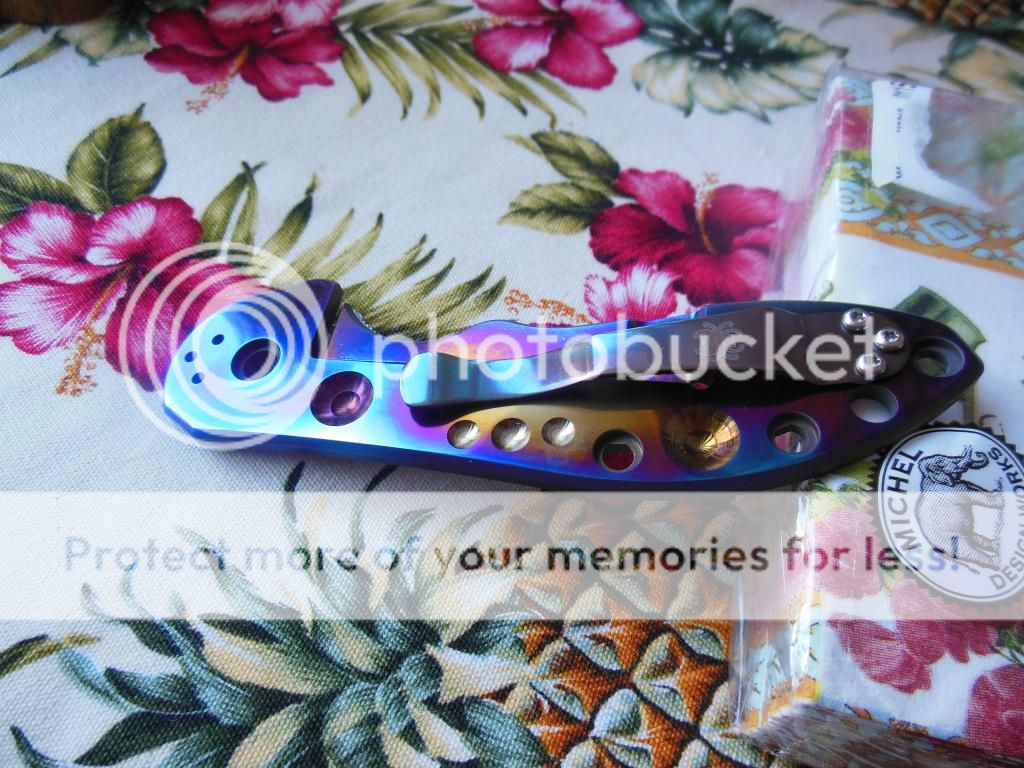

This past Monday decided to put a little color to the clip for a more subdue'd effect above the carbon fiber handle, at the same time, not to distract from the reprofile blade's mirror polish, which is intended as the center focus:
At the moment, second day into a BBS Sprint Domino' transformation. Handle slab milled, waiting for the mirror then flame ano finish. Deep into blade sanding progression at the moment. Unlike the super hard S90V on the Yo, Domino's CTS-204P is no slouch - good fun to get the finish expected.

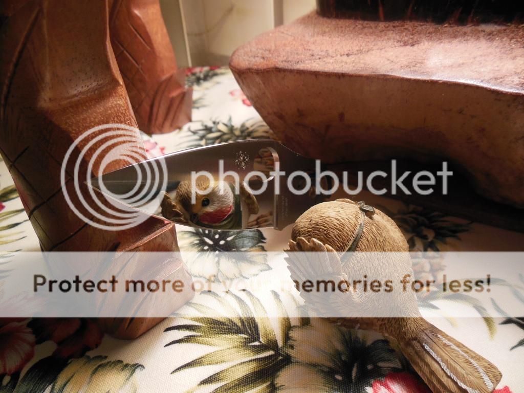

Picture was after 10 hr. but 20 hr later, flaws have nothing to distract on FFG blade shape - still not satisfied:
Will be finishing up this today, much easier and taking a little time out from the CTS-204P's chase for a satisfactory mirror:
Saw a nice video relating to Japan's Katana yesterday. Gleaming example of personal touches and skills to achieve the exact crisp line separation, sharpness along with a mirror polished finish - what admirable pride and dedication those blade smith shown!
Although it is a slow and deliberate process, it will be sweet to finish up with the CTS-204P and able to move back onto the saga with my Insingo!
