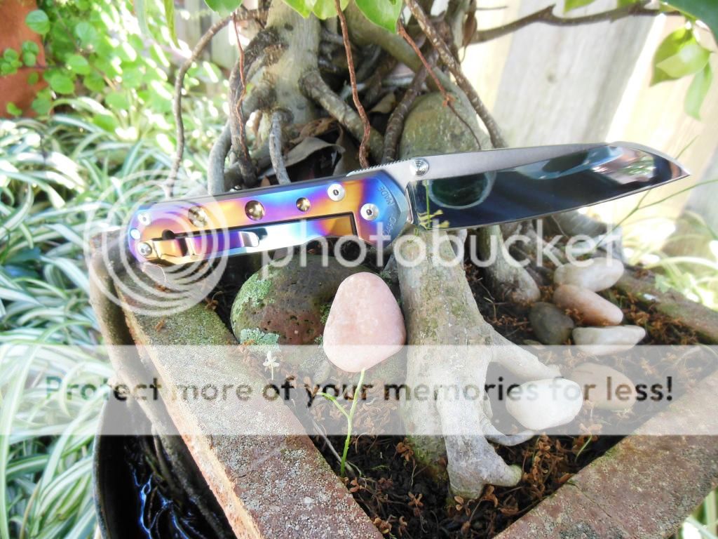

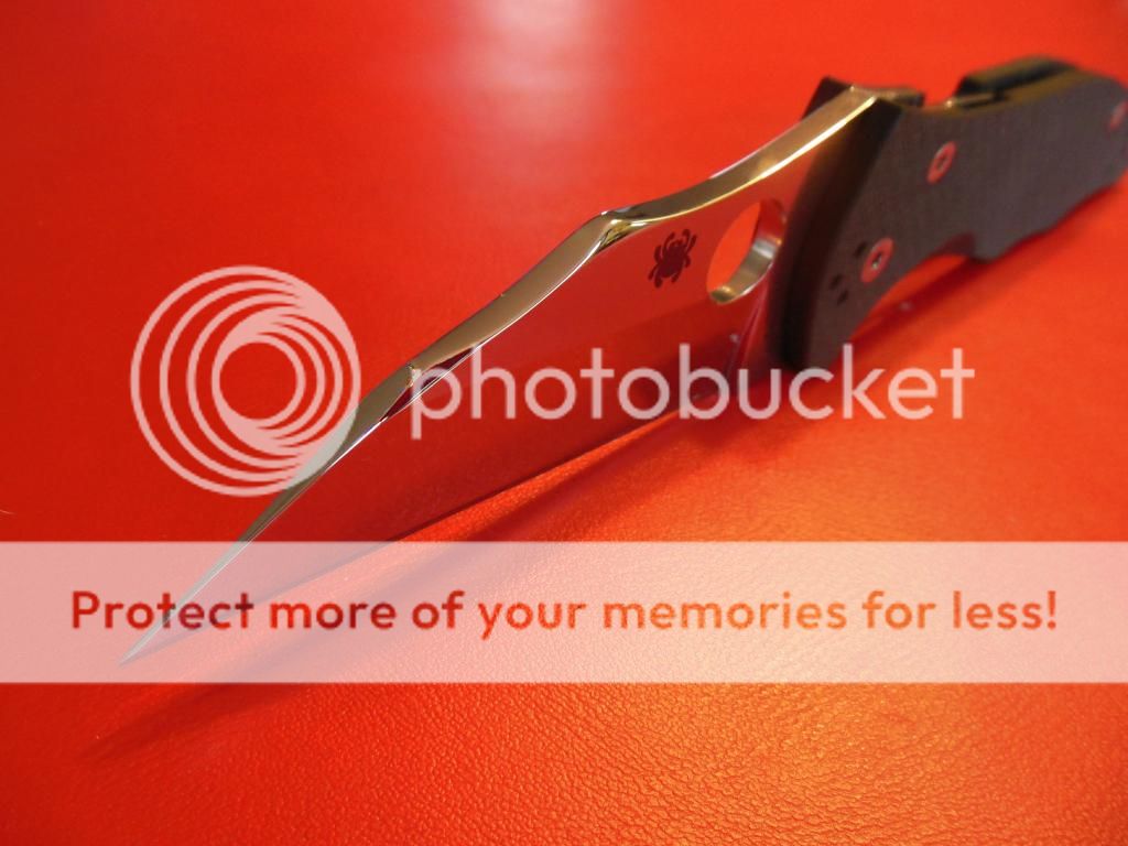

Saga To Highlight The "Razor" Look in the Insingo.

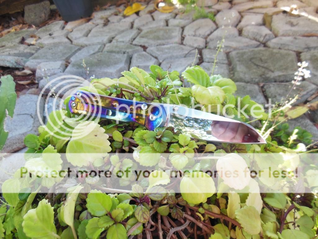

Thanks. It is nice victor. Did you polish with the blade in the handle, a jig...? Did you go up in 200grit increments? Finally, what types of polishing compound did you use? Thanks again!

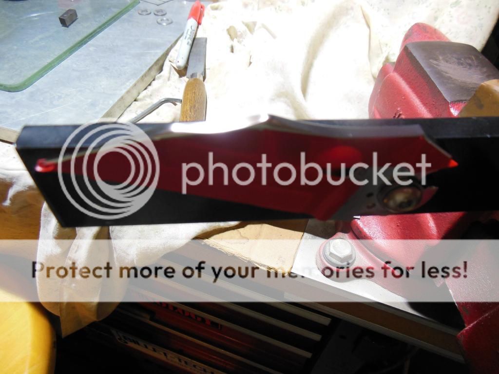

Lots of advantages using jig/fixture. I made a simple jig out of left over spacer T6 material, drilled and tapped for 1/4-20 thread. But you can make it any which way to suite you! I went out to take this picture to show what is being work on:
Combination of pivot-able blade mount and flat jig allow blade to work on different position without body contortion, better able to maintain my natural body positioning mechanic comfort for a sharper definition on blade finish. Here shown I am set up for mirror polishing progression:
I started one grit more aggressive then the guesstimated original finish under the tested stone wash, to ensure I ended up with a positive base line. Other than jumped 1200 to 1500 and to 2000, the rest is 200 grit increments. For lubricant, a few drops of dish washing soap + water will suffice.
In regards to polishing compound - I used diamond lap compound, stepped from 14, 10, 6, 5, 3.5, 1 and .5u to achieved the posted mirror. Transformation from 2000 grit dirty mirror to clear is immediate and improves with progression. For me, always a very satisfying experience.
Caution: Insingo is not a flat grind. I made several tubular tools using left over lexan tubing, machined T6 round tube and such, slit side to hold emery for better conformation to blade contour. Nothing fancy, really! If you need picture to clarify, let me know.

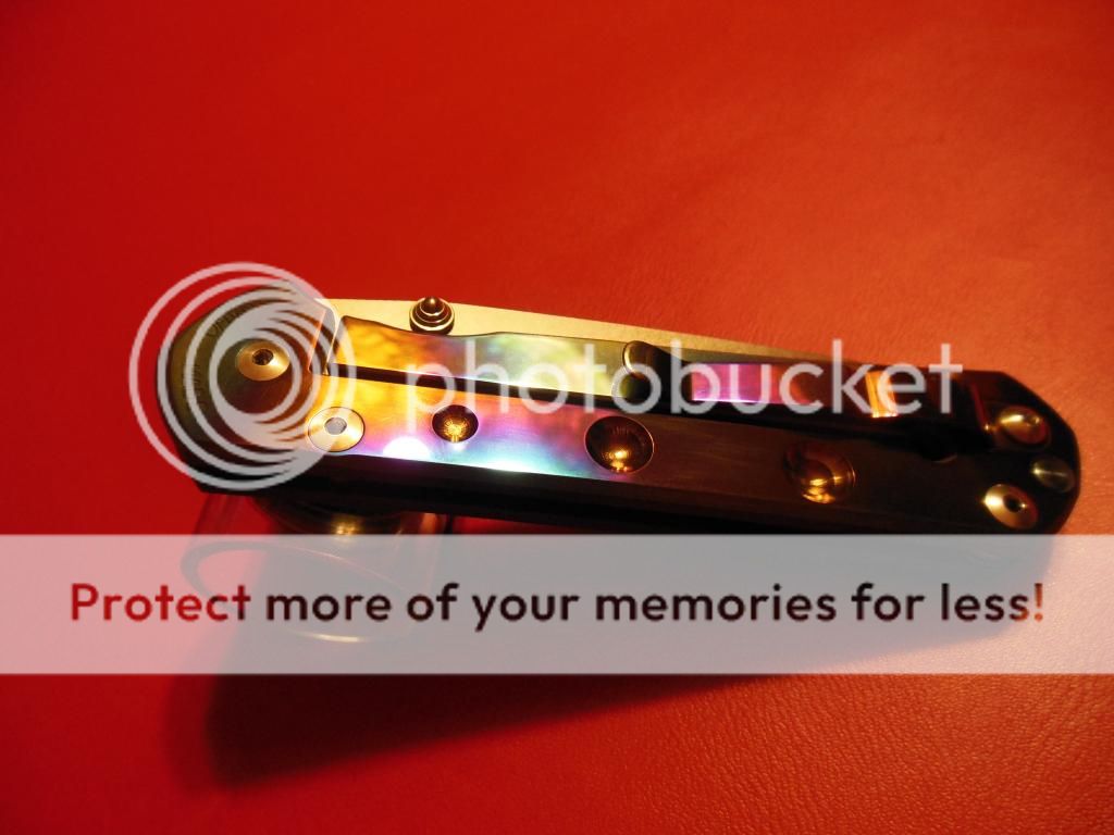

Apologize for not being a CRK. Maybe others can appreciate with sharing the initial idea to end result nontheless:
Slightly modified stage:
To these:
Chamfers under different reflection, disappeared as an optical illusion, along with a slimmer look for the actually wide blade:

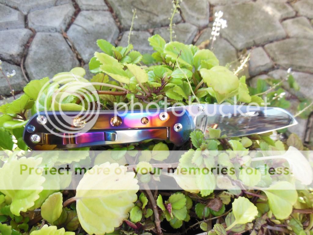

Again trying for an "objective" comparison, for those who care.

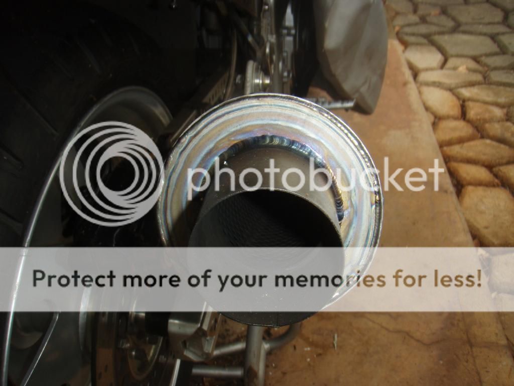

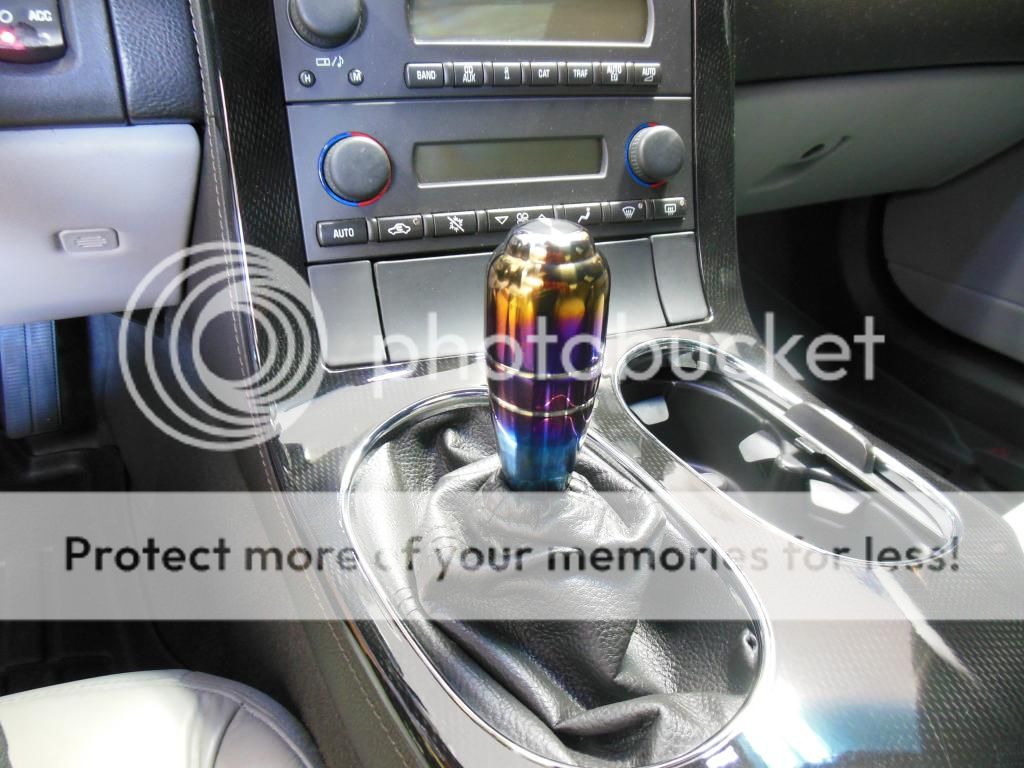

Heat ano'ed finish, time tested on a few homemade titanium parts on my 1990 1000cc crotch rocket, my DD up until 2009, only occasional for the time being:

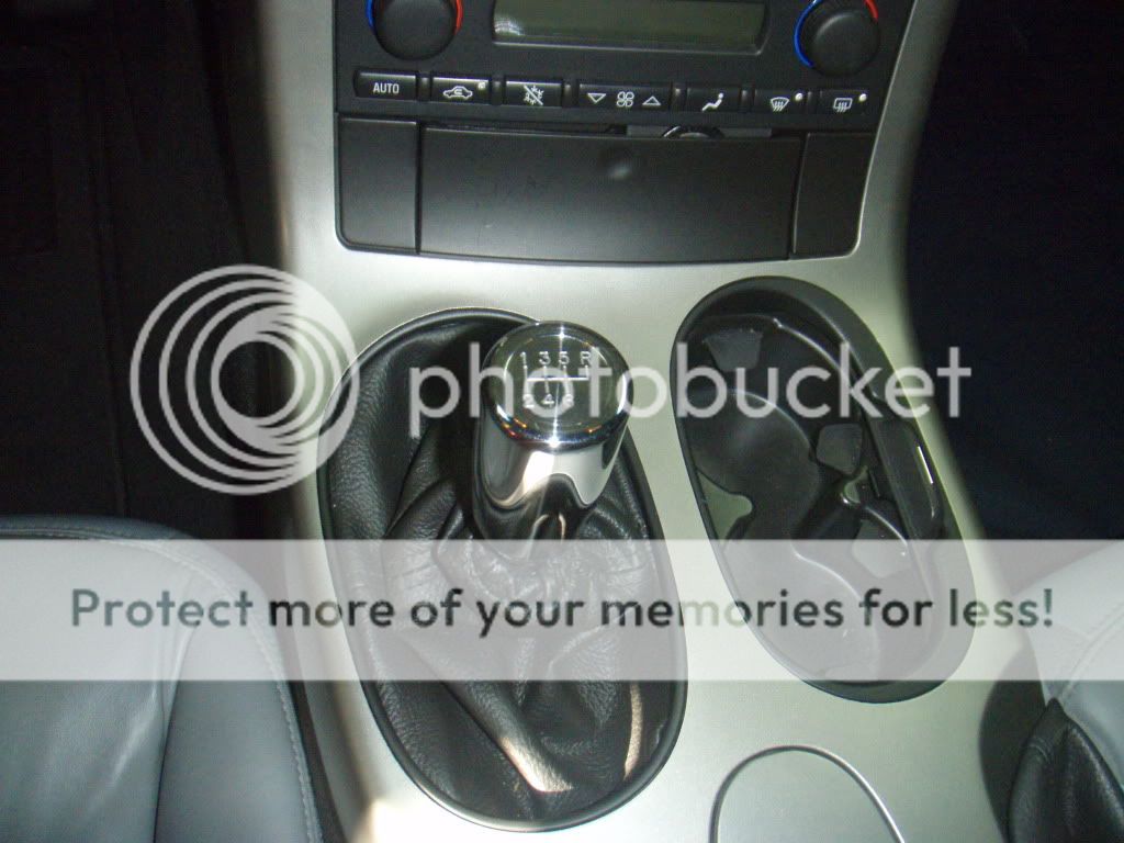

Additionally, no discerning wear on titanium shift knob, requiring frequent touches, to take advantage of my Corvette's custom modified 4:10 rear end:

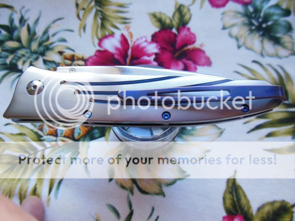

When compared with my recently acquired William Henry's electro ano'ed pocket clip, wear is similar to most electro ano'ed thumb studs, most rationalized as character marks:
Less than 6 months old. William Henry was never carried, wear on pocket clip edge is from hand fondling.

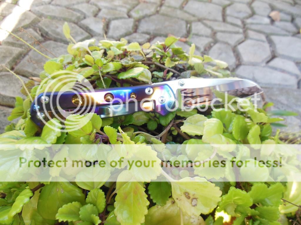

Unfinished RIL was an itch for me!
Need driven, I finally got a small dab of welder's mud from my generous friend. After mud covered mirror finished RIL's blade contact and the detent ball, apply control heat, then quenched - intentionally - to prevent detaching detent ball and to mimic electro ano's wear marks(particularly at the foremost handle slab tip, tip of pocket clip and the area directly under the pocket clip - as if frozen in time - the worn look!):
So...it is not something new discovered. Rather, applying simple trade knowledge accumulated over decades. :)

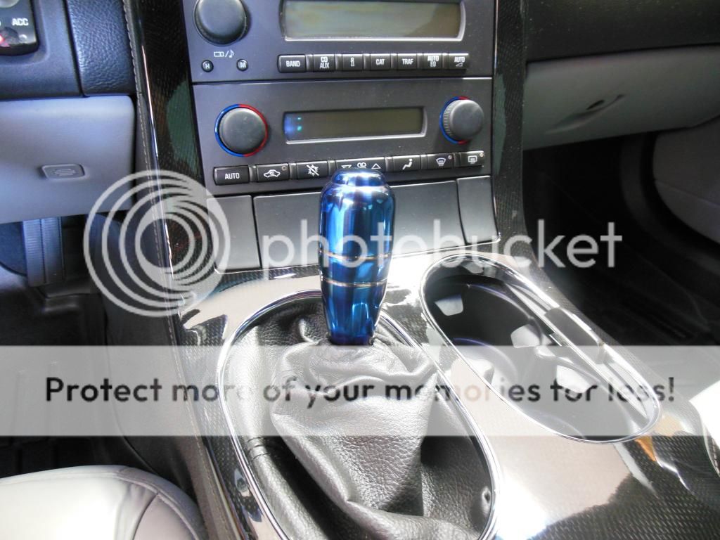

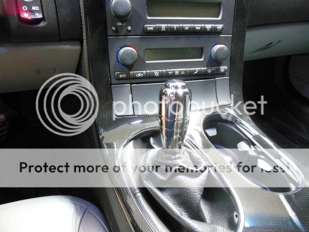

These stages of progression, involved different material and finish on the shift knob alone, can be use as an indicator for my constant quest to satisfy imaginations:
