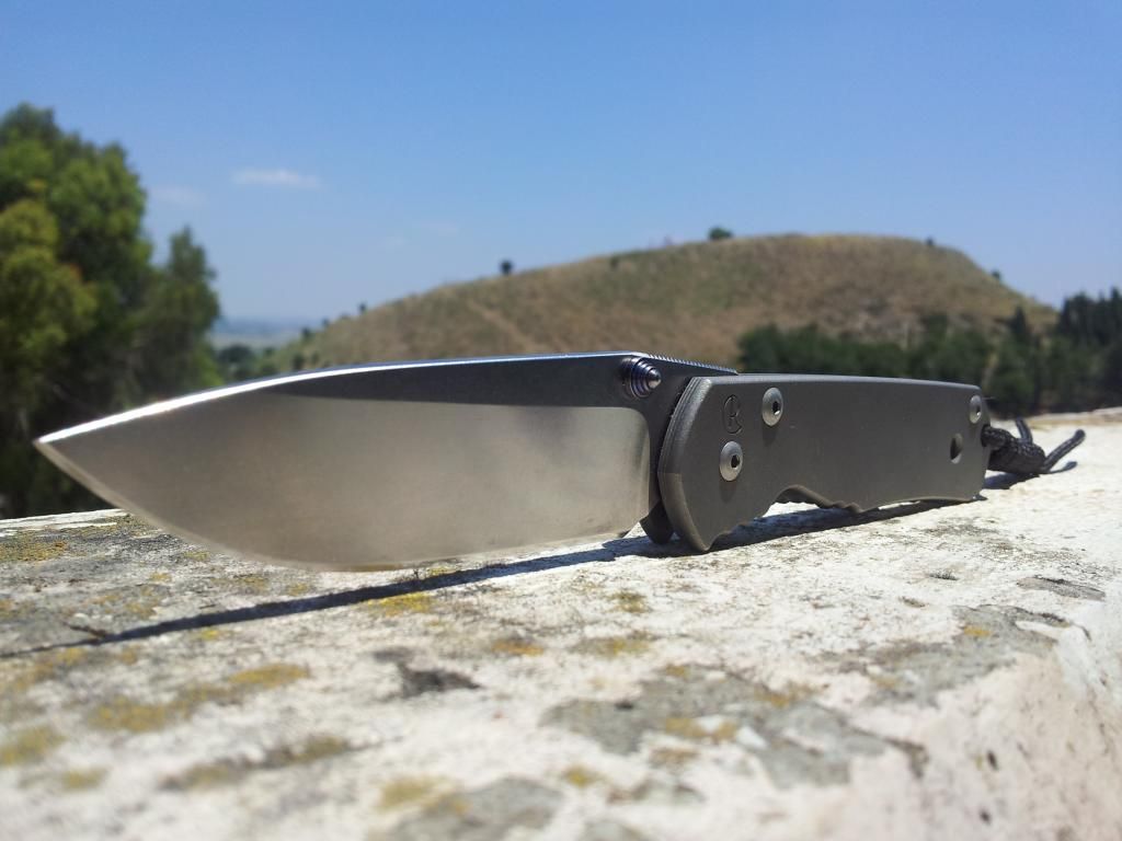

Vin- Thanks for the pic. You have one of the finest folders ever, right there. I HAD one! That's all you need!
