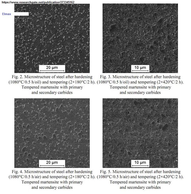

My # was extrapolated from (although article didn't has k390, which is similar to 10V): https://www5.kau.se/sites/default/files/Dokument/subpage/2010/02/39_533_547_pdf_17397.pdf
Do you have a source for that number? That's about double what I estimate.
MC + precip carbide would be more than listed in patent - probably in the range I extrapolated. If you re-look at those micrographs in the Elmax article (you posted a week ago), you would see CrxCy precip carbides easily double cv of Elmax. Spyderco K2 10V blade would easily be ~25+% cv.
May want to double check that number, Luong. https://www.google.com/patents/US4249945. Looks to be in the 15%-17% range. CPM 10V.
Good thread and topic, gentlemen. Very interesting. I have no experience with anything higher alloy than CPM M4 (and not a whole lot of that) so all of this is very interesting and foreign territory.
ok here is the micrograph of elmax in that article
10V has about 25% carbide volume. 10%V is mass fraction.

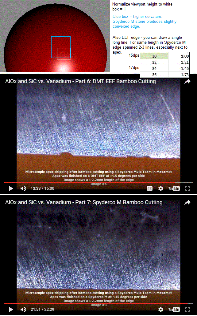

In any case, the footage from my latest round of tests has finished uploading.=:
[video=youtube;GBgVQLc9R6g]http://www.youtube.com/watch?v=GBgVQLc9R6g[/video]
[video=youtube;6FhWZsO3ef4]http://www.youtube.com/watch?v=6FhWZsO3ef4[/video]
These videos were made in response to criticisms of the earlier tests I conducted on pine and cardboard. In these tests I made hard cuts on bamboo choptsticks (which I attempted to do in a manner as similar as I could muster to the techniques used in Luong's video posted up-thread) using my Spyderco Mule Team in Maxamet as finished on a DMT EEF and a Spyderco M.

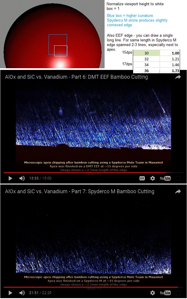

The results of comparing apexes set on a DMT EEF and Spyderco M in bamboo cutting were as follows:
There was no noticeable difference in the initial sharpness obtained off either abrasive. Both apexes were able to cleanly and easily do crossgrain pushcuts on newsprint at all points along the apex.
Surprisingly, the apex set on the Spyderco M resisted microscopic apex chipping dramatically and noticeably better than the apex set on the DMT EEF. Even assuming that the result obtained with the apex set on the DMT EEF was an outlier, this test still failed to produce any evidence to support the hypothesis that any noticeable negative side effects are produced on high hardness, high vanadium content steels from being sharpened on aluminium oxide or silicon carbide abrasives.
I will note that USB microscope images of the microscopic apex chipping found in the section of edge used for the test are included towards the end of both videos. The images graphically demonstrate that in these two tests, the microscopic chipping was dramatically worse on the apex set on the DMT EEF.
I will also note again, for clarity, that I have never argued and am not arguing now that AlOx or SiC are able to abrade vanadium carbides. My argument is only that, even assuming that AlOx and SiC cannot abrade VC, there does not appear to be any noticeable effect on the apex in use, at least so far as my empirical testing has been able to find.
Steel-Drake, Excellent testing & logical assertion :thumbup:
However test results went off the test premise/objective, showed something else. What you have shown have very real practical value but for wrong reason (IMHO). Whatever reasons (below) don't matter that much beside knowledge we seek. Which to say, in real life - Spyderco Mule Maxamet edge off Spyderco M stone is beyond avg sharpener & most users expectation of edge usability:thumbup:
OK, people, I am not nitpicking here... just point out what look like to me - which could be just an optical tricks in my eyes. My assertion: edge off spyderco M stone is effectively around 17.5 dps (conveniently rounded to this number to reflect the cutting edge gained 50% strength by steel volume). Therefore test videos have good value but not for intended test objective.
Can you please give a much more detailed explanation as to how to you are coming to infer that this is the case? I am not even agreeing or disagreeing at this point, I literally have no idea how you arrived at the conclusion that the Spyderco M apex is at a different angle?
Furthermore, assuming I was to retest an apex off the DMT EEF on these same chopsticks, if I deliberately raise the angle slightly to ~17 degrees per side, would you then accept the results as comparable to the Spyderco M test?
Since you are quite good at keeping decent sharpening angle, so 17.5dps was derived from shading technique (Phong in this case).
Sure, please raise EEF angle to 17-17.5dps and re-test. Appreciated.
I'm sorry, I still don't understand what you mean. What shading technique? How was it applied? Where would I be able to find out how to apply the same test?
I guessed the curvature by how much light reflected back from single light source. Look like the camera angle is about the same for both pics - so for same bevel angle, similar amount of light should reflected back and similar gradient (shifting shade from bright to darker). But here I changed contrast - easier to spot the difference. Notice - how much more drastic gradient in edge off spyderdo M stone. Normalize right hand corner light as pendicular reflectant (max light reflected back). Sure, this would be much simpler with a SEM but all I can do is guess via how light reflect back.
Imagine you are standing on apex and only a few micron tall, how far up the bevel you see? The further you can see, the lower the curvature... So map to EEF edge, you can certainly see further, right (because your eyes or flash light clearly show that)? Frankly, if you don't see what I am talking about ... Well , let's agree to disagreed.
