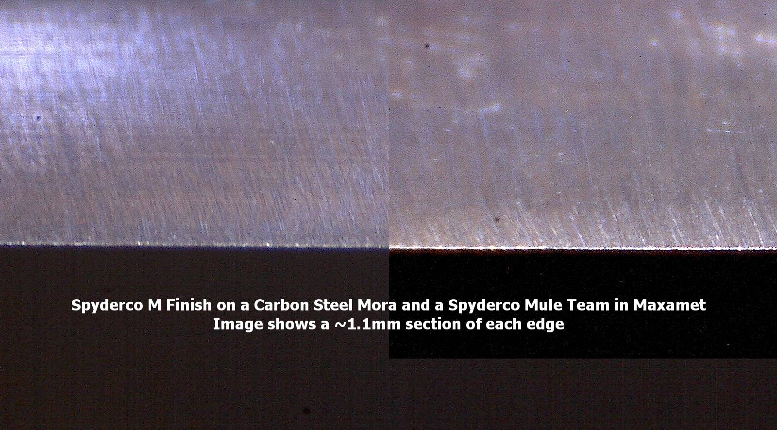

The apexes set on the solid sintered ceramics are better in the sense of having a thinner apex due to not being subject to the slight apex rounding that occurs when making edge leading passes on a friable abrasive with a slurry (i.e. due to the apex ploughing through the slurry), but that is unrelated to the vanadium content of the steel being sharpened.

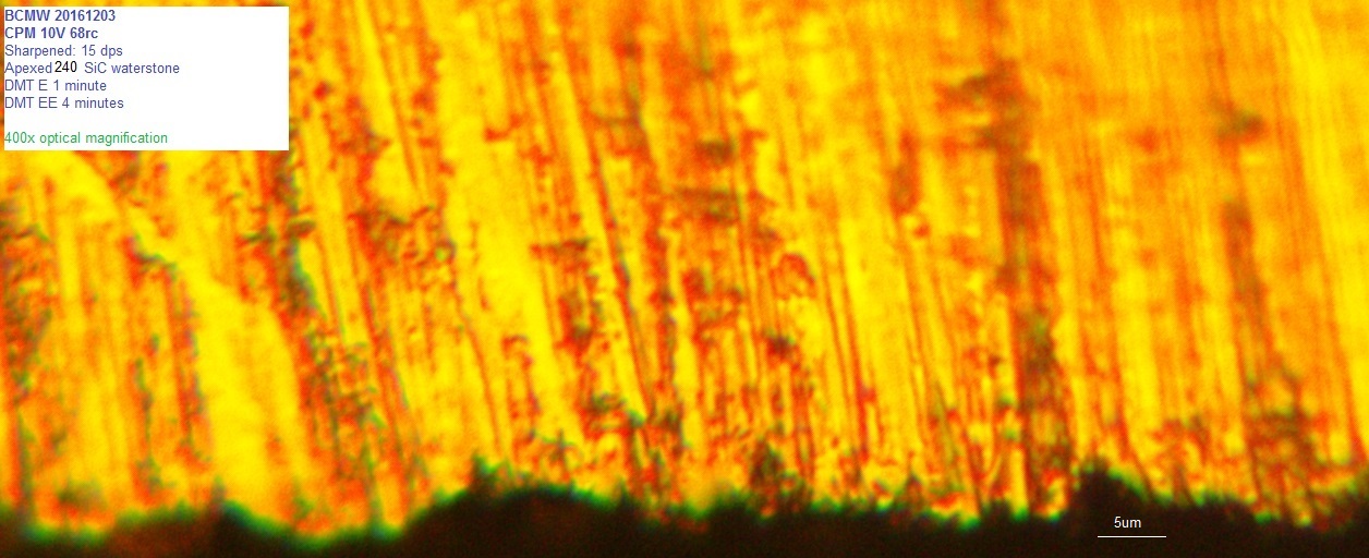

What I'm referring to instead is this: In the images Jason posted of 10V vs carbon steel sharpened on a Shapton Glass stone, it is obvious that the Shapton Glass stone had severe difficulties grinding the 10V, yet when Jason repeated the process with a muddy King 1000, the scratch pattern on 10V appeared functionally identical to that on VG-10. This matches my own results where soft and muddy waterstones have no trouble fully applying their scratch pattern to high hardness, high vanadium content steels.
Both those results appear to suggest that waterstones that expose fresh abrasive rapidly in use can grind high hardness, high vanadium steels, but that waterstones which do not expose fresh abrasive rapidly in use will struggle to do the same. And, that would make sense, of course, since fresh abrasive should grind better than heavily worn abrasive.
Now the contradiction is that sintered ceramic abrasives do not release fresh abrasive at all, and yet I found no trouble in getting a Spyderco M to grind Maxamet:
What I am trying to understand is how it can simultaneously be the case that strongly bonded waterstones can struggle to abrade high hardness, high vanadium steels while solid sintered alumina benchstones appear not to.
I think a big part of the problem is the magnification level you are using as a benchmark is misleading. 400x is scraping the bottom of what is needed to see the edge for this sort of study, and that just for speculation. 1000x is the start of useful range. Anything under 400x optical is not really useful in my experience and is just as often misleading.
From there, with or without high powered optics, all we have is cut tests. You seem to be getting good results with your selection, this is not a universal finding by any means.
When I use non-super abrasives I find an upper limit to how clean I can get the apex - in the range of the carbide size - I've tried to buck this with AlumOx and SiC but have been unable to do so, verified at 400 and 1000x respectively. Doesn't mean it won't cut acceptably - I managed to get a hair-whittling edge and a BESS score in the teens with silicon carbide on s100v. Done with diamonds I find I get a better cutting edge and it lasts longer too, this effect really kicking in at ANSI 800 or higher.
The images I was referring to Jason having taken which show an apparent struggle for a Shapton Glass 1000 to abrade 10V while a King 1000 appeared not to were taken at similar magnification to my own USB microscope images. I was also wondering about the scratch patterns left on the edge bevels, which appear to be plainly visible in the USB microscope images I am referencing, rather than anything occurring at the apex (where I agree much higher magnification would be required).
I will see if I can reproduce the results Jason got on the edge bevel of a blade in 10V off his Shapton Glass 1000 by using my King 4000 without any slurry at all, and without re-cutting the surface prior to use. For clarity, this is an offshoot question from the main topic of this thread that I'm curious about, and I did not mean to imply that the microscopic images taken by myself or Jason could tell you what was occurring at the apex specifically.
If you have or know of any microscopic imagery relevant to this topic taken at 400x or 1000x magnification, could you please post it in the thread or link to it? I would very much be interested in taking a look at it.

Found my calibration ruler for my metallurgical microscope. Added scale to to Pic above.
