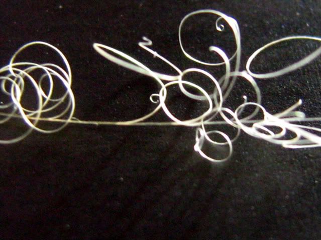

My DMT xx-fine keeps getting better the more I use it, it's break-in process is taking a long time but its benefits are starting to shine through. Knife pictured is a spyderco military CPM-S30V, after the XX-fine the edge was finished on a leather strop with .5 micron diamond spray.
If you use diamond compounds and have yet to try handamerican's diamond spray your really missing out, this stuff is amazing!

The other day I picked up some ceramic kitchen knives from HF, one was a paring knife and seemed kinda dull so I figured I would try and sharpen it on my diamond stones. I didn't get the results I was expecting but it did help out my finer diamond stones a great deal. My DMT XX-fine has taken a very long time to "break-in" and after using the ceramic knife I think the break-in process is almost complete.

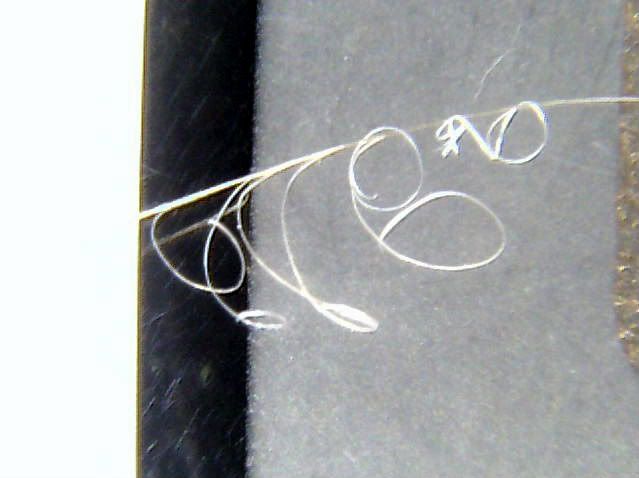

After the main curels of hair I was able to make some very fine curels that you can see near the edge of the knife.
I wanted to see just how many were there so I got out the micro camera and to my suprise there was 7 :p

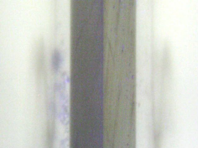

Here is a pic looking down on the edge.
