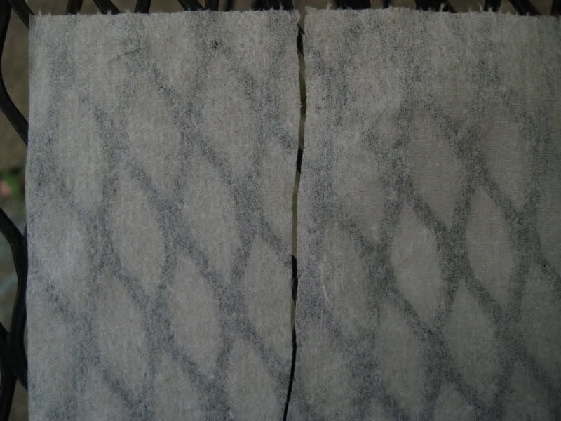

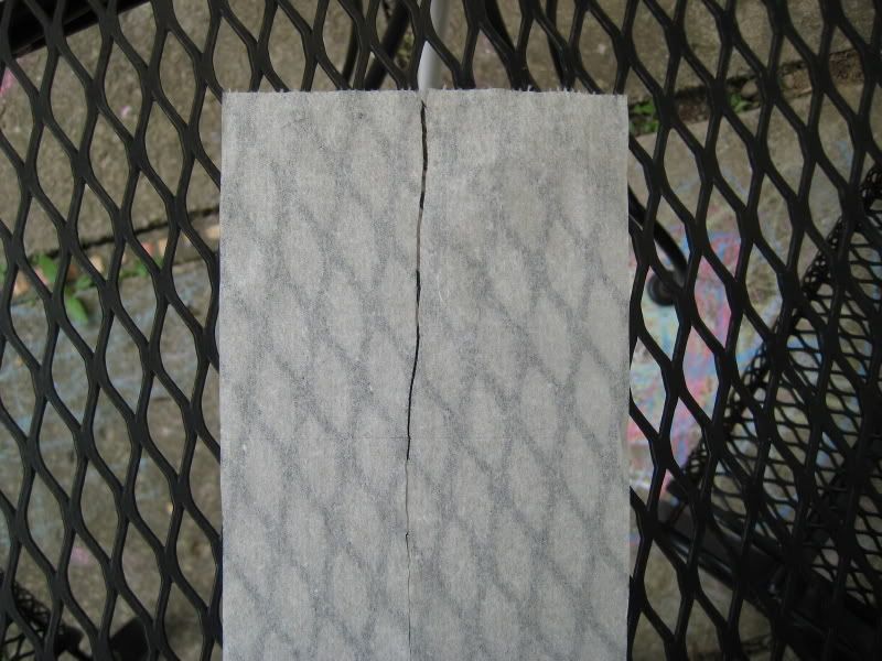

Uncle Rukus, is this the kind of thing you're talking about? This is single ply (too cheap to buy double :rolleyes:),
I find I can't get a perfectly straight line.

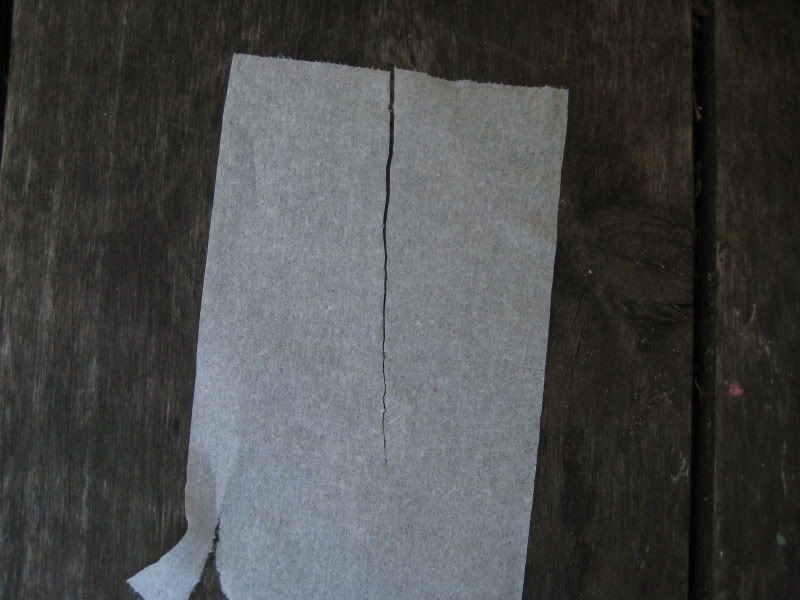

Here's a different one. The start of this one almost looks like a tear.
Same one from farther back.

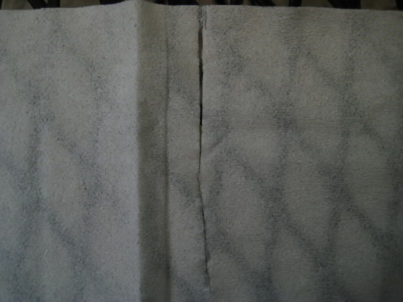

Here's a 2-ply kleenex:
