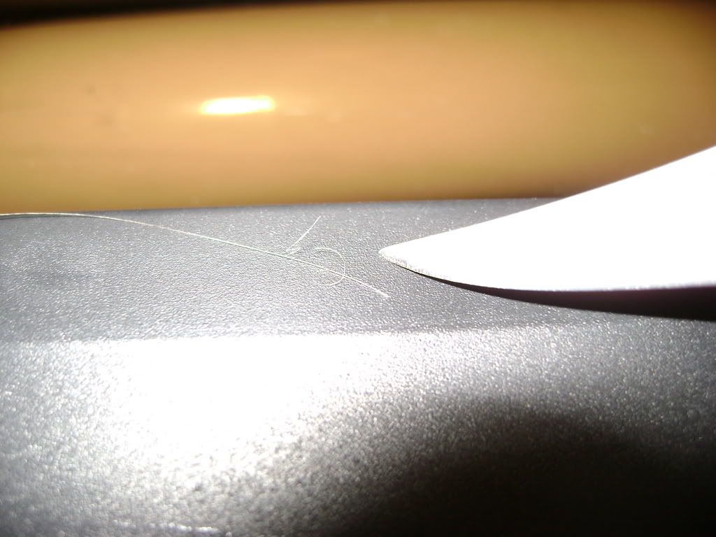

$2 Imperial Schrade I got in the mail today, Norton economy silicon carbide, coarse (coarse Crystolon is 100 grit, I guess this is the same)
Wow! Now the only thing you did not sharpen - spoon or nickel!
Did you do this with coarse abrasive only? Is it whittling hair all over edge or on some lucky spots? What is you observations - I was thinking that only green rouge can do this? but you are saying it is 100 grit?
Thanks, Vassili.
That took several attempts. The whole edge should have been about the same, but I worked with just the last quarter inch or so. The edge grabs so aggressively it would cut through the hair pretty easily before producing a curl if I didn't focus as best I could. That is only about half the hair, the split end is where I began to whittle it, then the blade slipped out. When I attempted to make the shaving longer, I cut through.
I did this because of something Uncle Rufus posted in the strop thread. I made extremely light passes on the coarse stone, just like I do when finishing on the strop. This was actually running through my head the day before he posted it, the ability to refine the scratch pattern by reducing pressure instead of reducing abrasive particle size.
