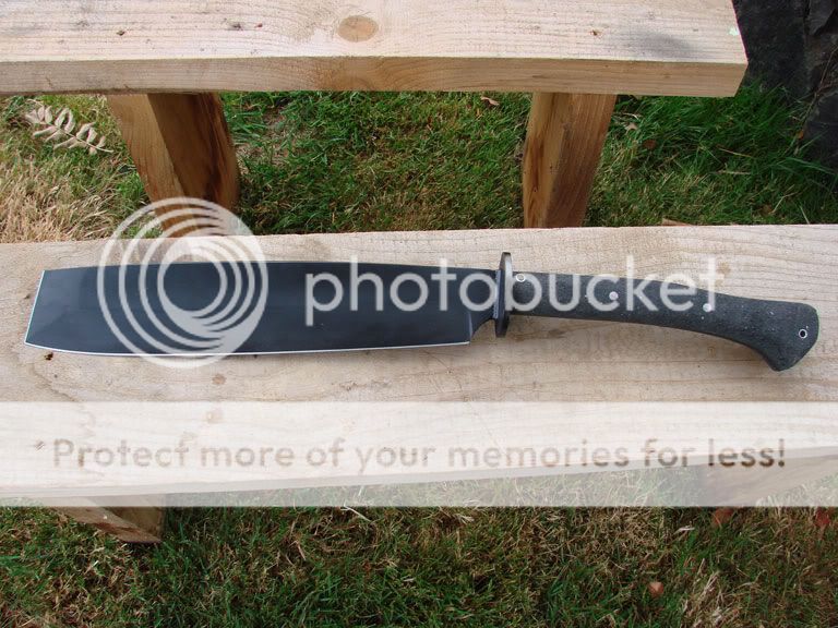

Here is another V2 Chopper that I guncoated the blade and guard black to help with rust protection.
Almost 24" overall with a little over 13" of blade. Differentially heat treated 52100 .200 thick. Dan

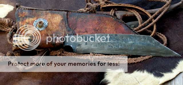

Iron is from an old truck leaf spring, forged in the charcoal forge and quenched in brine water. Bolster is a scrap copper pipe fitting.
Handle is Maple stump from a dead tree on our place with a rawhide wrap.
Sheath is some of my deer rawhide over boot leather with a simple concho made from a snuff lid and a antler button from the same deer. .....Randy

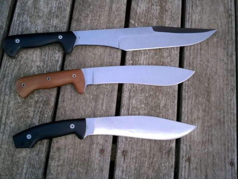

The largest I have done so far:
12" OAL 7" Blade
36" hollow ground 5160 with about a 1/8" drop clip and a recurve (not very apparent in the pic)
Bead blasted and blued with Linen Micarta
Kydex by neighboring maker Robert Scheppmann
David Sharp
Sharpwerks

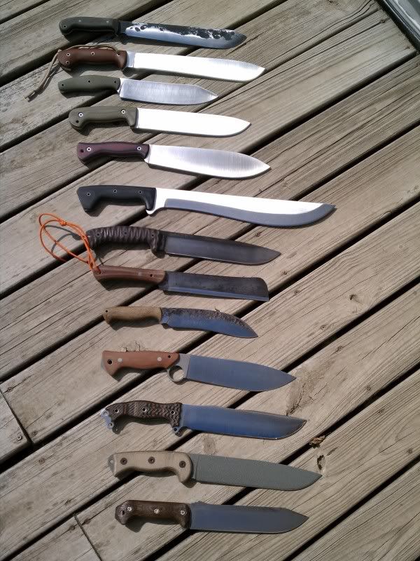

I have post these two before, but I thought I would add them to this thread as they fit the theme
Recurve Camp
Bowie/Chopper
