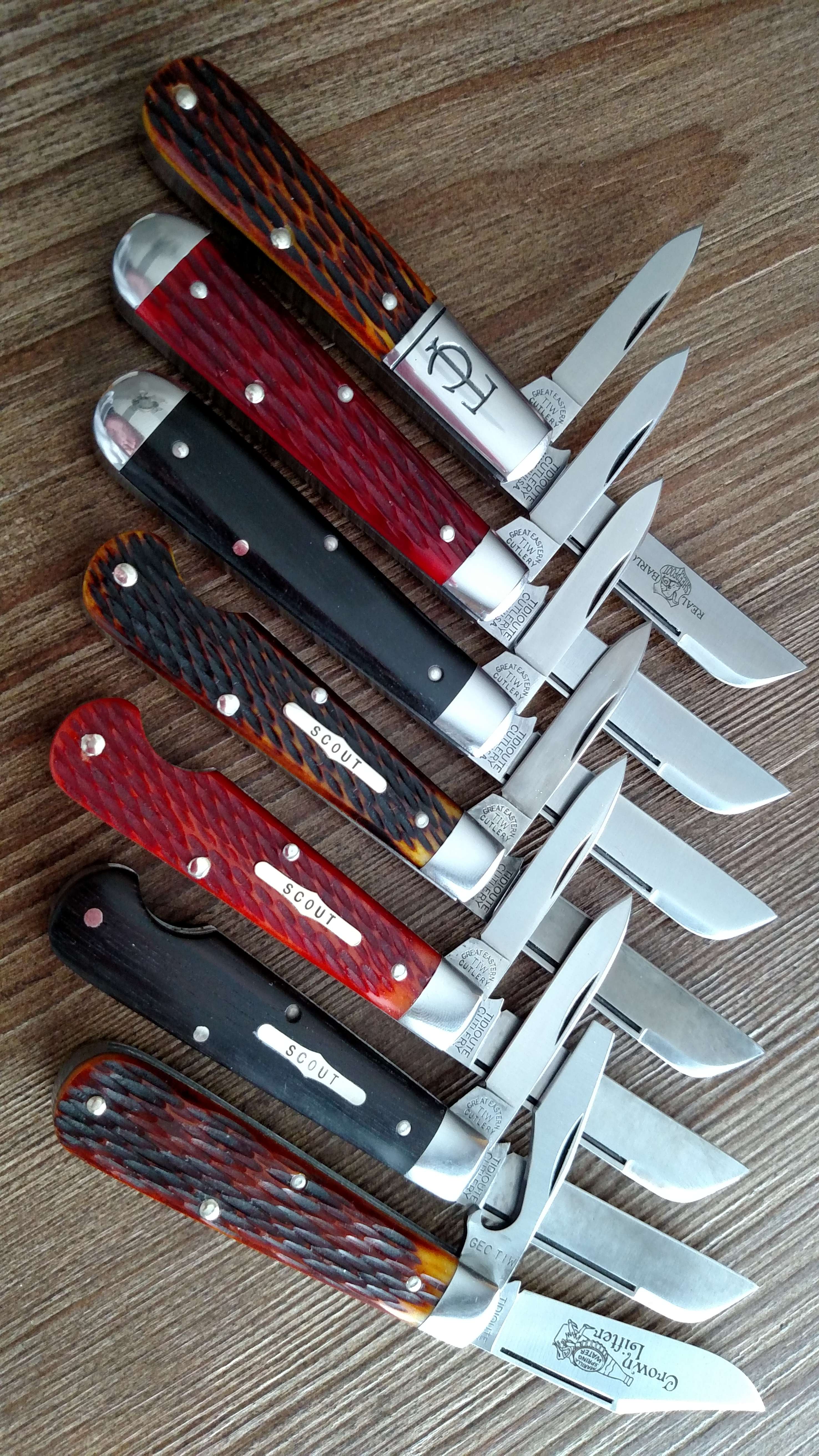

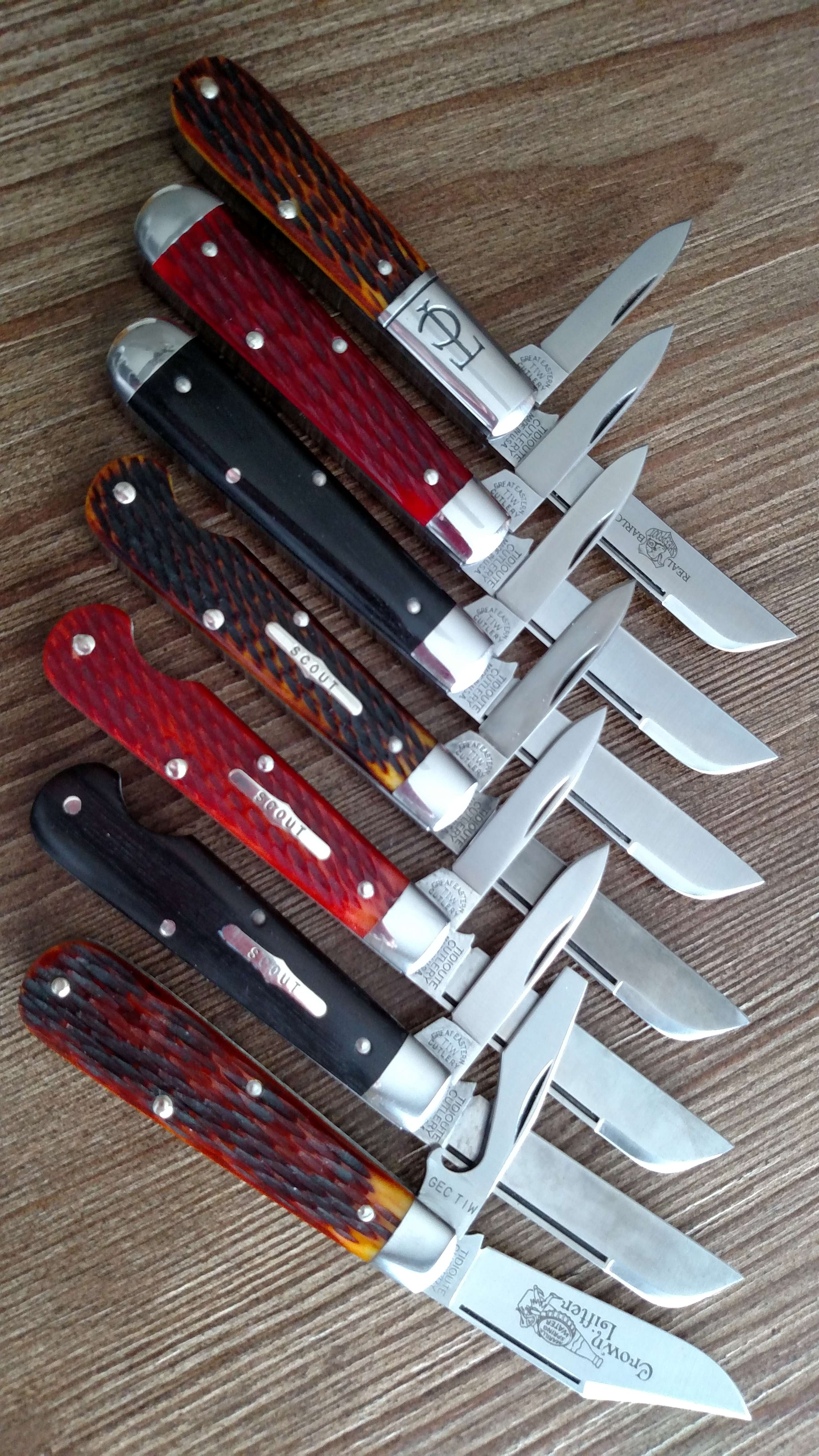

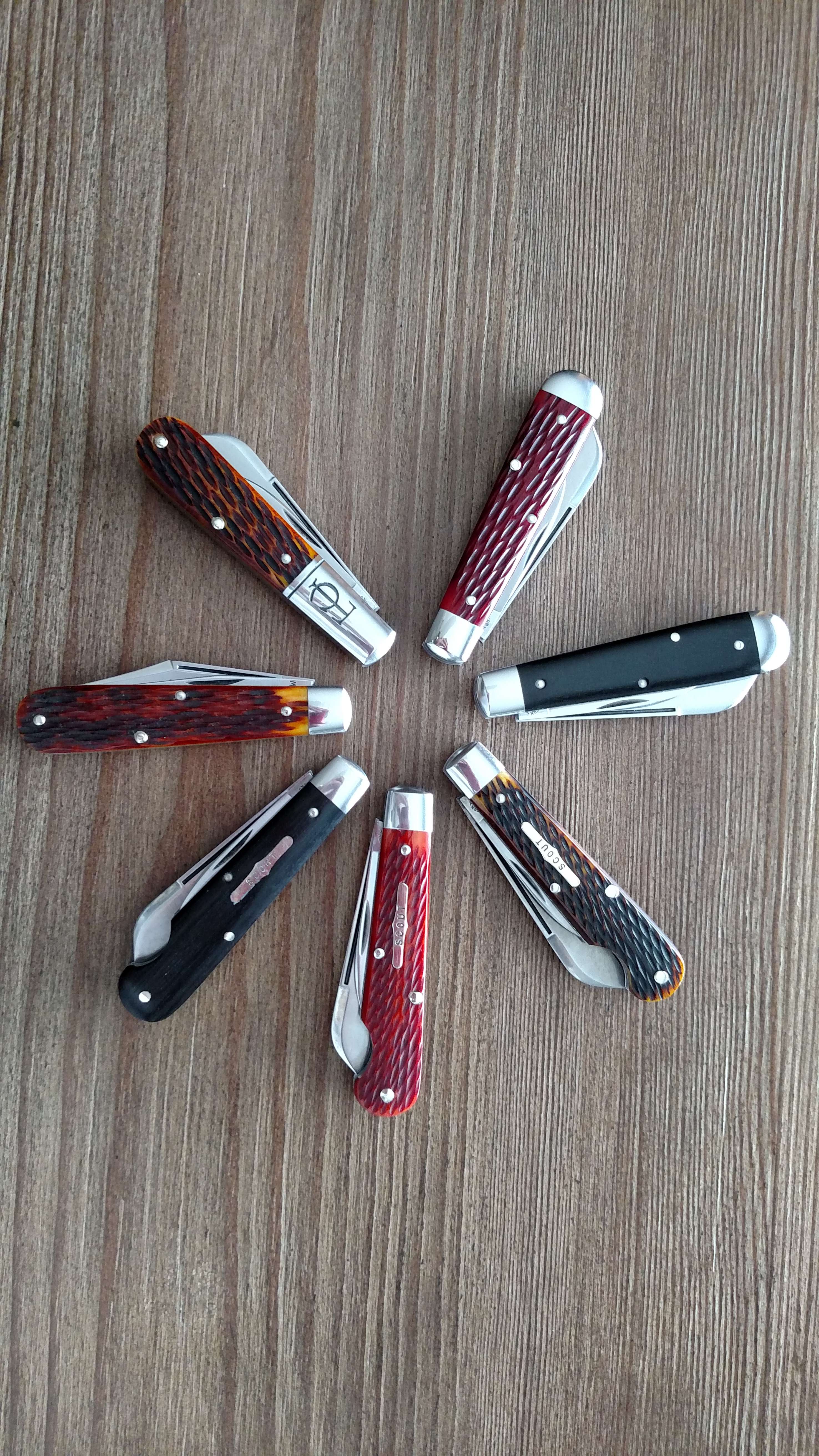

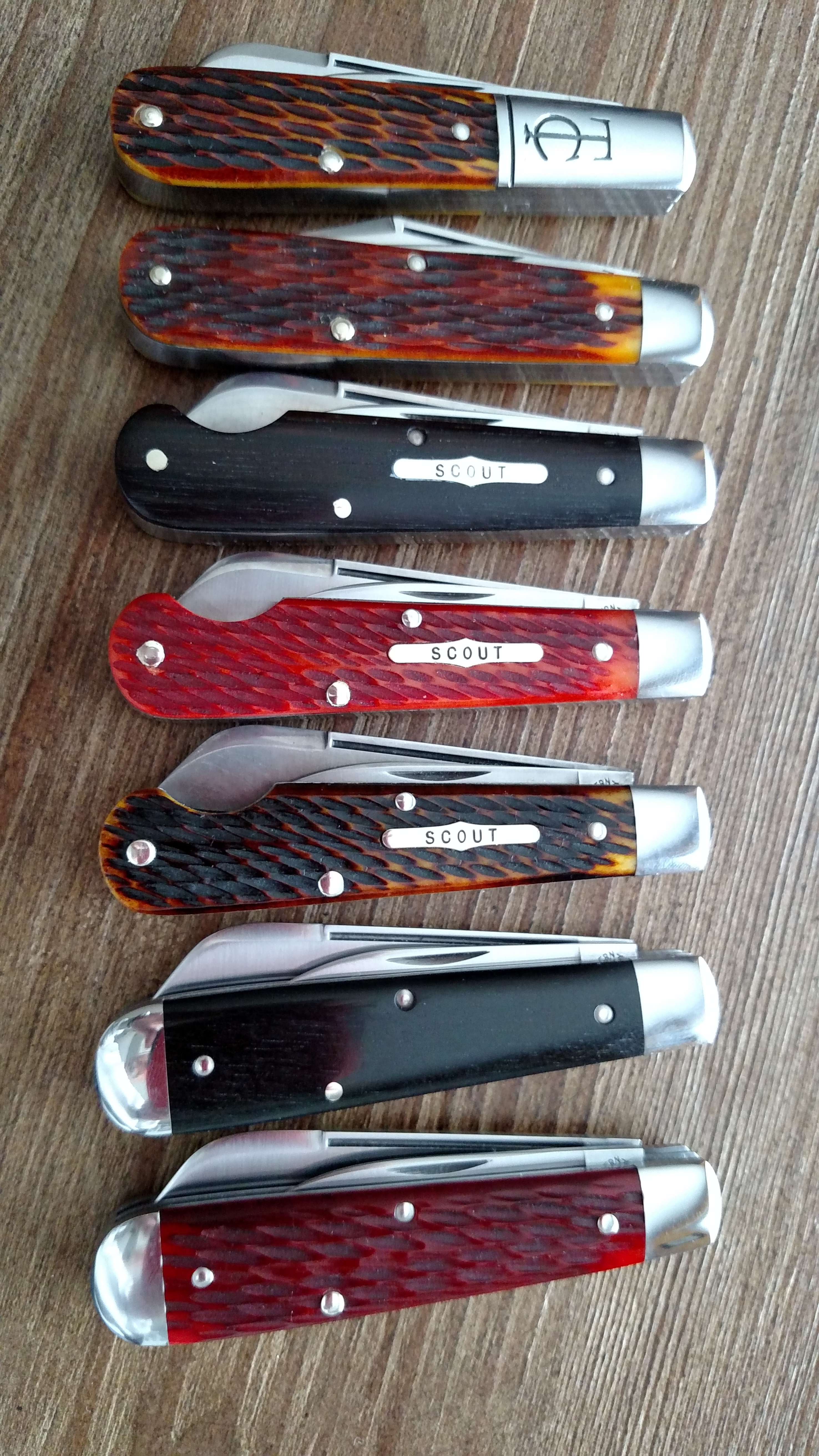

PAUL! You have some great #15s, my friend! I never even knew GEC made a Scout in red rust bone.
Another #15 mandala! :) :thumbup: WOW Paul, that is a sweet bunch! Congrats! If that Rust Red Scout ever looks at ya funny, you know where to send it :)
Thanks David, you inspired that picture:thumbup: You will be the one I contact if the Rust Red Scout needs a new home:)
Thanks Perry, I had the Nifebrite Scout as well but unfortunately parted with it:o
Paul's got game today! :thumbup:
Bob, I'm riding the coattails of my Irish;):thumbup: I fear Saturday night and will be rubbing the TC off the bolster of my lucky knife hoping for another victory---we will be entering the land of GIANTS:eek:
