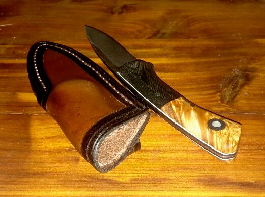

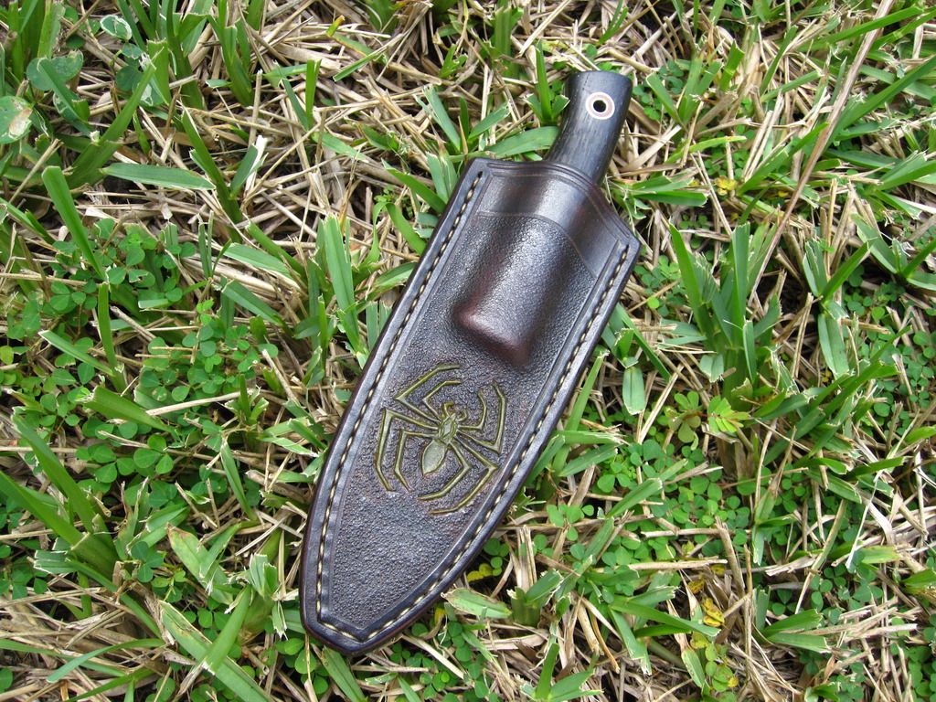

I've been carrying my Handmade hiking buddy in a Production model sheath. the only problem w/ this combo is my 3/32" TT Handmade is much thinner than the 1/8" SFT Production model. Yesterday i had the knife slip out of the sheath, luckily it hit carpet and no damage occurred. I decided to redneck mold the sheath.

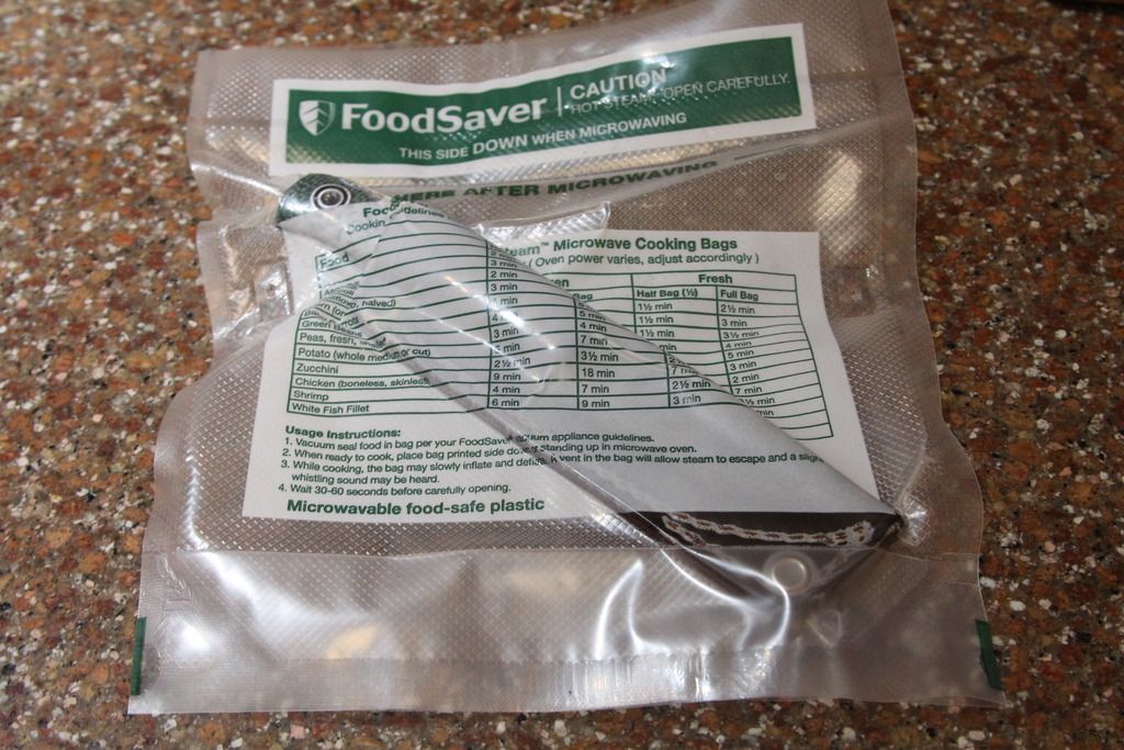

I coated the steel in oil and wrapped it in plastic wrap before inserting it into the sheath. Then I pulled out the Foodsaver vacuum sealer.

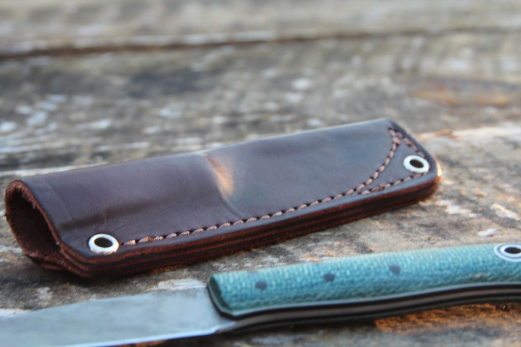

I let it sit a few hours last night and this happened.....
it provided a much tighter fit & i am happy with the results
Gus...I want this! Seriously! Beautiful!
WOW, that's pure awesomeness right there [emoji7]
That's exactly how I feel about it! Come on over!

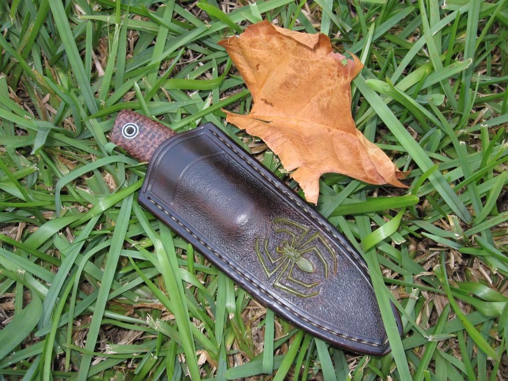

Tmet, I have a beautiful Rick Lowe sheath with almost the exact same textured pattern as the one you've got in your top pics. Mine is black...for a bushboot. It's a great textured sheath...something a bit different. Very nice combo!
