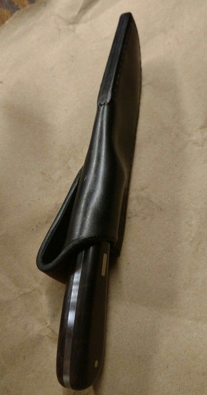

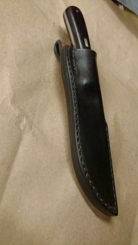

Thanks Mack, I went with black to see how it would look. What do you think, black or an antiqued dark brown?
That looks really good John, what brand dye did you use?
I like the black but antique brown sounds better to my ears. Probably depends on the grain of the blackwood. The blacker the wood the blacker the thing you stick it in.
Thanks Scott, I'm slowly battling the leather nemesis. I used a batch of vinegaroon I made with steel wool and vinegar, neutralized with baking soda and water.
Ok, I'll go with dark brown, I may try blackening the outer edges underneath to give more of an antique look. Kind of blend it in towards the center if that makes sense.
I've tried a lot of different dyes and for black and edge coating I think I like Fiebings cordovan or chocolate brown leather dye the best, I have used Fiebings USMC in the past but that seems to have a slight blueish hue to it in the sun light, so I switched to the dark browns if I want something to be absolutely jet black I put the USMC on then go over it again with one of the dark browns.
I think I might try some vinegaroon for the edges and inner parts of the sheaths like inner part of the belt loop.
It's an instant black thats for sure. Kind of amazing how fast it works. The second it's on leather it turns black as coal. I was having all kinds of problems with dyes bleeding (my own stupidity, I wasn't wetting the leather first and using waay too much dye), that got me turned onto vinegaroon, since its a chemical reaction and not a dye, it can't bleed. Since then I've learned to dye without all the bleeding (Tim straightened me out, he does some really nice dye jobs).
Just white vinegar and steel wool? Do you neutralize with baking soda after you turn the leather black or before you put it on?
I read all kinds of recipes to make it and a lot of them are way more difficult than it needed it to be. All I do now is put regular white vinegar and steel wool in a baby food jar, hit it with a heat gun as hot as you can get it,mix it up a little, and it's ready the next day. Really it will work after a couple of hours, but it seems to blacken better the longer it sits. I used to strain it with cheesecloth and get it clear, I dont even do that anymore, as long as you dont shake it up, everything will settle to the bottom and the top stays clean.
When I'm gonna apply it, I mix up a cup of water and baking soda, and have a cup of clean water so they're ready. Wipe on the vinegaroon, wait a couple of minutes and then really soak the area down with the soda water. I let that sit in for a few minutes and then clean the soda water off with clean water.
If its not neutralized, it will eat the leather and stink like vinegar. I've never noticed a smell after neutralizing and never had a problem with it eating the leather. Another thing is make dang sure it doesnt touch any leather you dont want black, because there is no going back. After that I sno seal it up under heat,and topcoat it with the Bees/Ren/Sno mix.
