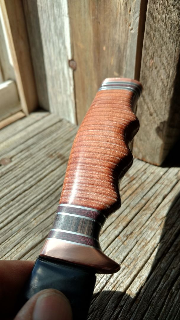

Ohay, it's got finner-grooves; neat-o, daddy-o! :cool:
I hope there's enough of them!
Sanded to 1000 grit, seems to be the point when they start to pop.
Everything will darken up and get that deep look after the buff.
Comments and opinions welcome.

Looking great Johnny, I think's youz got this knife mangling thing down. :thumbup: One you hit the leather with sealer and buff it that is going to really pop!
I'm seriously impressed. You are really nailing this knifemaking stuff.
Thanks Mack, I appreciate that:thumbup:
It's taught me patience, something I could have used a long time ago.

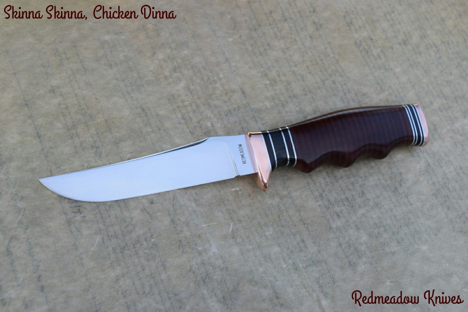

Looking really good, what did you decide on for the final finish, snow seal with bee's wax?
Yeah, I'm gonna try to melt some together tomorrow. Sno seal is supposed to already have beeswax in it, we'll see how it goes. Mixing might be a disaster, never know. I'll post in here if it works out or not.
I'm anxious to see how the alternating thicknesses are gonna look, so far I like it.

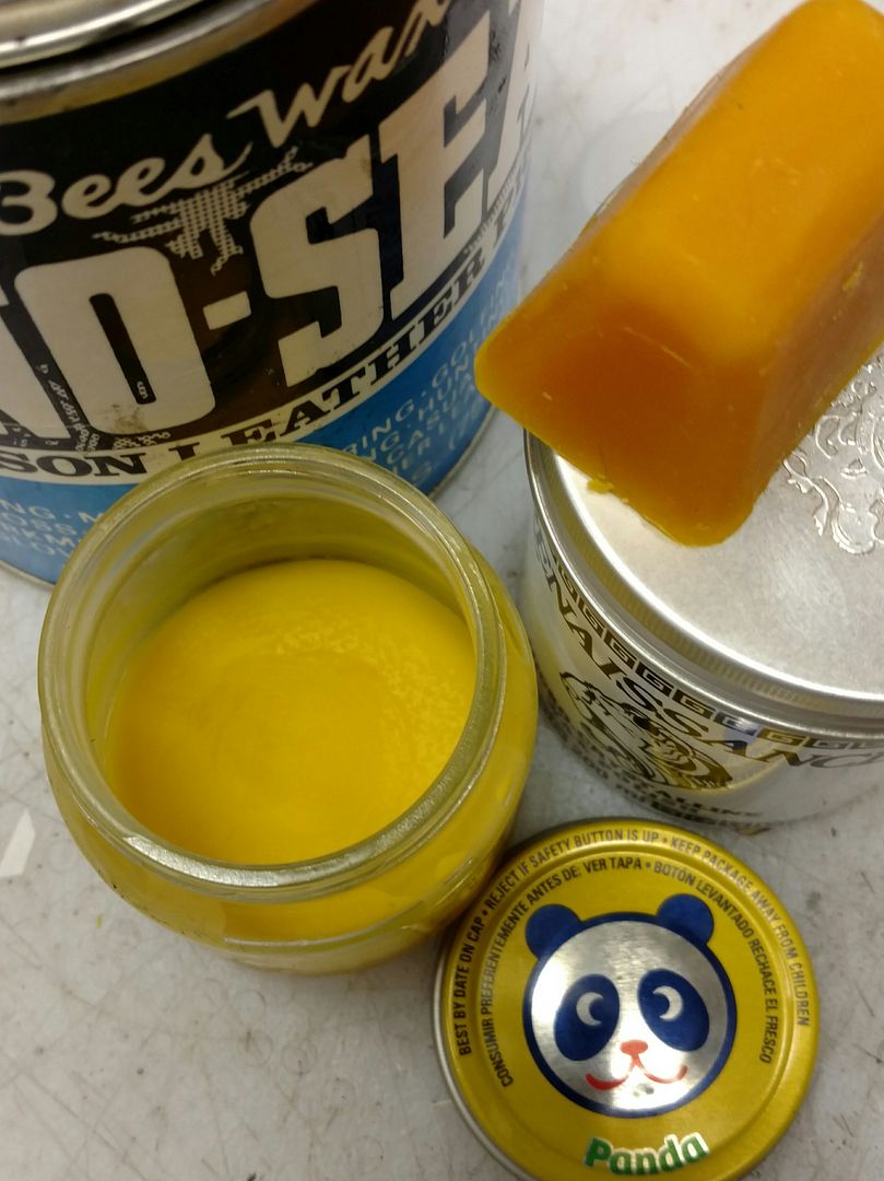

You're probably right Scott. I'm curious about the consistency, it will probably harden the same as wax, maybe it will be easier to spread. I just mixed about two tablespoons of pure beeswax with two tablespoons of sno seal, and threw in a teaspoon of renwax in a double boiler. I was expecting the Ren wax to settle or float, but it all seemed to mix evenly, had that crystally look throughout. I thought about throwing in some linseed oil, but was afraid of getting that smell in the handle.

Well it's a lot softer than beeswax, and looks like butter. Baby food jars are ever handy. It looks like it mixed well judging by the color difference, that's pure beeswax from our hives on the Ren wax.
