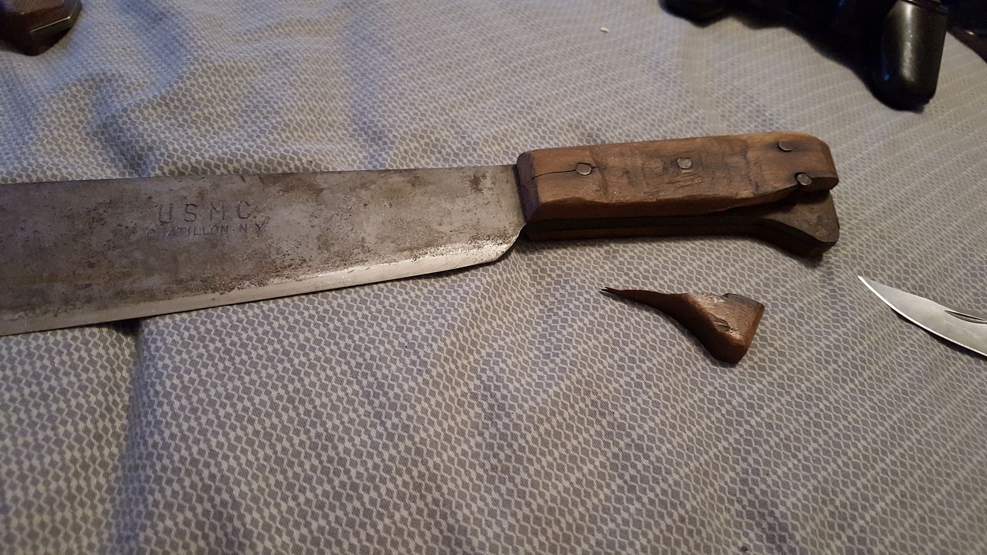

Tools? Saw. Sandpaper. More sandpaper - unless you have a wood rasp. Brass rod. Hammer. Two part epoxy. Tape or clamps.
And some wood.
Oh, and a screwdriver to pop the rest of the current scales off.
Edit : see below for better pin option.
The original wood is apple wood. Do a search on "USMC Bolo applewood" for links to other postings about this knife.
As gleaned from an article by Mr. Frank Trzska:
For unknown reasons, the original specs for these knives called for apple wood handles. This was the only apple wood specs he ever found.
In a letter dated 08 Dec 1941 (the Monday after Pearl Harbor), John Chatillon & Sons requested that birch, beech and maple be allowed due to the difficulty in locating apple wood.
So you could use any of the 4 woods for replacements. Also the pins are un-heat treated steel pins. The mild steel rods at one of the big-box home improvement stores would be a cheap source of appropriate pins for re-handling "authentically.

I might try that, do you guys have any tips For getting the handles off in one peice? You can kind of see it in the picture, but who ever this belonged to had carved the handle to fit their hand, I'm assuming while in theatre, and I would like to keep that if possible
Can you tell if the scales are glued on? If they aren't glued, you might be able to drill out the pins and they basically fall off.
Spike: Maybe just get some decent epoxy, glue on the broken piece and see if you can get some under the scales....maybe drill the pins as has been suggested. I get brass pin material at my local ACE hardware. If you've got good epoxy, the pins are almost unneeded....mostly for shear strength. CA (cyanoacrylate - superglue) might fix the crack, though it's not very elastic or shock resistant (in my experience) like a good epoxy. Do a little research, go slow and you should be good. Better to have the satisfaction of doing it yourself (IMO) than sending it to someone who doesn't really have the same emotional investment in it.
