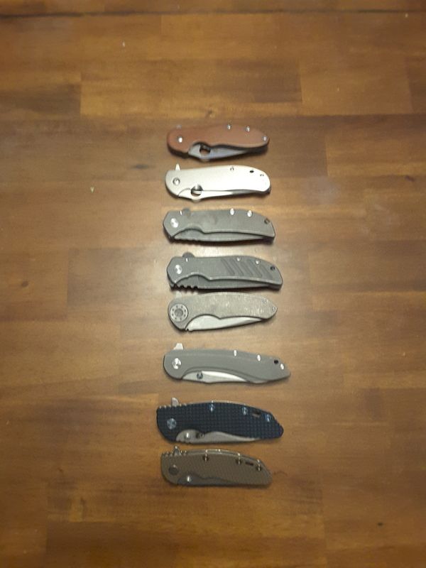

The bearing race washer issue really came to a head this year as far as I can tell. In previous iterations, I'm not sure it was ever clearly determined to be an issue on previous models, even though I understand that it mechanically is one.
I think it's an issue on all the flippers implemented this way, but it's most evident on the ones with lighter blades.
I'm not a maker or engineer, but my going theory is that the ball bearings are indenting the bearing race washer if the pivot is tweaked beyond a certain amount. Some people have been able to correct it by basically mashing the pivot down and carving out a groove in the washers so it's infinitely dimpled, so to speak. I've suggested using a grooved bearing race like Kizer and a few other companies do. This keeps the ball bearings at a specific distance from the scale as there is nothing moving to wear down on the shoulders of the groove, while letting the ball bearings roll freely. Grooved washers are much thicker though, so the tolerances in the pocket need to be accounted for. I think anything that keeps the ball bearing cage from moving into the handle scale will help solve the problem.
Forgoing the race washer entirely will eventually lead to lateral blade play when the ball bearings wear into the titanium scale unless the pivot pocket is sufficiently hardened (heat treat?).
