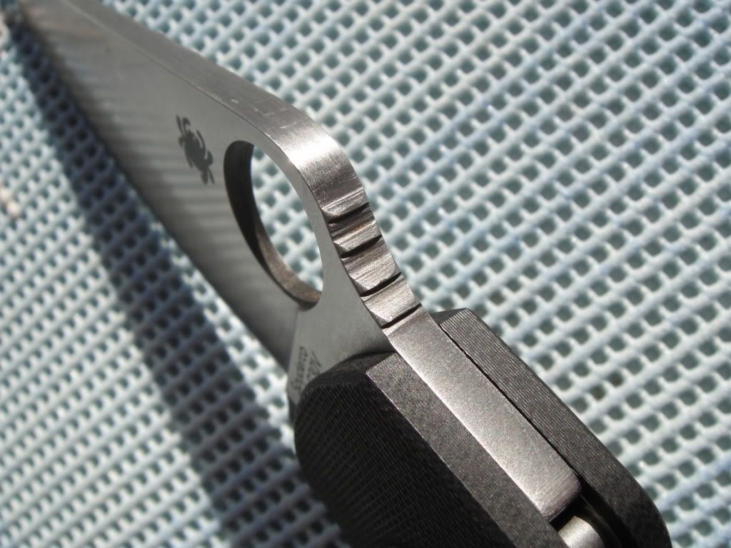

I posted this over in another thread, but thought I would share these pics here to see what people's opinions are. I have two PM2s. One is a black/satin and the other is a digicamo/black. I suspect that the black one is a fake and would like to see what others think. The knife looks really good, except that when you take it apart, you can see that the lock-side liner is laid out very differently from the digital camo one. The lock opening in the G10 is the same on the two knives, but the lock itself sits very differently in the cutout. Before I started reading about all of these counterfeits on BF, I assumed that it was a design change implemented by Spyderco at some point in the PM2 run. At another poster's suggestion, I weighed the two knives and the black/satin weighs in at 3.77oz. The digicamo/black weighs in at 3.83oz. The official weight for both is 3.9 oz on Spyderco's site.

Here are some photos that might help clarify the issue. Also I counted the jimping just now and there is one less jimp(is that the singular?)on the GREEN g10. The Camo P2 is genuine, I have had it for a while and it came from a trusted Aussie dealer...Thanks again
