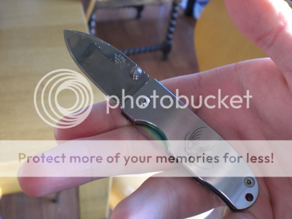

Sanrenmu 401
- Difficult to open and close one handed.

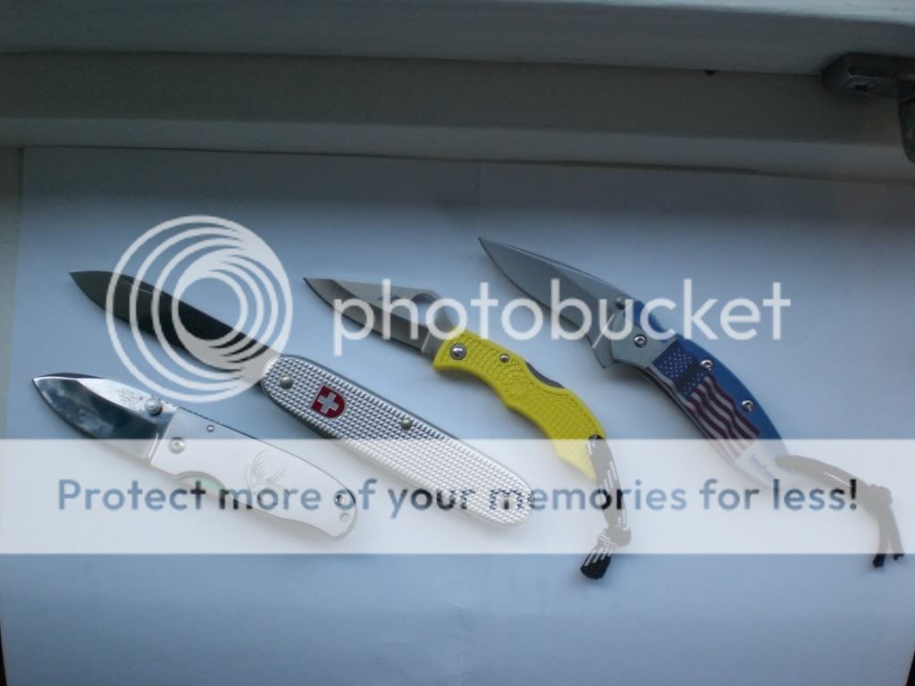

Compared with Vic soldier, spyderco ladybug, Kershaw chive
Wow, didn't realize the 401 was so small. Definitely puts it on the "want" list. Have you tried adding a lanyard for grip?

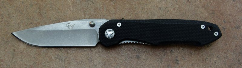

Picked up an Enlan EL-06 in late November because I liked the design of the knife and was curious about 9Cr13MoV steel (also used in some Benchmade / Heckler & Koch knives). It is a good looking knife (my picture doesn't do it justice), but the build quality leaves much to be desired compared to the other Enlan knives I've gotten.
First, there was significant horizontal blade play out of the box. It didn't quite wobble when I just shook the knife, but when cutting through some cardboard boxes, it was very noticeable. The only way I could get rid of the blade play was to tighten it to the point where I could no longer open or close the blade. Since that defeated the purpose of it being a folding knife, I settled on tightening it until the blade play wasn't any worse than my SOG or Spyderco knives. The trade-off is that the blade doesn't open nearly as smoothly. It can still be opened with a hard flick of the wrist, but you can definitely feel the tightness when closing the knife or doing a slower controlled opening with the thumbstud.
The second and potentially dangerous fault is the weak detent. Even with the pivot tightened quite a bit more than the factory adjustment, you can still shake the blade out of the handle. The detent ball appears to be intact and undamaged, but it just doesn't hold the blade closed very securely. Holding the handle and giving the knife a good shake will result in the blade popping open 1/2 to 3/4 of the way. Drops onto padded carpeted floor also resulted in the blade popping open pretty often (basically any time the knife landed in such a way that the blade could open).
Not everything is bad though. The stonewash on the blade looks nice, the factory edge is razor sharp, and the liner lock engages solidly. The G10 handles are well machined and fit to the rest of the knife. The pocket clip rides a bit higher than I would like (leaves ~1" of the knife handle exposed), but that's just personal preference.
Maybe I just got a lemon, but as it is, the EL-06 I got is unsafe as a folding pocket knife. Others' experiences might differ. I have a couple other Enlan knives and have been quite pleased with their build quality, so the problems with the EL-06 are disappointing. I am still curious about the steel, and I do like the aesthetics of the knife. At some point, I'll probably look at finding a sheath for it, and then just "lock" the blade open by tightening the pivot so it can no longer close (and resolve the blade play issue).

My EL-06 came with none of the issues mentioned above. The lock up is rock solid without any bladeplay and the detent keeps the blade in closed position too. What tool did you use to adjust that new pivot screw? Mine came with the previous "three dots" design.
@Vortex: I just used a small flathead screwdriver. I fit it in one of the three grooves in the pivot screw and turned it.
@Chris: Regarding the blade itself, it seems good so far. Even with its thickness (4mm), it did make easy and smooth cuts through cardboard. I used this knife to break down about a dozen shipping boxes (mostly single ply, but some two-ply) from various holiday purchases into small pieces. Basically, about 24 cuts per box (4 top flaps + 4 bottom flaps + 4 sides, and then cut each of those resulting pieces in half) for stuff the size of a USPS medium flat rate box (more on larger ones). The last cut was as smooth as the first, so there was not any significant dulling. I didn't try to shave hair with it, but it was still making smooth cuts (no frayed edges along the cut) through sheets of paper. These are far from being controlled tests, but it is representative of some real use cutting.
