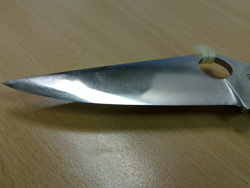

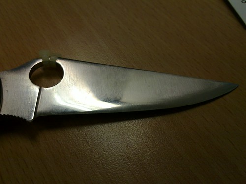

Trying to upload the convexed & thinned down k631 here

This is some serious sharpening. Very nicely done. How did you manage to do it? Looks very thin, can the steel support the thinness without chipping?

It took about 2 weeks or so because I only did that in spare time (after work, weekend), on 320, 400, 1000 grit stones, plus 1000 grit sandpaper and metal polish on non corrugated cardboard. Based on approx eyesight, 20-30 inclusive, so it's thin. Initially I only thinned down the bevel, but it turned out not symmetrical. Either the blade grind from factory or my hand cannot create the same angle for left & right side To hide that, I decided to fully convex it, following Murray Carter method. Found out the FFG is not really flat!
The edge holds up well for my daily use: pizza on the box, some bread on proper cutting board, instant coffee package, paper. So far, to keep it sharp I strop it daily on the same cardboard.
I haven't tried any wood carving, during which the lateral stress might chip the blade. The chip there is the result of dropping the knife on ceramic tile (textured, not smooth). From this incident, I think the edge will not chip on wood easily, the damage from dropping is not as bad as I expected.

Tested the edge on disposable chopstick (light wood), it degraded very fast. Some rolling & a bit of chipping could be seen with naked eyes under good lighting. So I took it to 1000 grit sandpaper, made few passes at 40 degree inclusive & some stropping, it came out still sharp enough to push cut newspaper but strong enough for the chopstick.

It's the soft wood chopstick. The micro is about 30-35 inclusive, and that's good enough for my use now. The edge will flex a bit when used on wood, but no chip. I think at 40 it will do great, but am too lazy to do right now. My daily use rarely need that ;)
