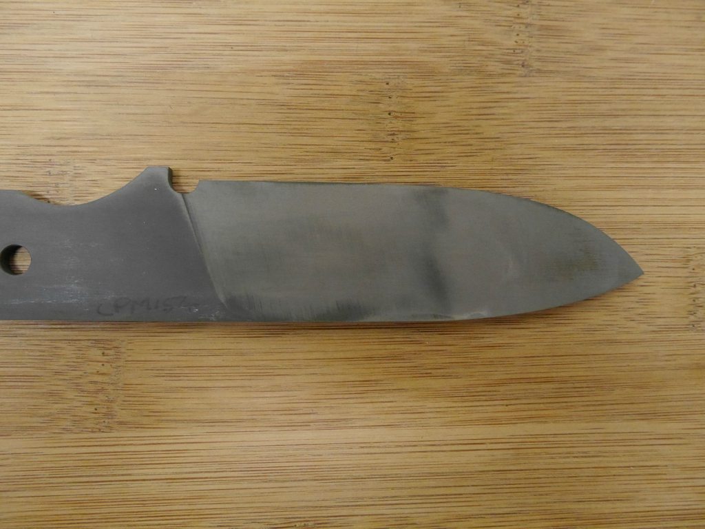

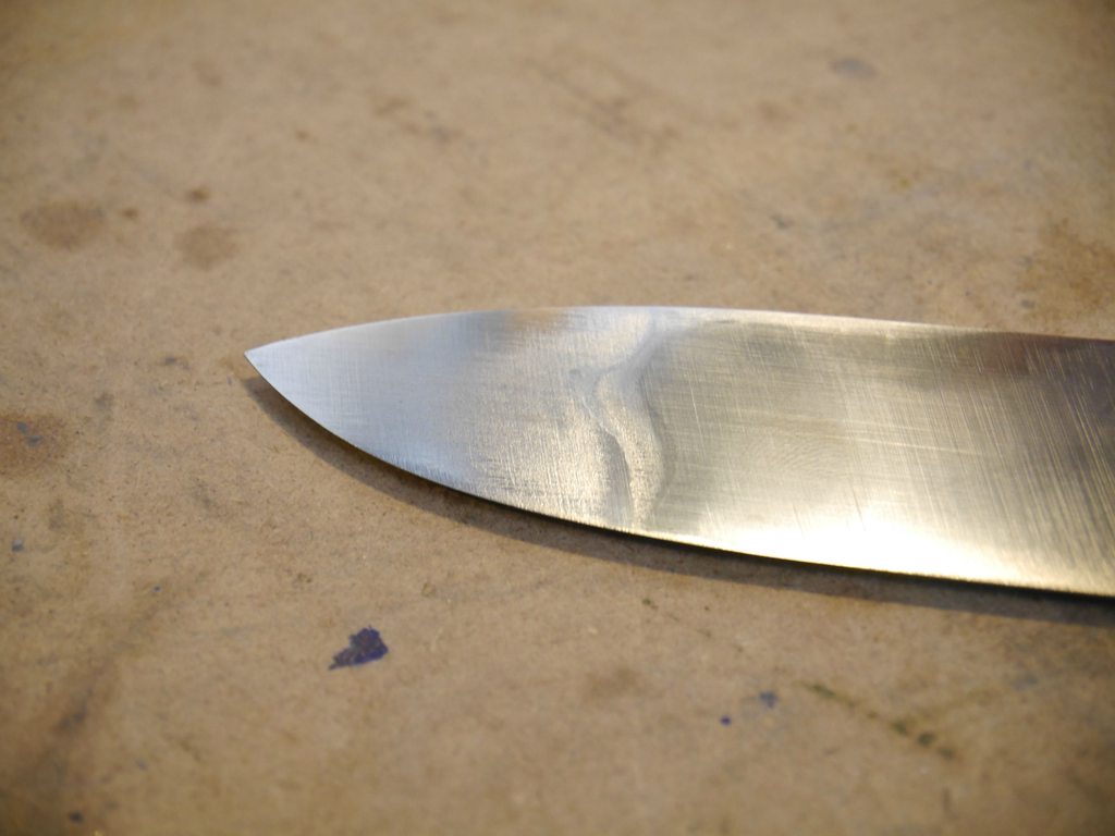

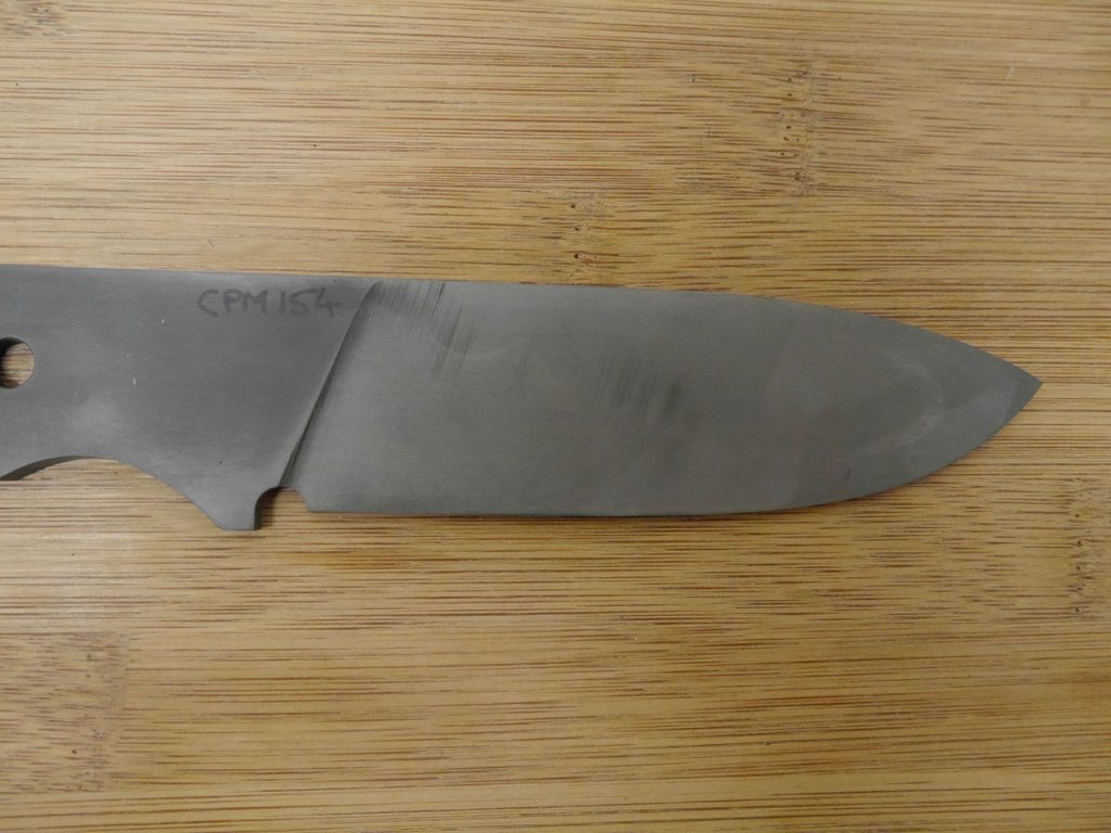

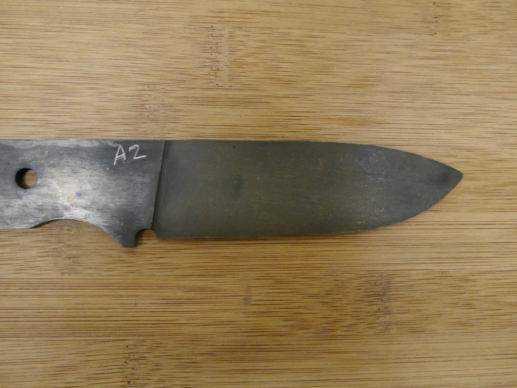

Ok! Well I found a minor issue after polishing the blades on a scotchbrite belt, it appears some of the blades suffered some slight decarb. The foil envelope for the CPM154 clearly had a tiny leak near the tip of the blade, and there was some noticeable decarb at the tip.
Here's what the CPM154 looked like after polishing, notice the speckly decarb in the middle of the photo.
The A2 blades both also had 'pinhole' spots of decarb spread evenly over the blade surface. The decarb seemed shallow, so to test this I sanded the blade surfaces back to see how long it would take before the physical symptoms of the decarb were no longer visible. It only took 1 piece (not sheet) of 150 grit, and 1 piece (not 1 sheet!) of 220 to sand off the visible decarb in all cases.
I then etched the blades for a few seconds in a strong solution of Ferric Chloride to see whether there were still decarburized areas. You can see the decarburized areas as lighter colored areas on the blades. The darker colored areas are sections where the steel is physically less smooth (finished to a lower grit), the dark lines are leftover grinder marks. I'm not finishing these blades to a high standard as they're only test blades...
CPM154 test blade after light etching, notice the crescent of lighter color indicating decarb near the tip.
Reverse side of CPM154, notice small lighter color section of decarb on the spine toward the tip.
A2 test blade after etching, notice small lighter colored speckles spread across the blade indicating small sections of decarb.
I seriously doubt that any of this decarb is deeper that a couple of thousandths of an inch, and I also doubt that it will cause a problem for any of the blades. If anyone believes otherwise though then they should definitely speak up now!
