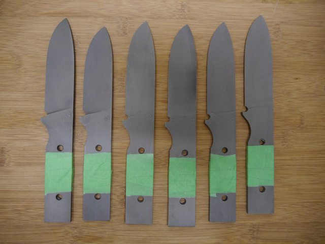

Ok, well all the blades are heat-treated. They've also been sand-blasted and had their identifying engravings covered so they're now indistinguishable from one another.
They blades were then honed along the edge until they were all equal thicknesses at the very edge before starting the testing.
First test, sharpening times! I got 4 of 6 blades sharpened up tonight, and the overall sharpening times have gone up significantly compared to the last test. So far the blades have all been closer to the 9 minute range than the 6 minute range I saw last time! I'll finish sharpening them up tomorrow...
Out of curiosity I tried my hardness testing files on the test blades before I sand-blasted them. I don't really hold much stock in the accuracy of those things, but it seems there is not a knife in this batch that is below 60HRC. Testing the first batch of blades yields much more bite from the files, but that may well be down to surface decarb. I'm getting all the blades hardness tested this friday, I'll be very interested to see the difference between the two batches!
EDIT: Here they are, test blades #7 thru #12:
Note that the O1 blade is shorter than the others, and therefore I know which one it is. Not ideal really but that blade was my last piece of O1 unfortunately.
