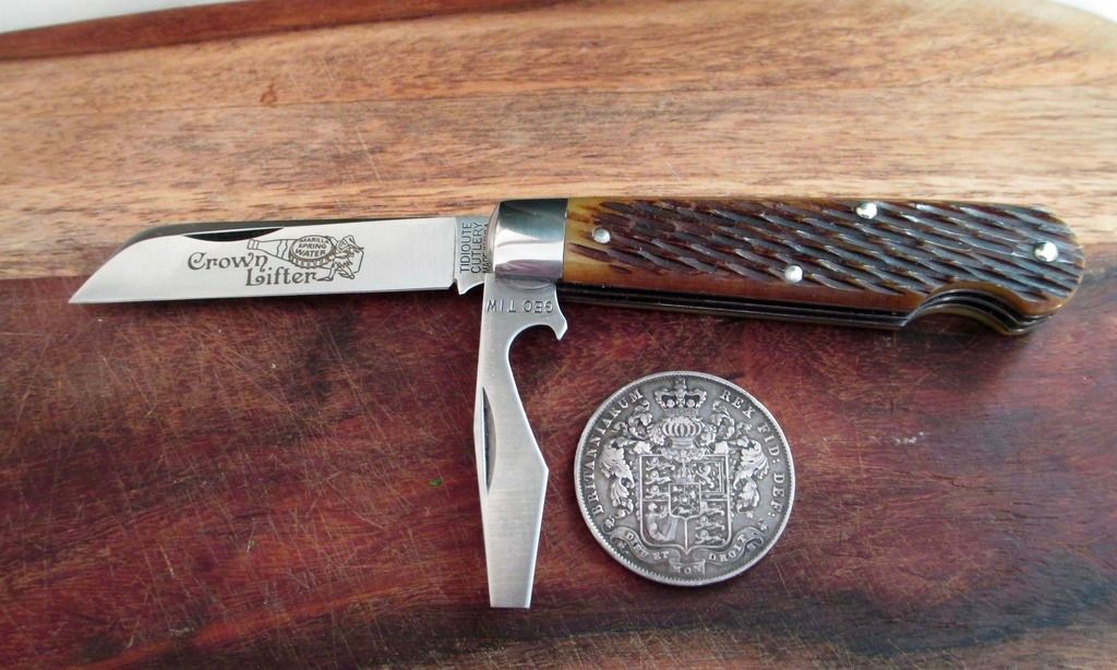

Some obviously don't mind it, but others like myself see this as an aesthetics issue that has bearing on quality. Aesthetics may be subjective, but they are at the core of Traditional knife ownership for me, the beauty and the delight in use of these knives is important. I can't see how having one deep ugly sink-hole pin on a knife where the others are flush or domed can be seen as anything else but a fault and an error in the manufacturing and assembly process. All knife companies offer knives with some sunk pin holes but GEC is the serial offender here by a long chalk. As has been pointed out, both CASE and Queen generally manage to avoid this yet their knives are usually cheaper by a noticeable degree, even more so does Böker Germany. As for the argument that one sink hole may indicate fat Stag slabs well I can't see the veracity of that either, I have a really horrible ghastly chunk of bloated CASE Stag but even that managed equal pin finish, its only redeeming factor!:eek::D
And as we've seen, GEC can and does manage an equal finish on pins, here's a recent example. Ask yourself, would this really look as good if it had one great empty sink-hole pin to attract dirt and muck?? I rather think not.

I didn't like sunk pins when I posted in this thread three years ago and I still don't like them. I think they detract from the aesthetics. The positive side is that sunk pins on GECs have saved me a lot of money. :D
