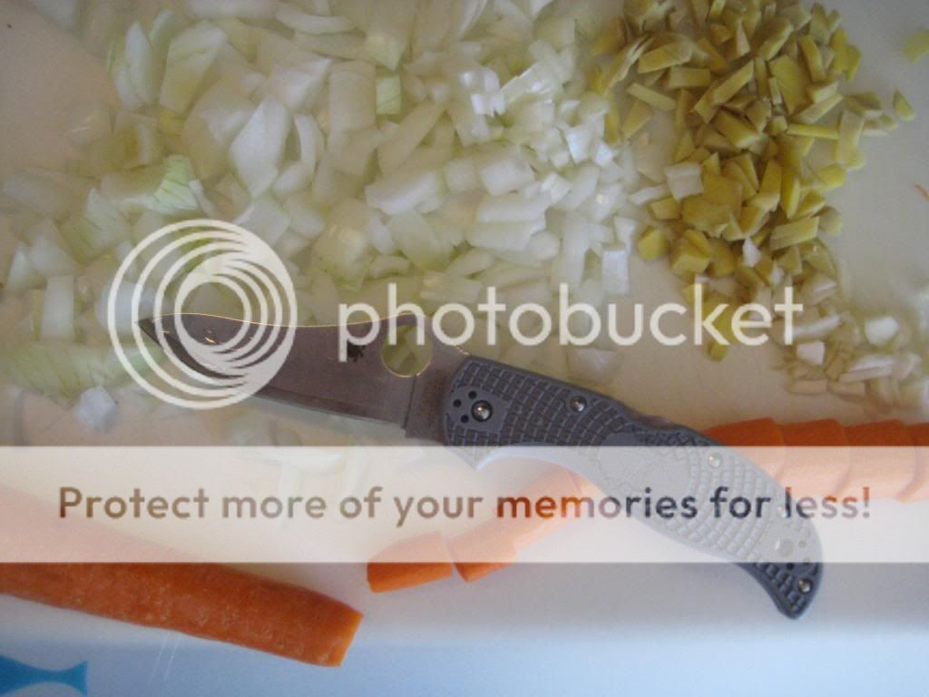

I'm loving this knife! :thumbup: It's great in the kitchen...
And it feels ready for outside duties as well. Something about is says "I'm tuff!!"...and can hang with my Military. Has great ergos- although the PPT is still #1 for me. If I go hunting this fall...this will be the folder in my pocket.
Really these 3 spydies and I'd be a happy man...
