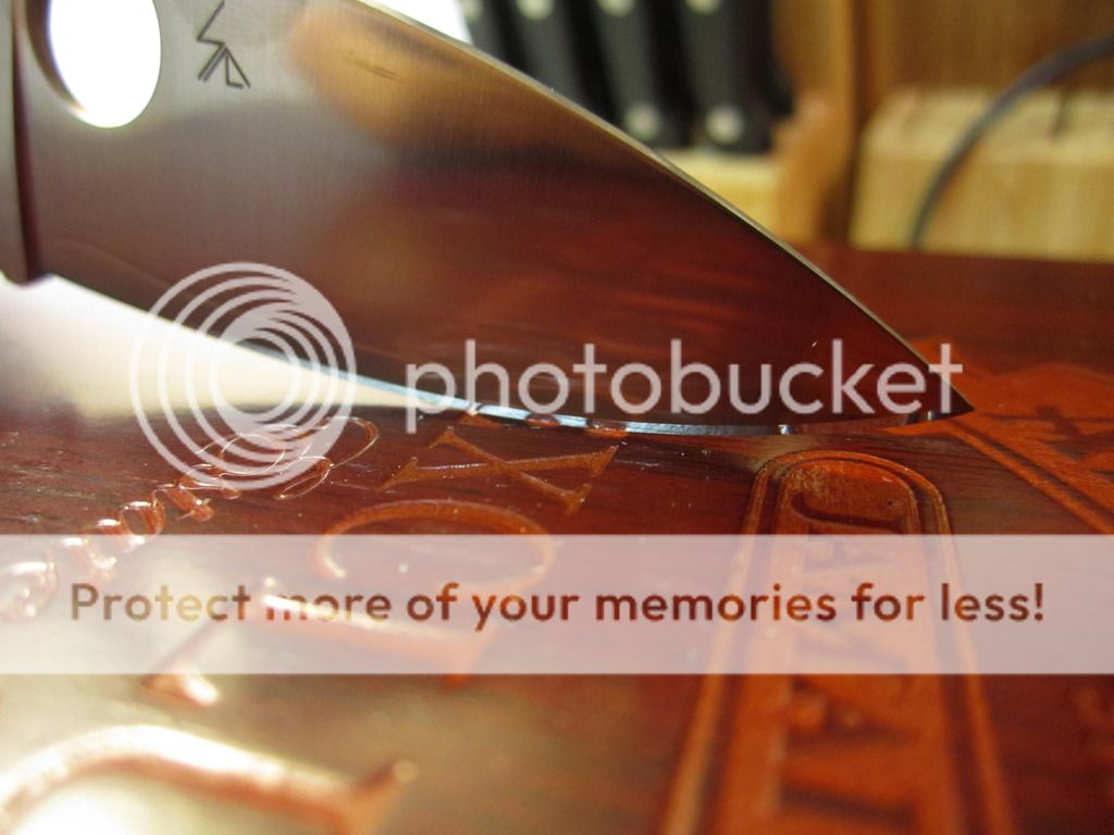

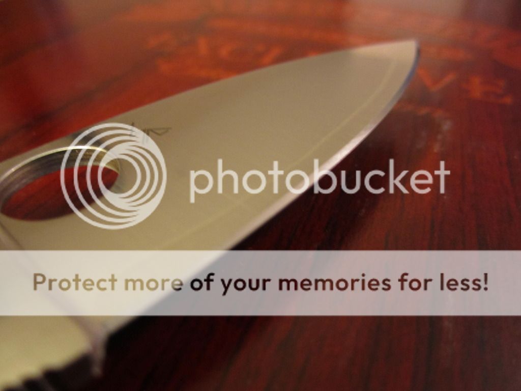

Super polished edges
Just finished these up the other day. Only reason the tip looks blurry in the first one is because camera wasn't focused...
Josh, those look great. I love the dead on consistent bevel widths.

Picked up this ZDP189/Carbon Fiber Caly 3 in Vancouver on our way home from our honeymoon, cause I felt naked without a knife. When I got home I gave it the full treatment.
Atoma 140
Shaptons 220 - 8k , skipped the 15k and straight onto the 30k. Came out brilliant. Skipped the 15k to prove that its the contaminated stone. I have been struggling with deep 10u scratches showing up randomly in my later stones and was having a hard time nailing it down. Last time I touched up my southfork I got really anal and started from scratch and used my microscope and alternating scratches to nail it down. Feel so much better now.
Re-profiled to a ~7.5dps edge bevel freehand with a Norton Crystolon coarse, edge bevel finished freehand with a Bester 1200 -> Suehiro Rika 5k -> Naniwa Junpaku 8k -> Naniwa Specialty Stone 10,000 and apex micro-bevel was then applied with Spyderco Sharpmaker F rods.

Progression went as follows
Atoma Plates 140 , 400 , 600 , 1200
Shapton Pro Stones 220 , 1k , 1500 , 2k
Shapton Pro Stones enhanced with CBN 5k , 8k , 15k , 30k
Stropped with Nanocloth and Polycrystalline Diamond , 0.25u and 0.1u
Or something similar anyways. I may swap out for a Nubatama stone from time to time , or on simpler steels omit the CBN and Atoma Plates. Its always slighty different. Sometimes even adding 0.05u , 0.025u and 0.015u Poly Diamond

Thanks, hilariously it doesn't even really take that long to do. Less than 50 pps on the Bester and about 200 pps on the 3 other stones will get you the above.
It's certainly not the perfect mirror you can get on guided systems with many step progressions, but its only 1 more stone than I would use anyway on my EDC knives so what the heck. The push cutting ability you get is just silly.
