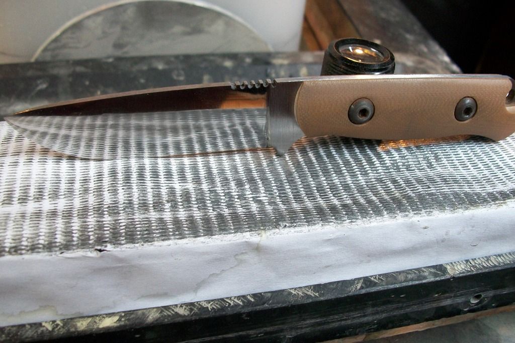

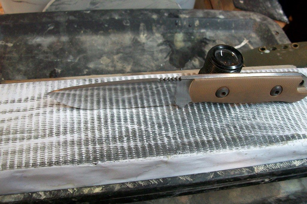

Here's one I finally got around to finishing. Bark River Bravo Necker 2 Sandvic 12c27. Was nice enough out of the box but I always wanted to finish it off a little nicer, run the convex the full height of the blade and correct some of the geometry. Is one of my favorite EDU and all time favorite camping little knife backup to my hatchet. Removed all the blacking and plan on adding colored spacers at some point.
Have been tinkering with a guided widget for my grinder that allows for good accuracy on curves as well as flats and I had some new Blaze belts on hand, so the Necker got the nod to finish. Is not quite as fine a polish as it looks from the pics, still has a slight haze but all in all turned out very nice. Grind goes from 0° at the spine to 13° at the edge.

I've owned this knife for years, AFAIK they only made the Necker 2 for a little while - is the best HT in this steel of the examples I own and a great all around size. Original grinds were good, but a slight recurve at the plunge line and side to side not even. Is easy enough to fudge and get it looking good cosmetically but I've slowly been correcting and thinning by hand for years and always wanted to take it a bit further.
Finally decided to just do a full job on it starting at 60 grit and finishing with my Washboard compound on leather belt (why it isn't quite mirror). Since I've been tinkering with a couple of homemade guides for my powered gear, this was a great opportunity to try them out. This took a few - lots of respect for you and others who do this sort of thing first rate and on a regular.

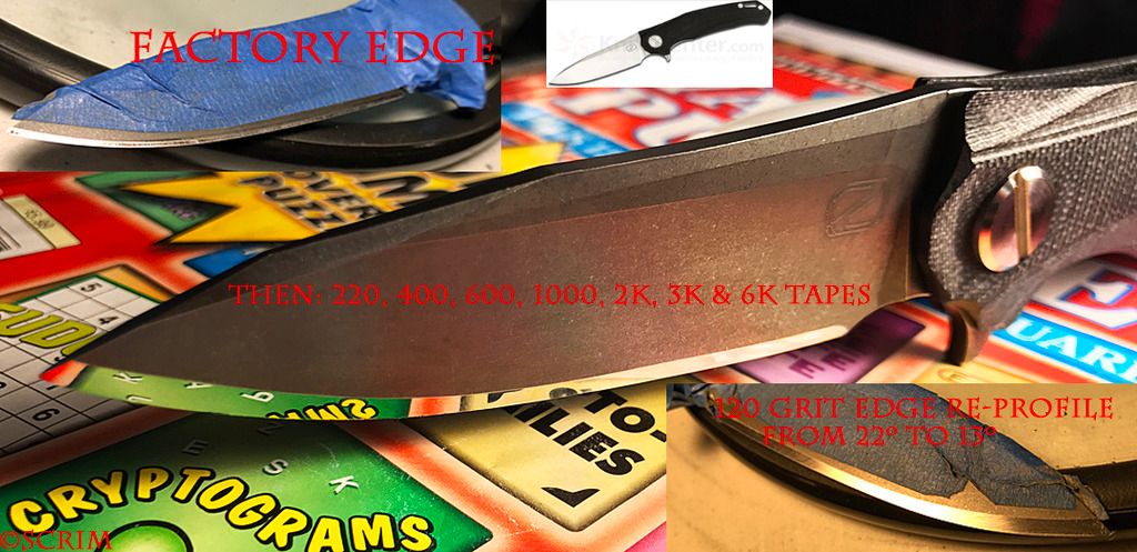

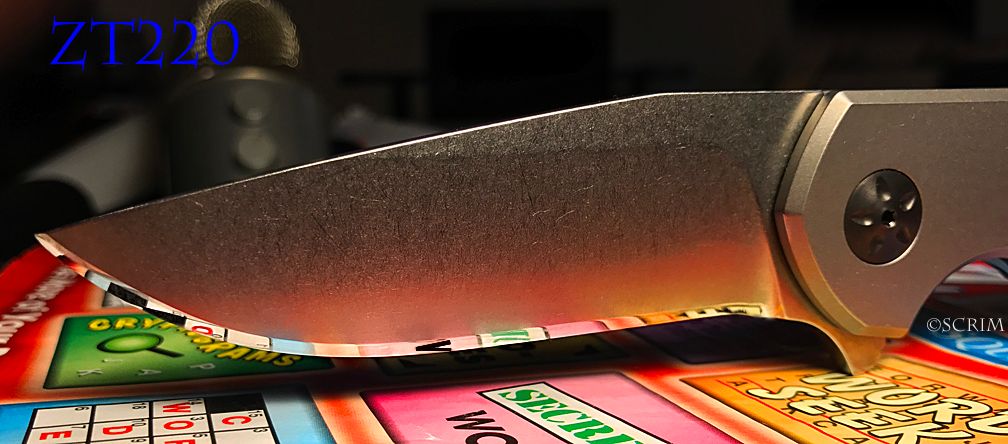

It all depends on the size of the blade and if I'm going to reprofile the secondary or keep the factory angle. Steel types, too. I've put a nice mirror edge on a ZT0450 (at the factory angle) in about half an hour...or like with the Stedemon ZKC D01 (earlier on this page), a four inch blade that I reprofiled from 22º down to 13º (an Edge Pro Apex experiment for me going that acute). That one took a while, plus I decided to be really meticulous, so that one took about 2.5 hours. The ZT220 I did today, and reprofiled the secondary down to 15º, took about 90 min. No sharpening choil so it took longer as I had to be really careful on each step near the end of the secondary (at the plunge)...where they should have put a choil. Well, at least it would have been nice of ZT if they had. To me, the only major flaw of a near perfect knife design.
