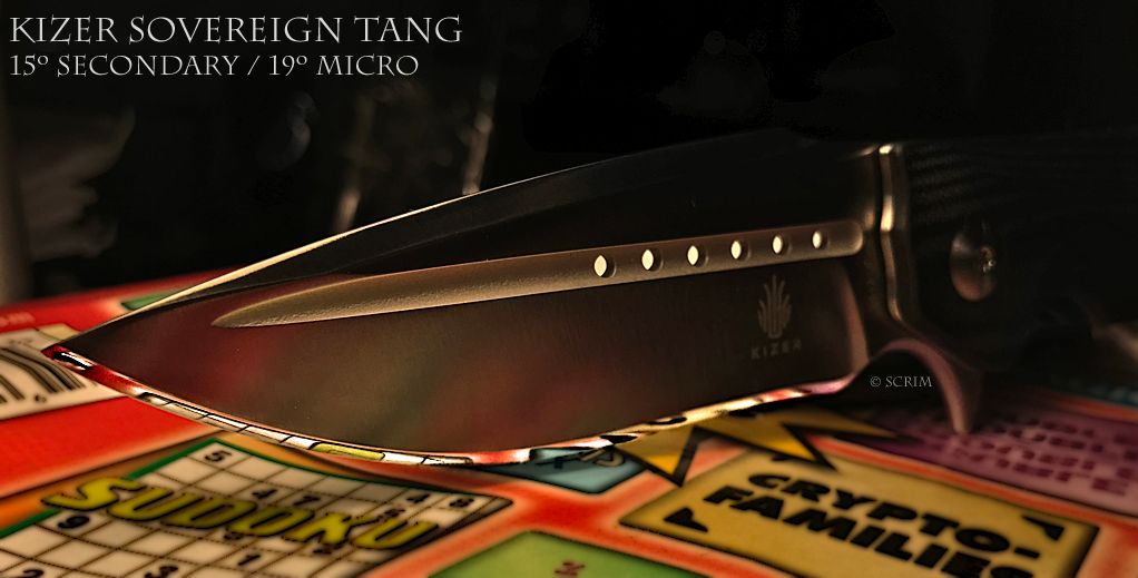

https://m.flickr.com/#/photos/131179900@N04/31683256581/
I don't find the Chosera stones to really polish... even the 10K... so I don't think your results are surprising. The results you're getting seems consistent with EdgePro's Grit Chart... (their 1K EP stone is around an 8K Shapton).
Sent from my SM-G935V using Tapatalk
Your edges make me totally envious, Bobby lol Always awesome, perfect polished mirrors & edge geometry
