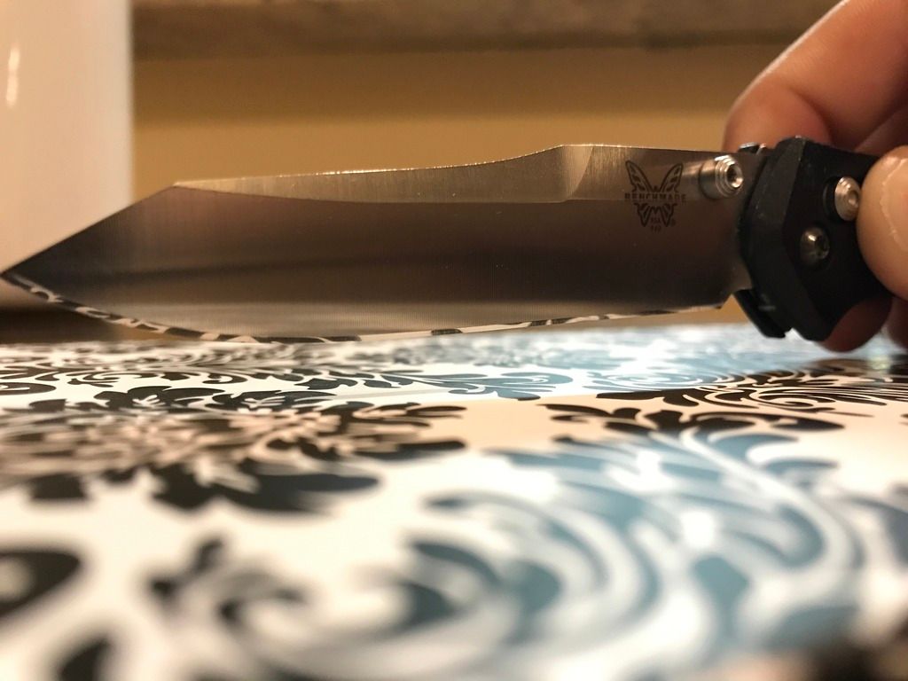

Thanks, Halden. On this one I just replicated the factory angle. Just covered the factory secondary with black marker, matched it & went to town. I'm guessing it's roughly 21º. Then I bumped up 3º and put a "whafer thin" micro on it. Since I didn't reprofile this one way down, like I usually do, it was much quicker. The whole thing probably took about 45 min., starting at 400 grit instead of my usual 120.Great pic! What angle did you use on this one?
Thanks, Halden. On this one I just replicated the factory angle. Just covered the factory secondary with black marker, matched it & went to town. I'm guessing its roughly 21º. Then I bumped up 3º and put a "whafer thin" micro on it.

That's purty! What angle was it at before?
Thanks, jbarsquat. I didn't measure its original/factory angle but I would say it was right around 22º.That's purty! What angle was it at before?
