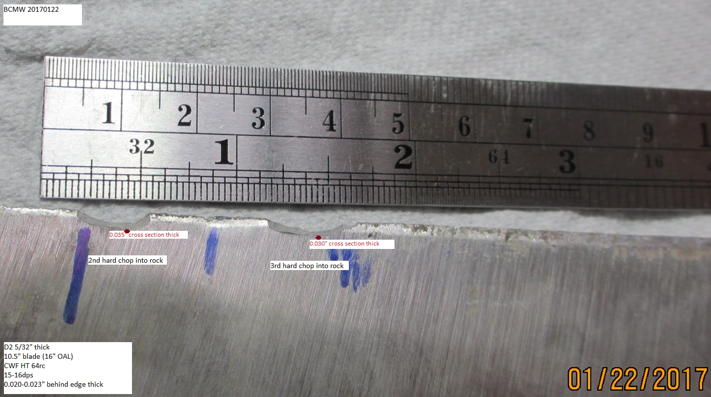

I've a test D2 light chopper 5/32" thick, 10.5" blade (16" OAL). It has been tested with initial hrc at 66, gradual thinning down and softened. It is now at 64rc with edge geometry 0.02-0.023" behind edge thick, 15-16 dps (edge still has a few dings). If you like to see what D2 can do, I am willing to shoot a short video - lmk. e.g. chop oak; katalox; african blackwood using a rock as backing (silly accident will happen to the edge). Keep in mind, chop usually impart higher lateral load than tap/baton through hard materials, such as brick; cinder block; etc...
Point being - with good ht even D2 at 64rc is strong & plenty tough for impact usage.

If/when doubts - I wouldn't settle for either knife (D2 or laminated 64rc carbon), since there are better option out there.
I just made this video for you - BCMW 64rc D2 chopper against a rock... Please keep in mind this chopper edge geometry is fairly thin:
[video=youtube_share;ik9fM1UluVk]http://youtu.be/ik9fM1UluVk[/video]
Edge afterward:
edit to add: as for better option, look into proven steels (with similar carbide volume) such as cpm m4, vanadis4e. My 64rc M4 chopper is way tougher this 64rc D2 -http://www.bladeforums.com/forums/showthread.php/1409721-Heat-Treatment-Crystal-Weaving-Foundation?p=16817665#post16817665

I think the video primarily shows is how well D2 can perform with a very good custom heat treat, but even then it's hard to understand why you would choose it for a large blade where toughness is desired over something that would perform even better given the same level of attention.
Cost is one potential factor, but the Wander isn't an inexpensive knife. At that price point, you should be able to get pretty much whatever you want. Not to even say it's a bad knife, I just don't know as I know nothing about the company. On the other two, just personal preference, but I wouldn't pay that kind on money for a blade with a basic looking paracord-wrap handle and I would have the same concerns about using them for impact work as I do with D2.
