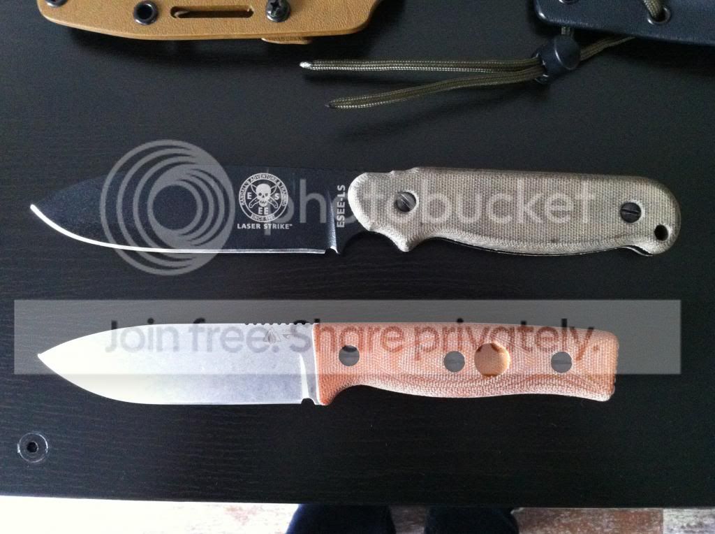

Haven't read all 17 pages of the thread but I came to ask how the Micarta reacts to being handled? I read the GSO handles are clear-coated so they retain their original color and won't turn a darker, dull, solid color like the ESEE Micarta when handled.
I had NOT read anything about the GSO micarta handles being "clear-coated", would be a pretty silly endeavor to 'beautify' the handle of a user while detracting from its actual utility! BRKT is one of the few companies that clear-coat and it is another reason I do not buy from them.
Regarding Survive! handles, there are images of stained GSO-4.1 scales. I hope the stain is holding up because micarta, being resin-based, is quite resistant to permanent staining beyond the thin layer of loose fabric at the surface. My Survive! knives have had oil, sweat, blood, etc. soaked in and washed/dried out later so the scales look the same as the day I bought them. If your handle darkens from sweat/blood/etc. just scrub it a bit with dishsoap and a nylon brush, dry, scrub remaining spots with alcohol, dry. Done.

I coloured my handle with black RIT-Dye. Came out fine! Its now almost a year later and I see no changes in colour.
I washed the knive multiple times and Still looks the same.
Here are a few pics:
After RIT Dye:

That's good to know. I have natural canvas as well and I'm thinking about trying red Rit dye on them.

:thumbup::thumbup: Thanks for the update. Unique and wicked :cool::thumbup:
I've dyed several. Make sure you clean those scales very well with hot soapy water. Dish soap works best wit ha nylon scrub brush. Rinse VERY well and let dry completely being careful not to handle them with bare hands after cleaning.
Any oils from your hands left in the fabric of the micarta will dye differently and not take the dye as well. You don't want to end up with splotchy scales.
