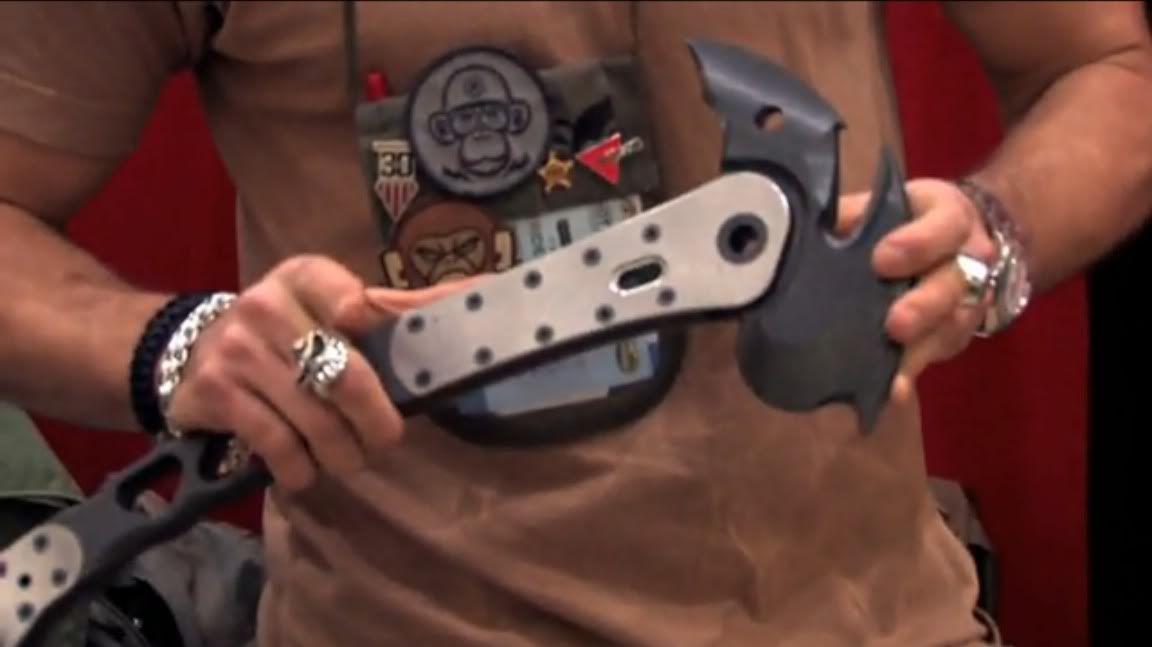

Id would go to this giant can opener from Winkler Knives
The RMJ hawks are also a good choice.
Jeff Hall over at Nemesis Knives has a Hawk design that has a bolt on head. It can move 90 degrees.
I've wondered about the strength of that design, the blade is S7 and the handle is aluminum, I think.
I'd feel safer using a full tang or tapered tang.
I've never seen that can opener, Edwood - I believe that's the first time I've ever seen it referenced anywhere, either. Would you happen to know of any videos of it's use? I've seen that Strider proto in use, and it's frighteningly effective.
I've always been a fan of Winkler's hawks, but have never had the opportunity to see one in person, or any knife/axe with a tapered tang for that matter. Their military discount significantly helps, but I would still like the opportunity to hold one before laying down the cash.
Thanks for posting - your posts are always informative.

Hear is some info on that extraction tool
“This axe was developed for a military rescue/extraction team to meet their need for a tool that can be used when power tools either fail or are unavailable.Its purpose is to remove survivors, casualties and sensitive equipment from crashed aircraft and ground vehicles. Designed for cutting metal, the blade will not hang in sheet metal. The tapered tang enhances power in a stroke and distributes the majority of the weight to the head making it possible to cut or break through cross beams. The axe features a point on the back of the head that serves a "glass breaker", as well as a hole punch for creating an entry point for the "can opener" on the end of the handle. The rubber handle provides a secure grip in wet or dry conditions, as well as excellent shock-absorption. Functioning as a portable "Jaws of Life" this extraction tool has proven its effectiveness to law enforcement, first responders and rescue workers, as well as to the team for which it was designed. Price includes a felt lined, Kydex Carrier with rubber belt hanger. Optional molle clip carry system is available. Cost: $675.00”
Daniel Winkler even got an award for this axe design.
2009 MOST INNOVATIVE DESIGN Blade Show, Atlanta, GA- This tool was orignally designed for a rescue extraction team and is now used by military, law enforcement and first responders throughout this Country and abroad.

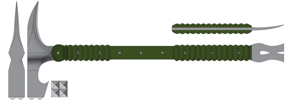

Sorry it took me so long to get this up but its been a busy week for me.
Anyways here is an initial design/concept for my Tac Hammer.
-Overall length is 24"/61cm
-Full .25"/6.35mm thick tang
-The head has 4 pyramid shaped points coming off of it. This is something that medieval warhammers had as well the purpose being that they focus the impact into those points generating an greater force at those points.
-The back spike is sharped on the underside the curve will hep in cutting cord, rope, and webbing, & for pull cuts (pierce wall and tilt handle up and pull.)
-The hook at the bottom of the hammer end can be hooking and binding a combatant, dragging, & so forth. The undercut of the hook also will aid in putting more weight forward on the hammer's striking head.
-Handle material would wither be Micarta or G10. The scallops on the handle material would also be on the tang of the hammer providing two good secure gripping points.
-The bottom of the handle has a prybar end to further it's possible functionality in entry situations.
Let me know what you guys think.

I like it.
That’s a great designee. Is that hole on the end of the handle a lanyard hole?
Is a there a reason for the gap in the middle of the handle?
I have found that having a lanyard on a breeching axe is a very essential thing; it gives you grater confidence when doing hard chopping, especially when your team is stacked behind you. No fear of it flying out of your hands.
Love the designee on that thing, especially the pyramids on the hammer.
