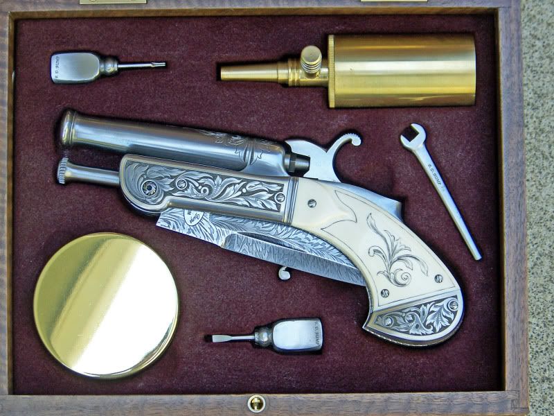

On the other hand, when I see one of Bruce Bump's minicannon-folders, my mind starts wandering way to the side of "way cool".

btw.: imagine, bruce used epoxy instead of screws for his knife-guns... :barf: i am a watchmaker, we use the term "chemical screwing" to obscure a technique that is not really state of the art in traditional mechanics.
