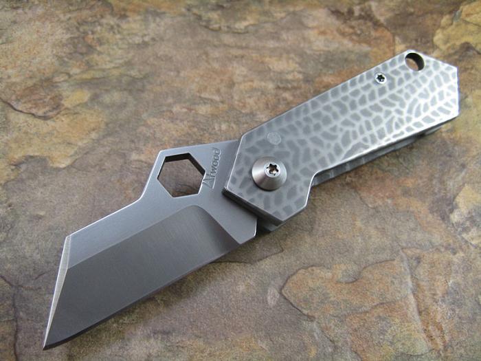

I'm getting a Mod Mark 1. In theory the larger shear component then the stronger it is in resisting closing forces. I'll have a look at it in future.
http://www.atwoodknives.com/home/19472383.php
Thanks t00k a l00k its a thick little 0ne.
It is. :) As I said, he likes playing with things and coming up with new runs. Not sure he'd take a custom order. But it couldn't hurt to ask. :)
FWIW, Atwood does do 3V work.
I went back through Farid's website and looked up a few dealers. He seems to be concentrating on those Lile fixed blades. I don't know much about his folders or their availabilty these days. :(
