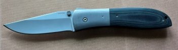

Some anodizing today. I sanded the black off of the Ti Salt clip and anodized it purple, plus bought some Ti Delica hardware and did the same. Not all of the Delica hardware is compatible with the Salt, so the remainder was sanded and flame bronzed. While I had the equipment out and bath ready, I went ahead and made the light blue Ti washers on this little fixed blade purple too, and flame bronzed the screws as well.
