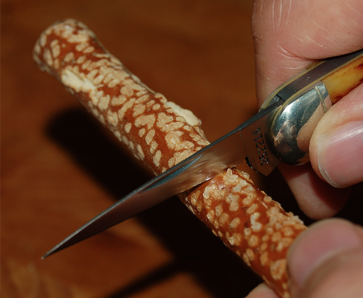

Scraping the excess salt off a pretzel with the punch:

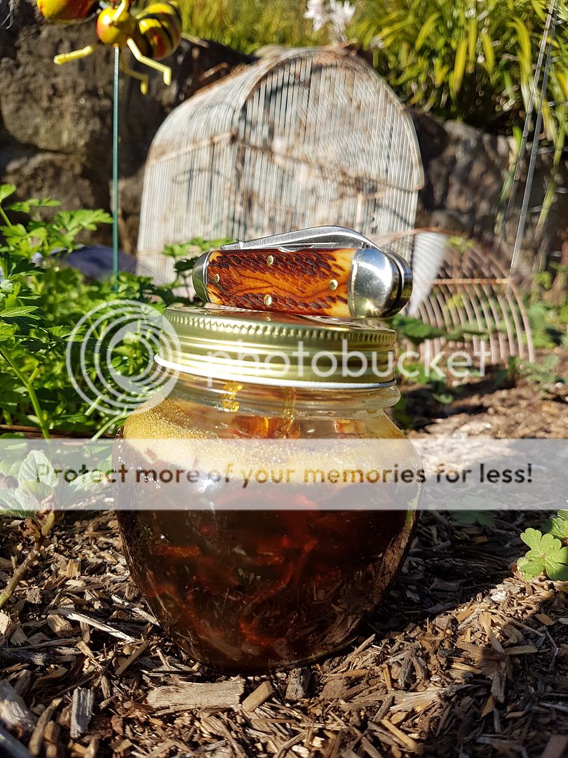

Mine was waiting for me when I got home from working and I have to say I HATE IT !
Burnt Orange indeed .
It looks nothing like burnt orange.
Here's a pic of the knife on top of a jar of my home made marmalade that got over cooked and as you can see it looks nothing like the same colour.
Reckon I got a couple of nibbles there:D

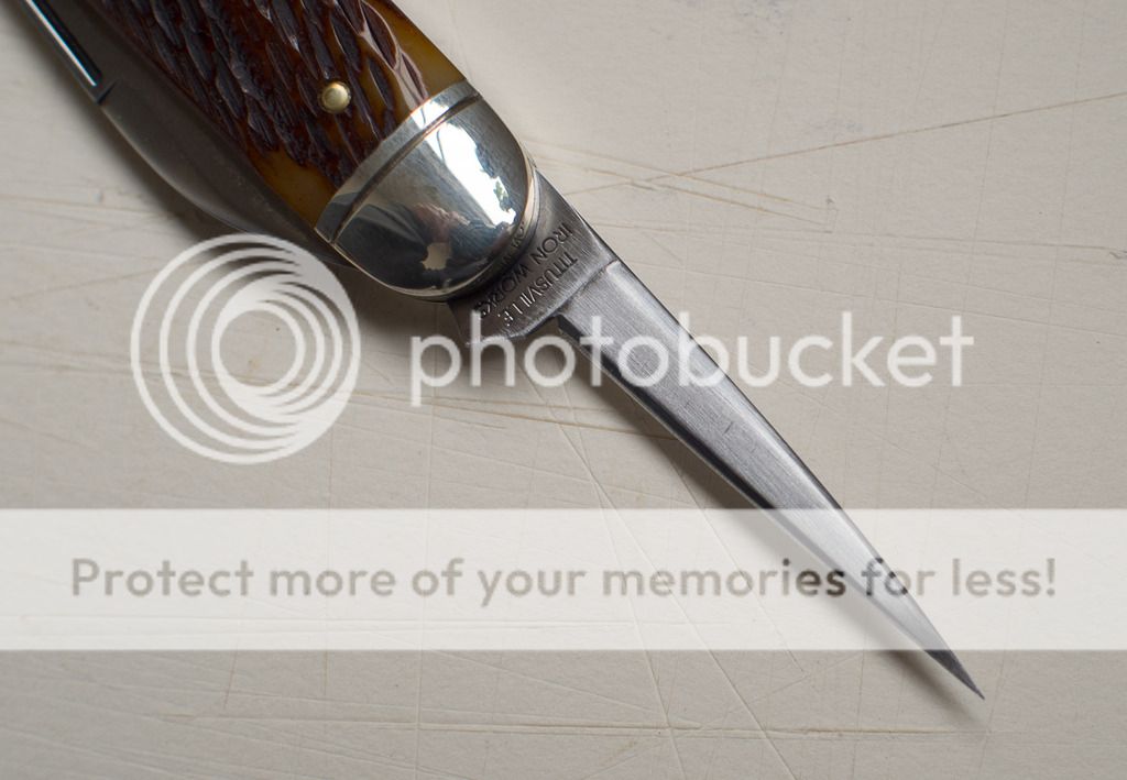

Well, I fixed mine. Originally, I couldn't open the punch with my fingernail unless the blade was open. After Charlie's explanation about the swedges and the remedy Bill came up with, I decided to grind down the punch myself using stones. I started with medium stones but finally moved to DMT coarse. Then I used sandpaper to give a satin finish. Now the punch works great; I can easily open it with my fingernail. It's not as pretty, but I'm very pleased.

Glad it worked out for you. If it's a user, looks great as is. But a couple minutes on a buffing wheel, and I doubt anyone but you would even know it's not a factory finish.
I'm no mechanic or anything, but I do love it when I have the opportunity to tweak a knife and make it "my own".

hanks, bflying. I don't have a buffing wheel, but I'll put the strop to it

Great job [emoji106]. Try putting it on a strop to get that shine back...if it matters. The satin looks nice though
Nice job of fixing it yourself! I too love adding a personal touch to my knives, especially if it solves a problem!
