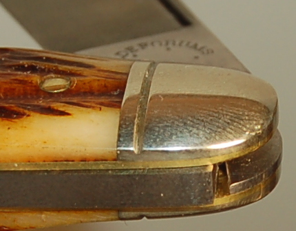

Here is a pic of pile sides of each variation. Note the wide swedge on the back of the Spear main blade.
Because the Spear is so wide (cutting edge - to - spine) it needs the swedge to thin the bulk, to allow the punch to pass. This is standard cutlery procedure. If you look down on the spine of the Spear you will see that the grind is off center; again, that is to allow the punch to pass. (No pic of that).

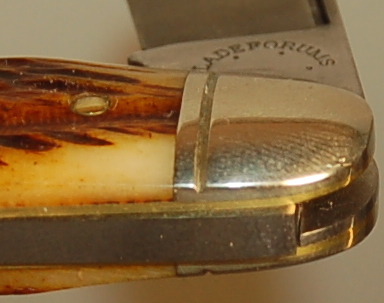

Here are the Mark sides.
If you look at the tang on the punch you will note a little easement bevel running into the shallow plunge cut. This, again, it to aid the punch to pass that wide spear blade.
Finally the nicely-ground punch has a near full length long flat triangle formed by the two bevel cuts on the back, same side as the easement bevel. The side bevel cut is critical to pushing the punch around , in order to make a circular cut, to cut a hole!!
