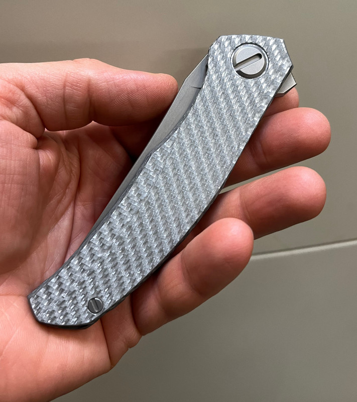

Anyway, I've acquired my first Quant_i_um to wash away the bitterness of the recent lottery. Not nearly as desirable as Russian Lochsa, but rare and suitable for EDC 🙃 And not as boring as a common Ursus G10/Cromax version.
AFAIK there was only a single batch of top-tier Quantiums made about a year ago for a knife show in Moscow:
-- 3.4 mm S90V blade ground down very close to the pivot
-- Alutex presentation scale
-- Ti backspacer
-- skeletonized lock-scale, fully stonewashed (thank God, without inlay or "chaotic" satin)
-- MRBS
-- 112 g (3.95 oz) -- almost as lightweight as Hati Gen 3, which is inlaid
P.S. I've just noticed, the blade is "sterile" -- the ShiroBear logo is stamped on the inner side of the backspacer instead.
Not sure if the pocket clip and backspace are anodized, seems like a combination of beadblast & stonewash:

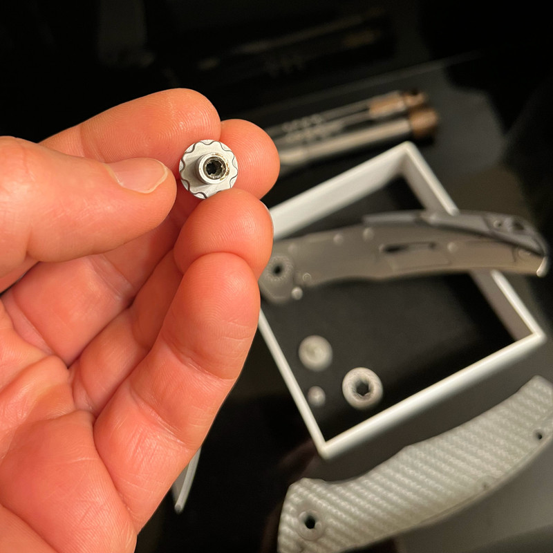

Еspecially after taking the knife apart for a thorough inspection / cleaning and finding out, that it has a Captive Pivot System implemented both for the pivot screw and for the rear one!
Technologically speaking it's more advanced than the latest Hati Gen 3. On the other hand, Hati has 21 balls per side, not 18. But I seriously doubt that 3 extra balls make any practical difference.
Thanks to CPS I was able to disassemble the pivot with some reasonable efforts — had to use a more powerful gadget than a fancy Shiro tool though. There was unhealthy amount of thread-locker and some traces of corrosion inside the pivot😭
Surprisingly the bearings were almost clean, I suspect the previous owner washed out the black gunk without taking the knife apart. It would explain a tiny bit of side-to-side play (with lock-bar disengaged) I noticed before accepting the deal.
Now the knife is perfectly tuned and ready for EDC. I used PTFE 0.075 mm tape instead of thread-locker.

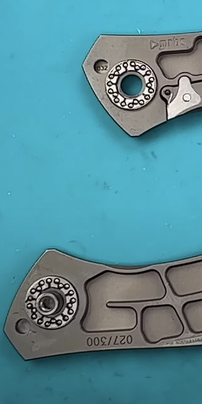

A very attractive folder. I wonder though, why do they tend to install MRBS into Sinkevich models and not SRRBS pretty common for other collabs and CDs.
Sinkevich himself uses MRBS in his customs still, doesn't he? I'd imagine that's why/part of it. I believe the Sinkevich collabs specifically use the Sinkevich design/pattern of MRBS. James - mikomonday mikomonday - has posted the different MRBS layouts before though I cant recall where and am now struggling to find the picture.
Thank you, Pompous Pompous !
I've just found the video "How to Maintain and disassemble Shirogorov Bio" — you're right, the 'Mickey Mouse' pattern (20 balls per side) is easily distinguishable from the standard "spiral" MRBS:
